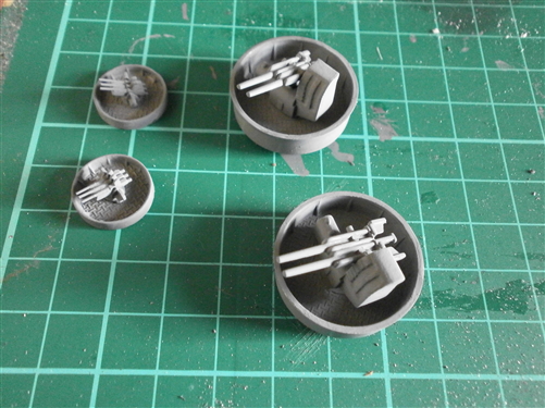

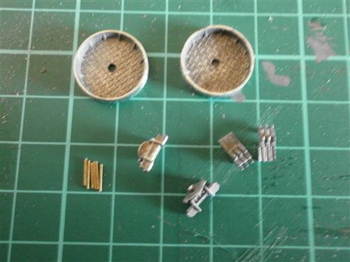

a few pics of the anti aircraft /machine guns made up as an example, i wont be building more untill its time to permamently fix them in place.As usual all comments are welcome
#145 Posted : 20 March 2012 18:11:49
Coming on well Andy, don't forget to tip the ends of the gun barrels black.

BigGrin I had already painted them just forgot to post the pic Mr TLOL

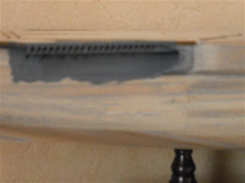

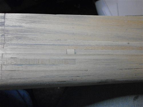

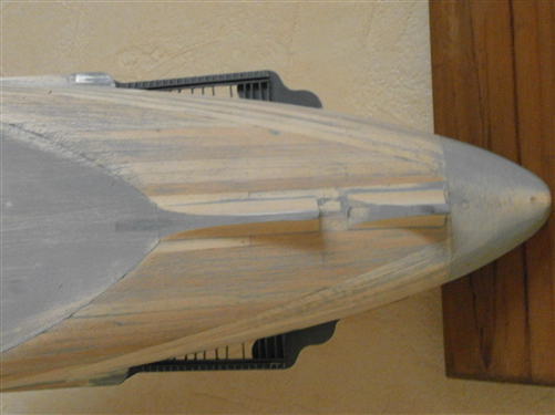

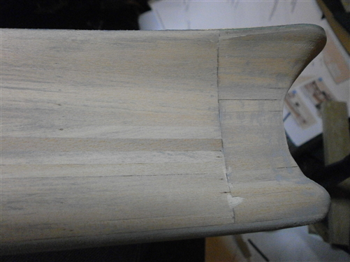

a few more pics of the hull,i proceaded to spray the whole hull with grey carspray undercoat then sanded it all off.This has highlighted any areas that still need some work/filler adding,esentially theses areas are around the bow and stern and look alot worse than they are in the pics belowBlink,there are no gaps in the planking now although it looks like there is in places unless someone spots somthing iv missedLOL .As ussual all comments are welcome

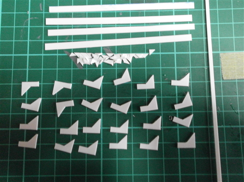

A little more progress on the Yamato,i decided not to use the ply/wood strip components supplied for the boat cranes the reason being that to me they were just too out of scale and instead made replacments out of plastic card.I then proceaded to add the rails and outer fillets before glueing the deck on the hull.The inner fillets will be added when the deck is dry[more pics to follow].As ussual all comments are welcome

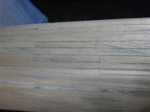

Drool thats some very smooth lookin' planking AndyDrool
Cool you must be chuffed with the resultDrool
#152 Posted : 31 March 2012 22:08:28
BigGrin Thanks Budgie, yes im quite pleased with the planking if you look closely you can see where i used a smidgen of filler in places[the green filler]but overall prety good as i havent done any planking in 10 or more years plus the one obvious mistakeBlink

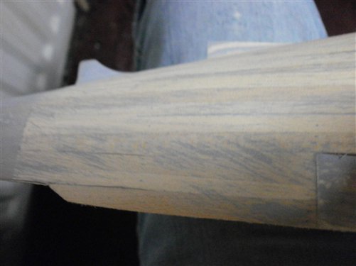

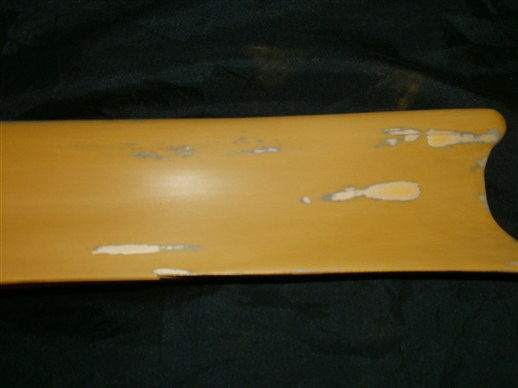

there will be quite a few pics with this post,as previously posted iv sprayed the hull with primer and sanded it all off to profile the hull then 2/3 coats of sanding sealer was applied before a light sanding.
I then coated the hull in grey undercoat again and then on top used a yellow colour spray putty[as you sand back the putty the grey acts as an indicator your getting close to wood],the putty was built up with several thin coats every 15 minites or so untill i was satisfied i had a good even coverage.Now comes the hard work to get a good smooth finish, i used a 120 grit sand paper on the entire hull 1st, making sure any blemishes were removed [ in the pics you will see that the grey paint/wood in parts is showing].
After i was happy with the first sanding i then proceaded with the second sanding using a 320 grit super fine paper to give a finish smother than a babys bottomLOL and last of all a light coat of grey Kure grey.As ussual all comments questions are welcome
