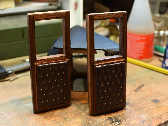

#146 Posted : 01 September 2019 10:06:17
Update:
Inside of doors now finished more soon.

Those doors look really great.
#148 Posted : 01 September 2019 11:09:29
BigGrin Superb work Trev Cool
Martyn

Thanks Roy for looking in
Trev

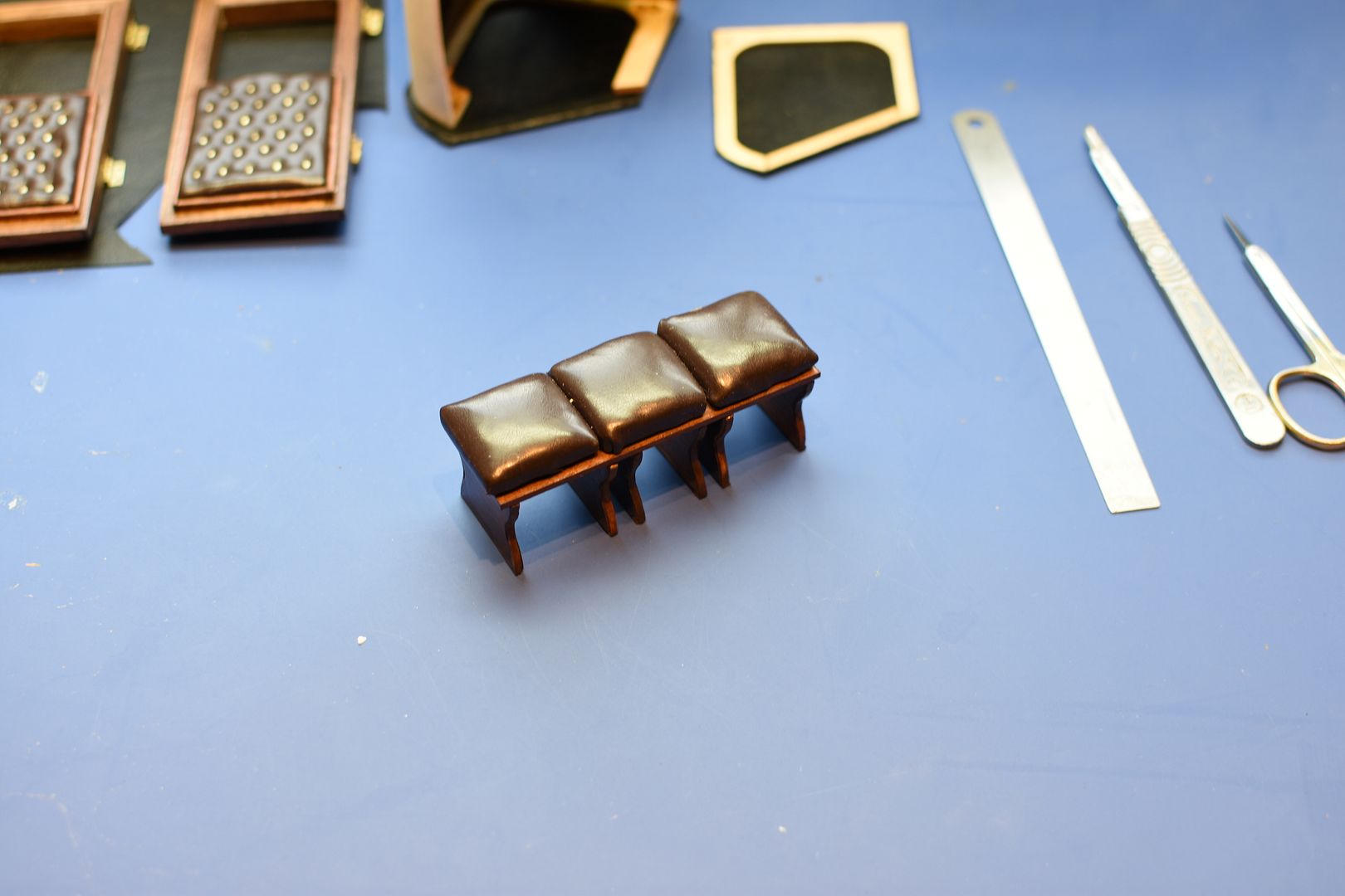

#155 Posted : 22 September 2019 18:25:22
UPDATE: Making and Fitting interior Bench.
First picture show's parts needed to build the bench you need 6 support feet to fit to the base,which have to covered the edge with 0.6 x 2mm.
Next cover foot base with 0.6x30 top and bottom,then line the edges with 0.6x2mm wood vernier sand with fine paper and french polish.
To make the foot rest cut three small square pieces of wood,then glue sponge to make a pad cover and upholster to match interior doors
More Soon
Regards Trev.
