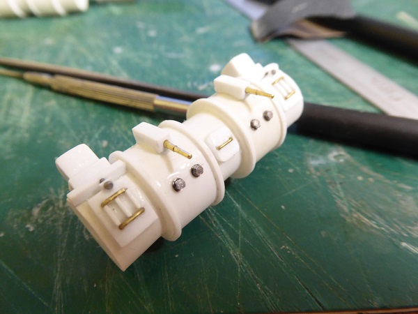

So this week has seen me add more detail to the main motors.
The attached photo shows the manual cranking handles fitted. I'm not entirely sure, but i believe these were turned with a spanner while the inspection covers were opened, for maintenance.
They were made from 1.0mm OD, 0.8mm ID brass tube with a small length of 0.8mm diameter brass rod inserted into each section.

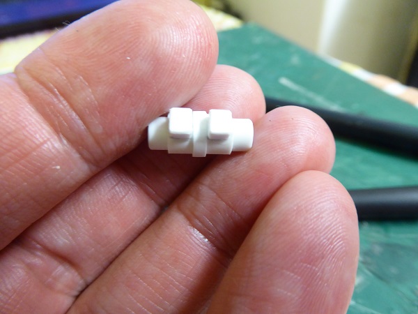

The next stage was to start building some of the ancillary detail. The attached photo shows a starter, made from styrene rod and sheet.

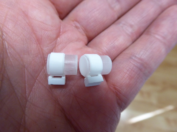

I then turned my attention to a similar type of 'starter' for the starboard side. The black section is in fact part of an old biro!LOL It just so happened to have the right diameter!Flapper

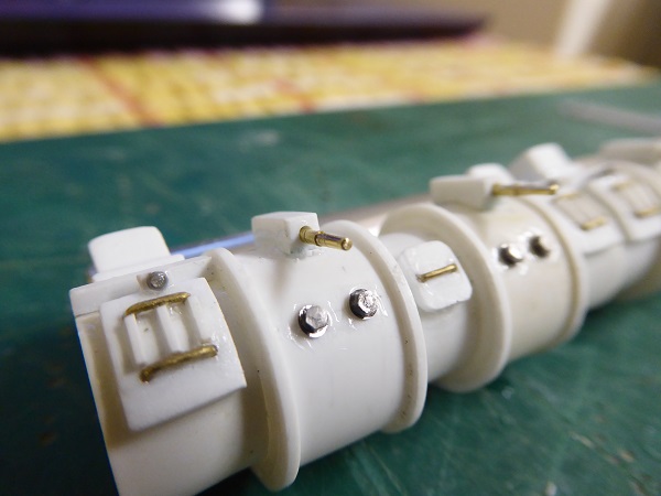

Good morning from 'The Dockyard'.
More progress this week on the main motors.
The attached photo shows the 'starter?' connected to the starboard main motor.

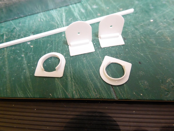

This photo shows the fan housings being made.

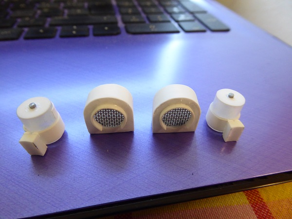

I then fitted mesh across the air cooler fan opening and finished off by wrapping a strip of 0.25mm thick styrene sheet to make the outer body.
The attached photo shows the air cooler fan housings and electric motors completed.
