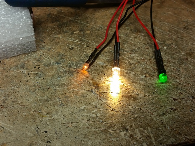

Following on from yesterday`s post of the pre-stage and stage led lights, I have run another test.
The pre-stage and stage led`s are 3mm as they are meant to be smaller than all the other lights. So the others are 5mm.
Now here`s the rub.Blink
To buy led`s by the most economic means you need to buy them in batches of 10 or more.
That was fine for the 3mm yellow ones as I need 8.
For the larger ones I need 6 yellow, 2 green and 2 red that`s 10 in total not 30 as in 10 of each colour.
The solution is Tamiya clear colour paints. I buy 10 white light led`s and colour the lenses as needed.
So the pic below shows (left to right) a 3mm Yellow, a 5mm white and a 5mm green painted white. (Awaiting delivery of Tamiya clear yellow but have red and green.
For anyone wanting to colour led`s the Tamiya clear paints I know of are as follows:
X23 - Blue
X24 - Yellow
X25 - Green
X26 - Orange
X27 - Red

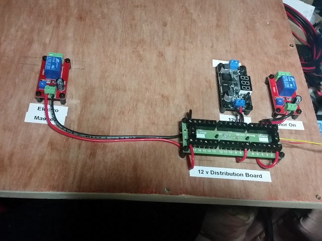

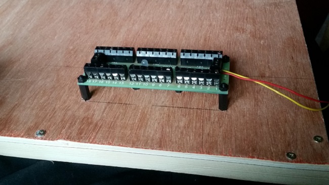

Hi All, BigGrin
Its been a while since I posted on this, purely because I`ve been doing all the boring measuring, re-measuring calculating sizes and therefore the position of everything.Bored Bored
I now have most of the base unit sorted to a point where there will be very little fixed to the dio base itself, with all the electronics and mechanics working through the dio base. This will give me 100% access to everything underneath the dio itself with little fuss.
For now two pics attached to show the start of the lower base for all the workings.
More to come soon.Blink

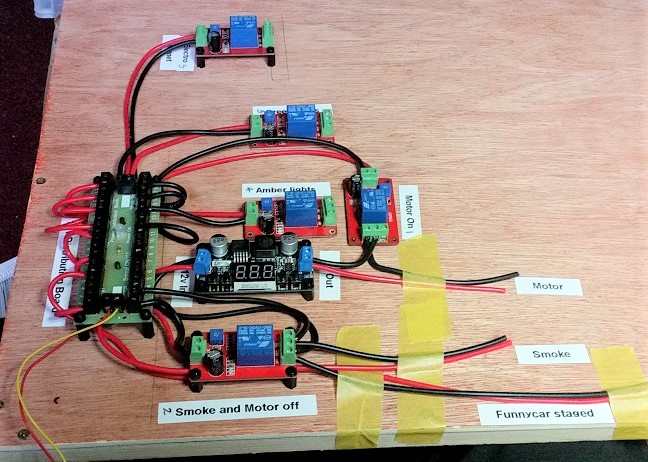

Hi All, BigGrin
Its time for an update:
The required timers turned up and today I`ve made a dummy run at getting all the timers connected (wires only, not to the base).
For the above reasons this is now not so neat and tidy, but I have managed to get all the timers synchronised to be in the correct order. They will need a fine tuning session when they are all fixed to the base board, but for now its the next stage proven that this project will work as expected. (Fingers Crossed)Blink
Still to add to the base:
Electro Magnet to move Pro-Fueler
Magnetic micro switch (Brings on the staged lights for Pro-Fueler)
Main drive unit for the Funny Car and gears to get drive up to the rear axle
Christmas tree light unit to hold all the led`s.
Its the fitting of these items that will make things happen up above on the dio base. This will then be the next stage of measurements to see how high I need the dio surface above the electro/mechanical base.
Just hope it now seems like I know what I`m talking about.LOL LOL
One pic attached below of the base board as it now looks.
