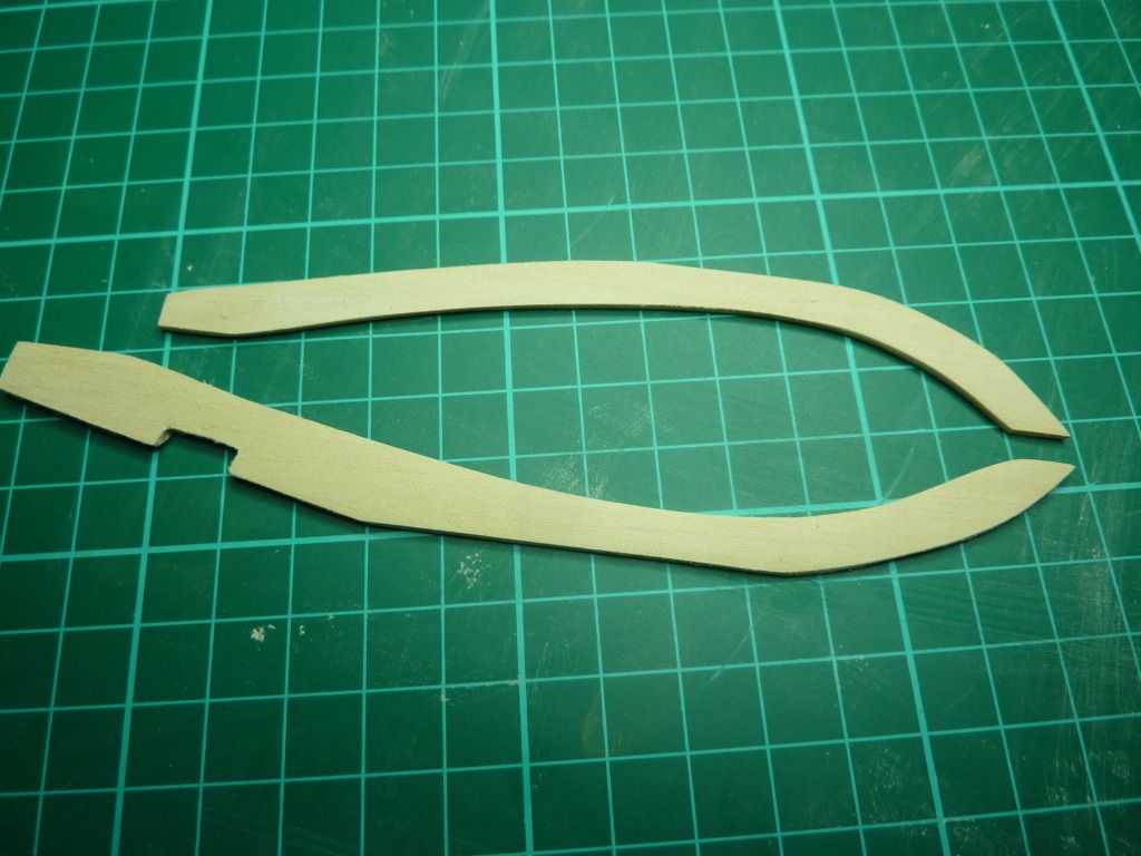

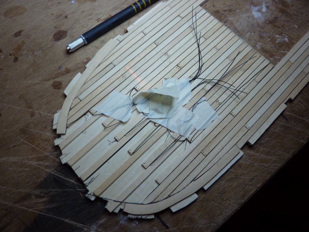

Thanks for the encouragement, I am now attacking the border to the bow, making a paper template of the curve then going to cut the border timber out of plywood. I will keep you posted.

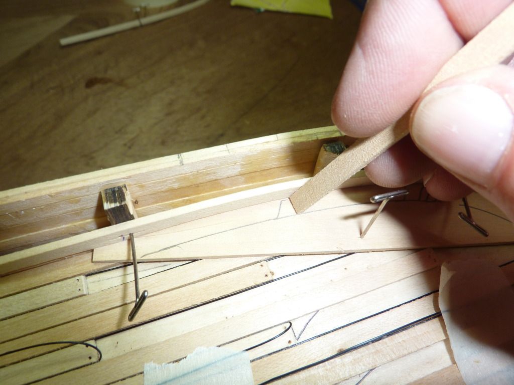

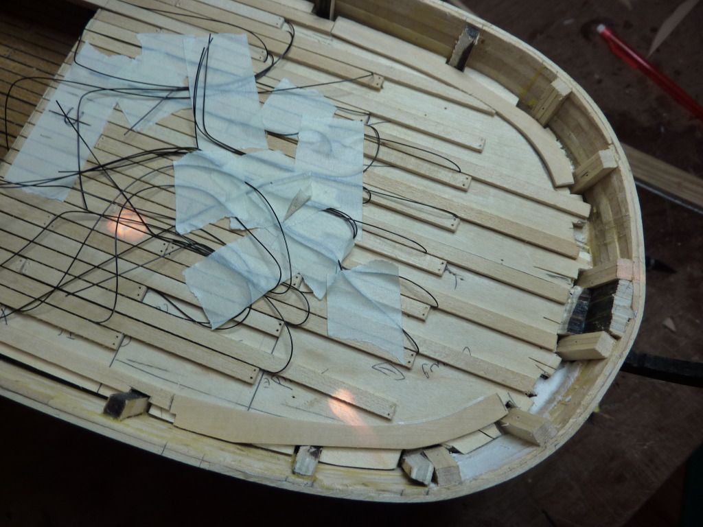

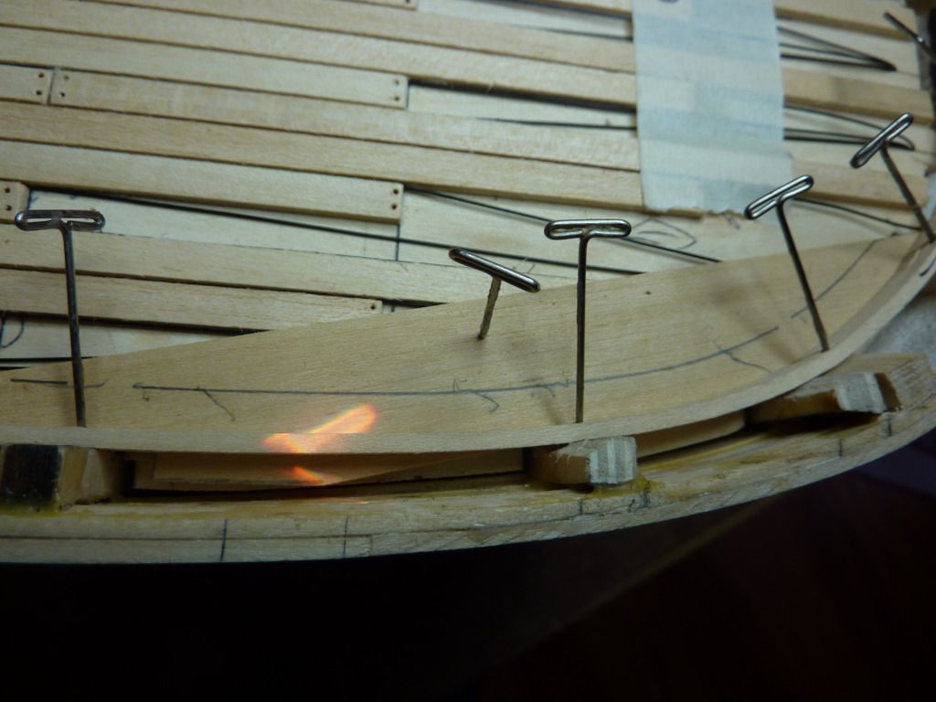

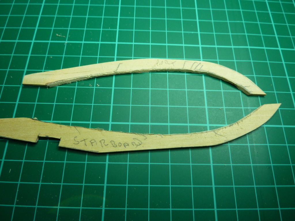

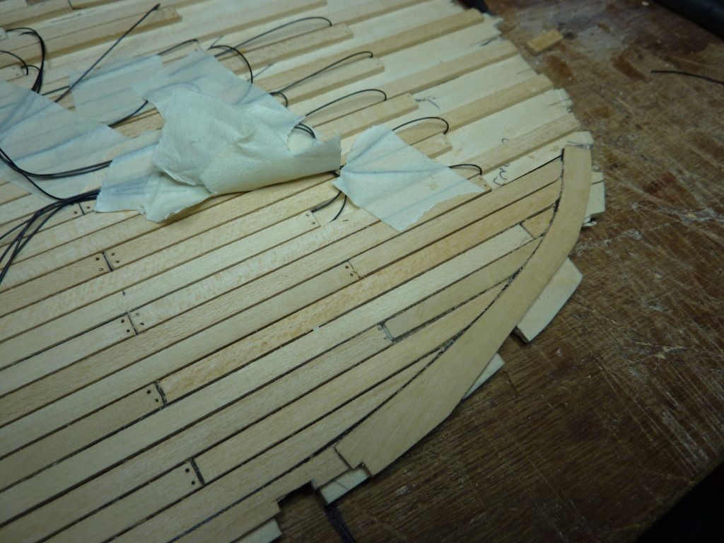

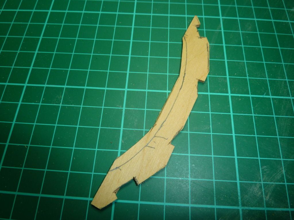

After the disaster of trying to form a margin plank to the deck at the bow,( in plywood ). See my post on Surprise - General - Advice sought. I have now got timber 20mm wide and I am going to do the margin plank in 3 stages, The timber is less likely to split.

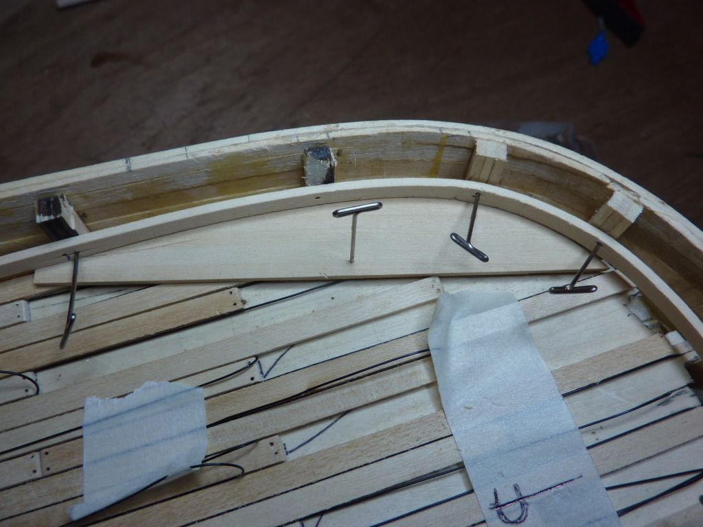

Firstly I cut a bit of the 20mm plank and fitted it to the frames.I did this to both port and starboard sides.
I them fitted one of the pre bent bulwark planks and pinned in place.
I then used a piece of deck planking and marked a parrell line round the bulwark plank. This then gives me the finished line i need to achieve.

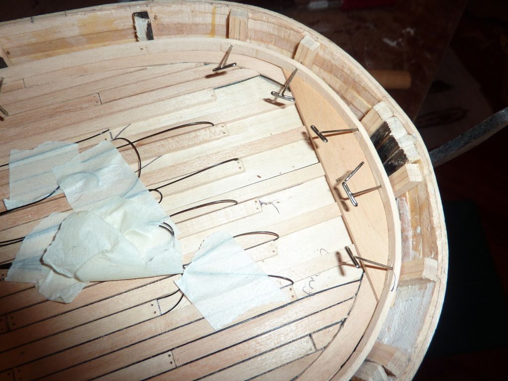

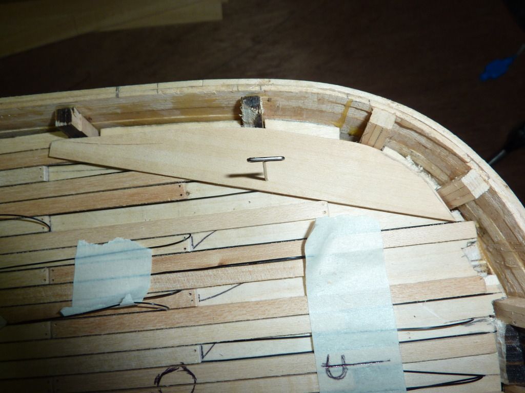

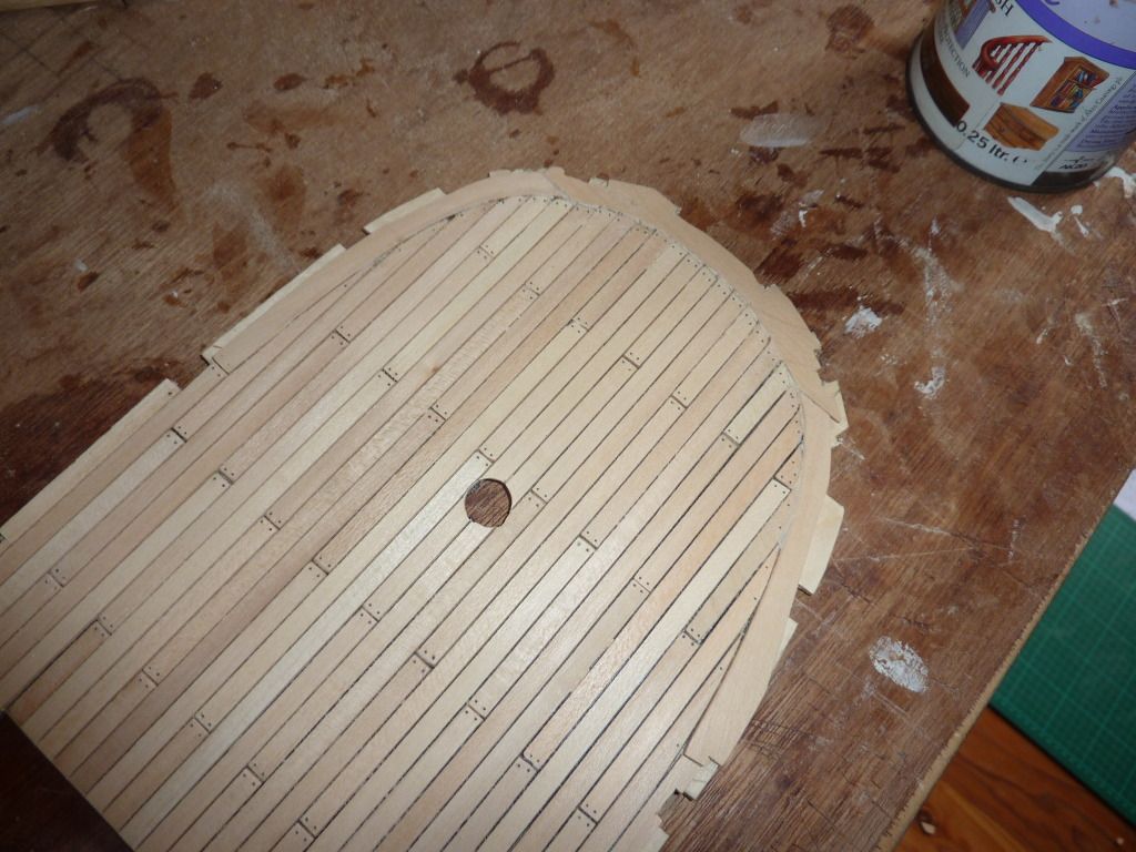

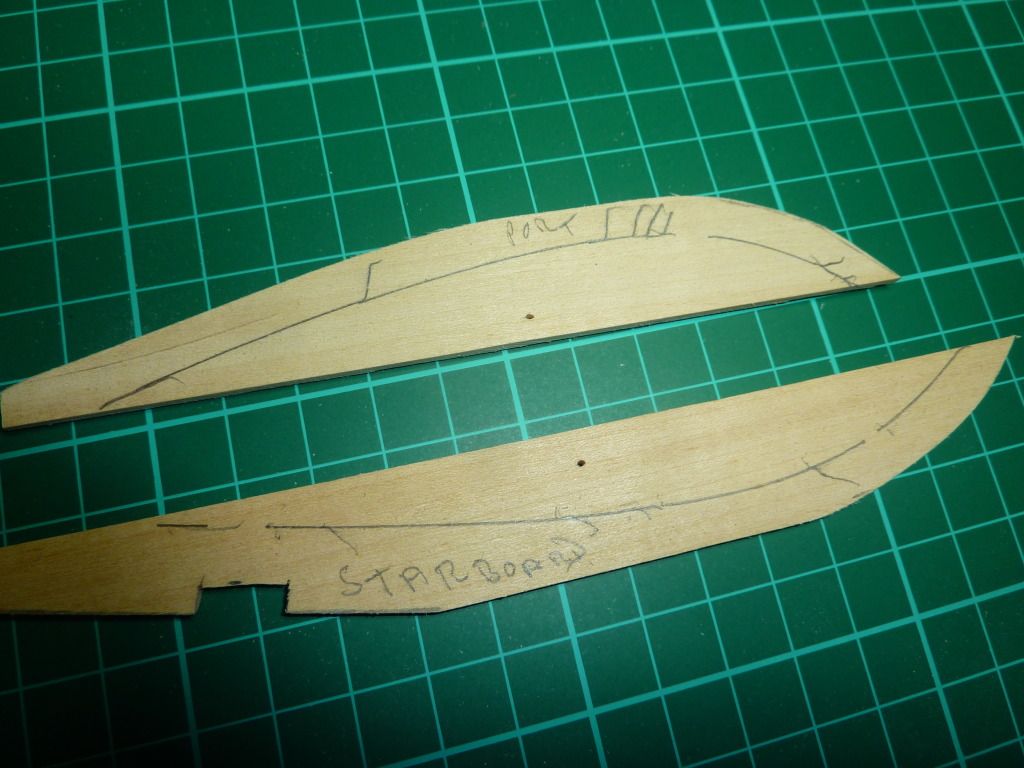

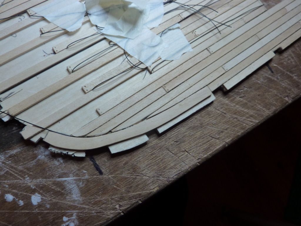

Again the margin plank now marked ready for cutting.
Now all cut and sanded to shape.
I then glued and fitted the pieces in place.
then it's just a case of cutting and filling in the decking.
and after the two side margin planks I did the one to the bow.
Over and out for now.

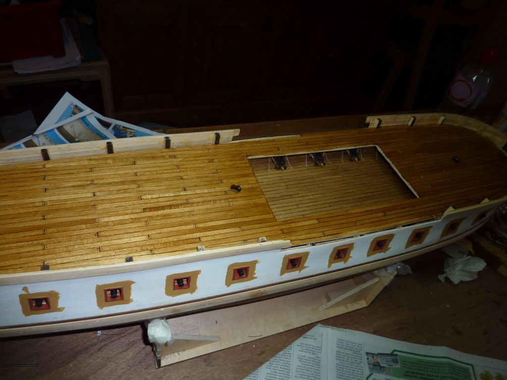

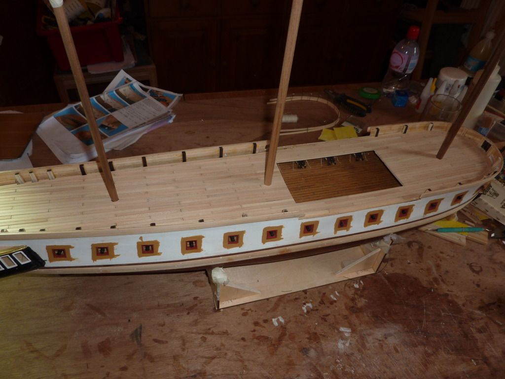

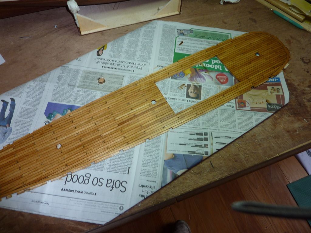

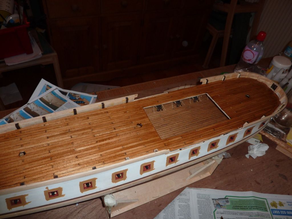

I have now finished the margin plank to the bow and filled in all the planking.
I have also transfered the mast holes from the lower deck to the top deck.I have also checked the hatch opening is straight and square, and I have done all the treenailing.
And again I have treated the deck to a coat of oak stain.
Quite happy that all that work in now complete.

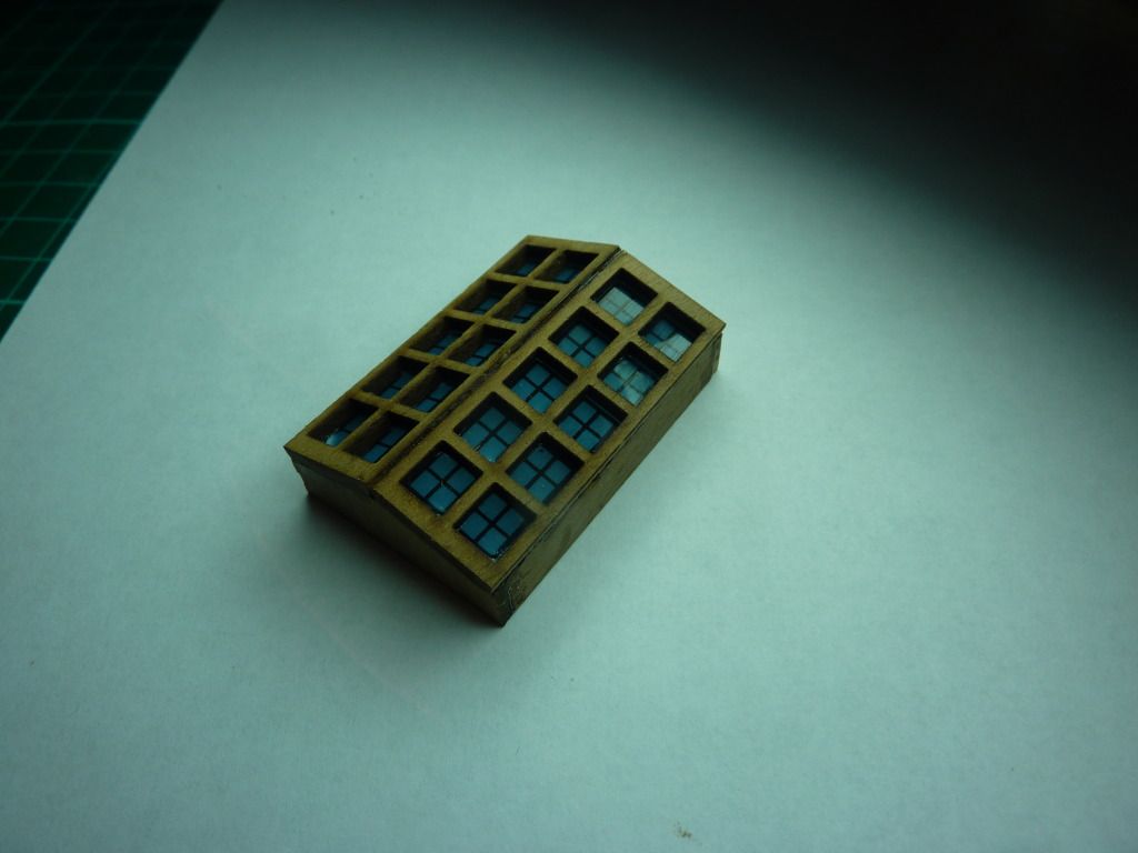

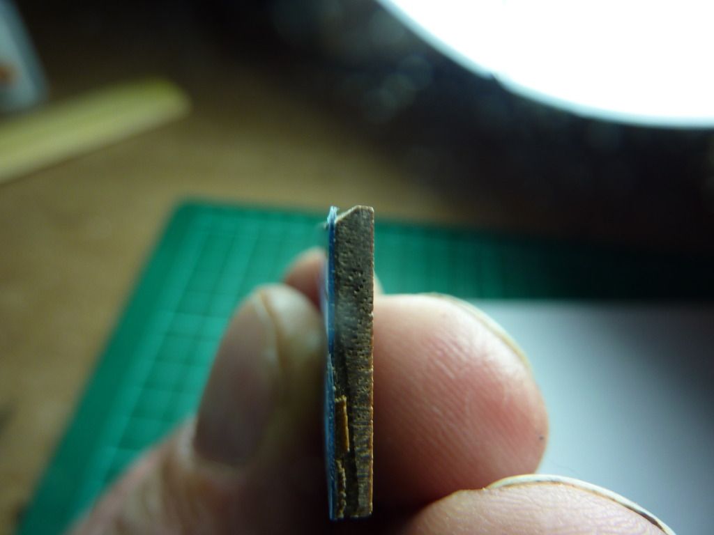

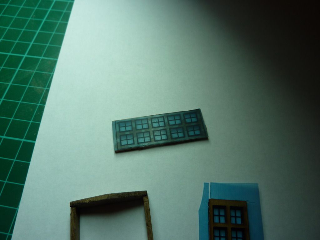

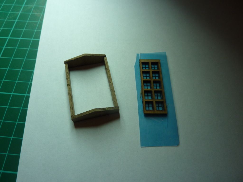

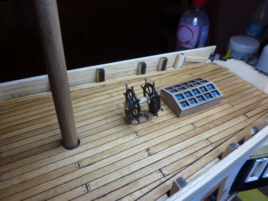

I am doing things a bit out of sequence, but its the way I feel sometimes, looking for a easier task to do, I have now decieded to make the furniture for the top deck, The first thing I am going to do is make the ( dont even know what you call it )see pictures.
I glued the two ends to the two sides, with super glue, The roof panels with the windows in it, I gave two of the long edges a back bevel, So as when they are glued in place, there will be no gap at the ridge, I also super glued the blue plastic window material to the roof panels.
I then glued them all together, once dry I sanded all the faces to get a good finish, I will give all the walnut a coat of clear varnish at a later date, before fixing to the deck.
Mo

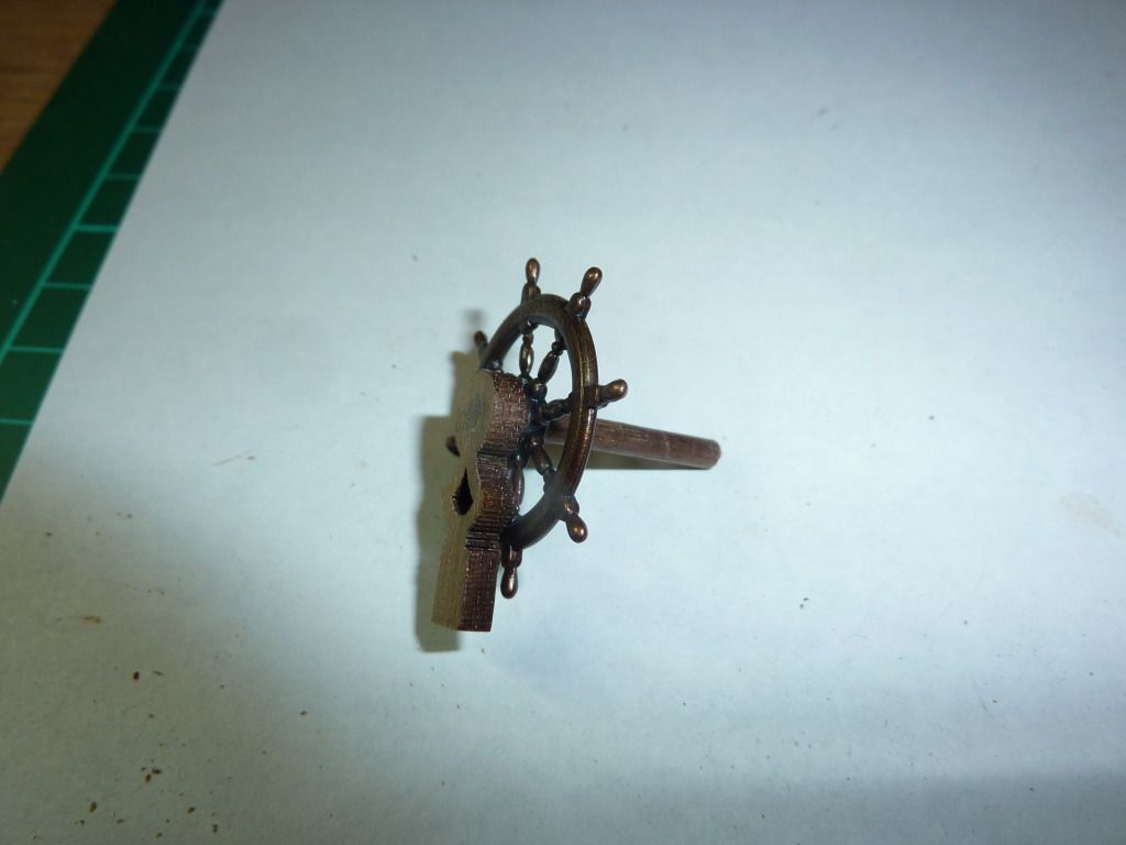

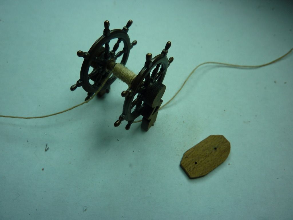

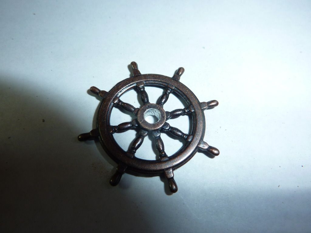

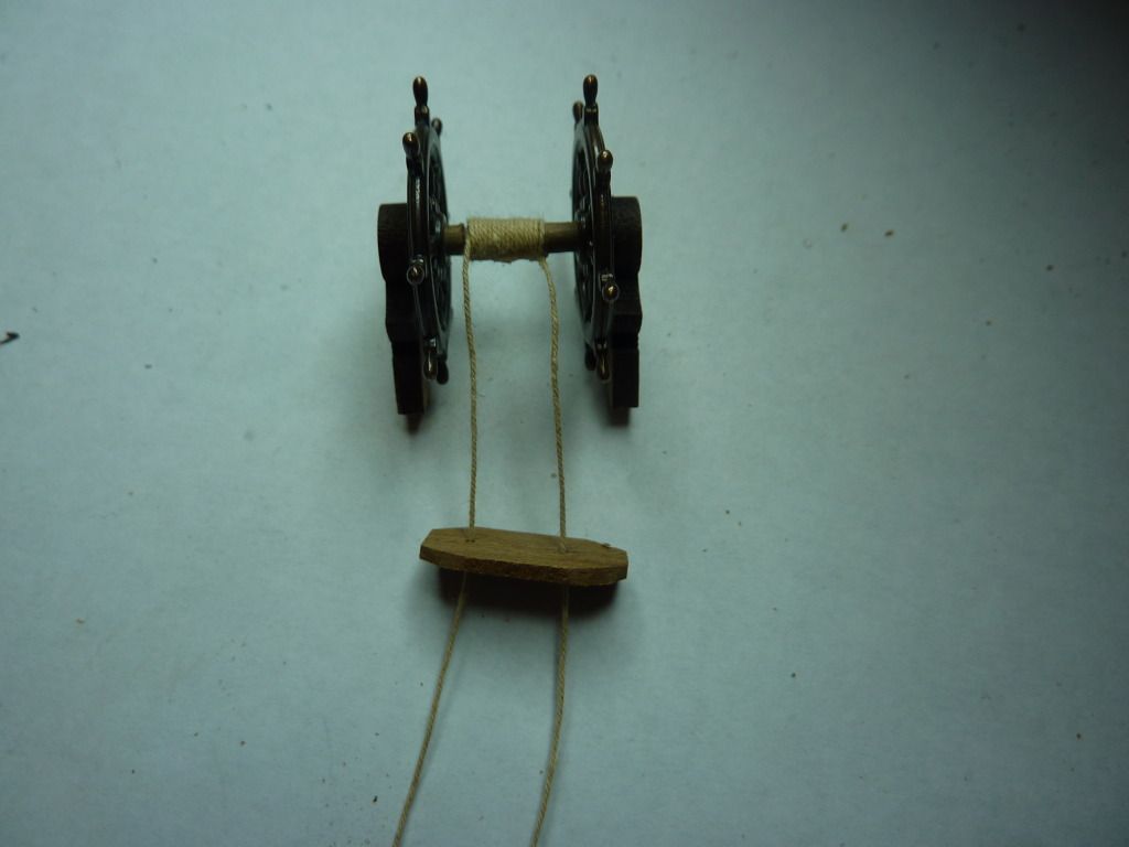

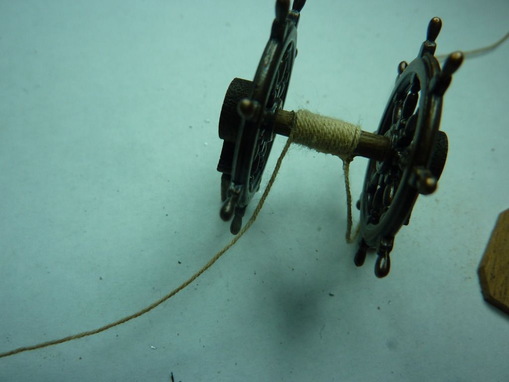

It was then on to the ships wheels.
I did not follow the instructions here, I just did my own thing. I re bored the holes in the wheels out to 3mm, I then used a 3 mm walnut dowel and glued the dowel and one of the end in place.
I then glued the other end in place along with the wheel, trying to keep the handles of the two wheels in line. I also made a piece of timber for the base plate, which I bored 2 holes in to take the rope for the rudder.
Again well chuffed how it is all turning out.

hi mo,is the word skylight?? look great coming on a treatCool

Points: 1,675
And thanks Karl, A skylight it is.
