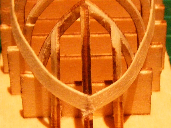

Spent some time very gingerly fairing the hull of the launch using nothing more than a fine grain emery board and lots of patience.. Flapper .. Think I am just about ready to have a go at fitting my first plank... Will post photo's of my planking attempt soon.. In the meantime here are the images of the faired hull....Blink Blink
#152 Posted : 10 November 2012 15:18:58
Hi Alan Everything looks goodBigGrin Regards Mike
