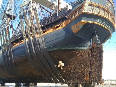

Just a quick question..how did you determine the position of the waterline on the hull, can you give me an approximate datum point somewhere on the hull?

I determined the height by carefully examining photos paying attention especially to the rudder area on the Movie Version of the ship. Then I set a block of wood at the proper height with a drilled hole for a pencil and dragged the block of wood and pencil around the model as it sat on the stand. The ship must be perfectly level on the stand.
Then I ran pin stripping tape at that pencil point to check the work and made corrections as necessary.

#157 Posted : 28 June 2016 19:14:54
Joined: 18/04/2016
Posts: 134
Points: 402
Location: Durban, South Africa
Think this one might work...
There's no time like the present.....
#158 Posted : 28 June 2016 19:55:46
That`s a good indication to the water line.
Only one thing though, that must be the GT version with the prop.LOL
#159 Posted : 28 June 2016 23:04:21
Simply fabulous....
johncal
#160 Posted : 29 June 2016 00:00:51
Joined: 02/04/2013
Posts: 174
Points: 534
Location: Bethlehem PA, USA
Just a little more work up front. Adds a little to the authenticity.
