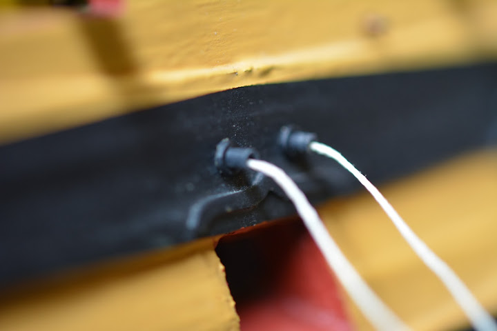

Hi all,
Another little update on the gun port lid lanyards.
Below is a pic of my "assembly" line producing the lengths of rigging cord encased in the heat shrink tubing.
Daunting to think that that is only just over half of what is needed Blink
Next is a closer shot of the brass washers, I fitted them over the sleeving further back so the edges could be painted before moving them nearer the front.
Once painted and dry, they were glued into the holes drilled above the gun ports.
I have nearly completed all the lanyards now, but will be waiting on carrying on with the lids after a find on the internet.
I was never that happy with the large moulded hole in the top face of the supplied Del Prado lids. You can see the raised part below the eyelets in the pic below.
Well, I have found a company in Germany that is producing PE parts to enhance the
1/100 Heller HMS Victory kit. Along with some other great parts they make, are gun port lid hinges.
With these I can file off those large blobs, reverse the lid and fit the new hinges on what would have been the inside of the lid which just has planking detail on it.
I have also ordered a set of rigols for above the gun ports.
Although I fitted aftermarket rigols some years back, they are a bit big as they were for a 1/96 scale kit and despite being the correct shape, more importantly to me, they do not have the correct profile like the ones above. Its a pity these things weren't about 7 - 8 years ago Cursing
Doing this will probably require some repair work, but I can't resist it.BigGrin

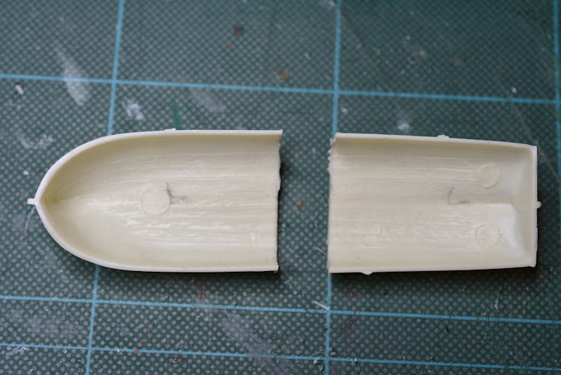

So I decided to have a stab at something that's been on my mind for some years now, the ships boats.
At the time of Trafalgar, Victory carried 6 boats, a 34ft launch, 32ft barge, 28ft pinnace and an 18ft cutter (jolly boat) that were stowed on the skid beams. Also 2 X 25ft cutters slung from davits, one either side of the poop deck.
Unfortunately, Del Prado were a bit economical when it came to ships boats Mad , they did provide 2 cast metal boats for the davits that were good scale wise in length, but not really the correct shape for cutters as they did not taper very much at the stern. So over the years I have scoured the internet and model shops for kits of any type that would represent the ships boats, the longer cutters, barge and pinnace were not too problematic but finding something the correct shape and length for the launch and jolly boat seemed impossible. I have looked enviously at the boats supplied with the De Ag kit and if I were working on something near that scale I would gladly buy all the issues needed for them.
Some years ago I heard that the ships boats supplied with the Revell
U.S.S. Constitution (7 no less) could, with a little reworking, make suitable donor hulls for Victory's boats and a few months ago I managed to acquire said boats and they have been waiting ever since for me to do something with them.
On first checking the sizes and shapes of the hulls I was able to set aside ones to represent the barge, pinnace and the 2 X 25ft cutters without alterations, but the launch needed some work as did the jolly boat.
The hull for the launch was spot on for shape and width but too short in length, so I cut it in half amidships and inserted a section of styrene sheet to bring the overall length to 103.6mm (34ft at 1/100).
I hope to be able to loose the small bulge in the middle when fitting the top rail and/or thwarts.
For the jolly boat I butchered 2 other boats and used bits from each to form the short dumpy shape required and again will broaden it slightly more in the centre when fitting the thwarts.
