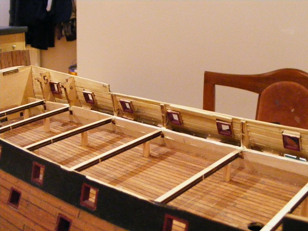

Small update on progress to lower the decks... Having now satisfied myself the deck levels are more to my liking I set to work adding additional supports to the deck supports... this was done using 6mm beech dowel ensuring a snug fit but also ensuring the fit didn't raise the decks any... Cool Cool .. Test fitted the decks again and all looked good... BigGrin BigGrin .. Have also cut, dry fitted and finally glued the additional dummy gun supports along the starboard side, this also meant they needed reducing in height due to the lower decks...Cool Cool .. Hopefully tomorrow will get the dummy supports fitted onto the port side and paint the inner surfaces black...BigGrin BigGrin

Short update, finally finished fitting the decks tonight and am a heck of a lot happier with their levels....BigGrin BigGrin .. Also, rather than just using offcuts of deck support strips for the pillars I decided to change it using 6mm beech dowel, staining them first with a light oak....Cool Cool .. Have not cut the support strips going across the hatches, decided to leave that for now as I will be leaving a slight overhang to act as a support for fitting the gratings, will help prevent the possibility of them falling through the hatch... they won't be seen when finished... Cool Cool

Excellent work AlanCool Cool Nice consistent depth to the ports and plenty of space for the waterway.The decking is a tough call,they are both nice.I know purists say light wood because of all the holystoning etc etc,but I think it would jar with the rest of the build.I think the lighter one but that's only 60/40.Definately think you are right to stain it.
