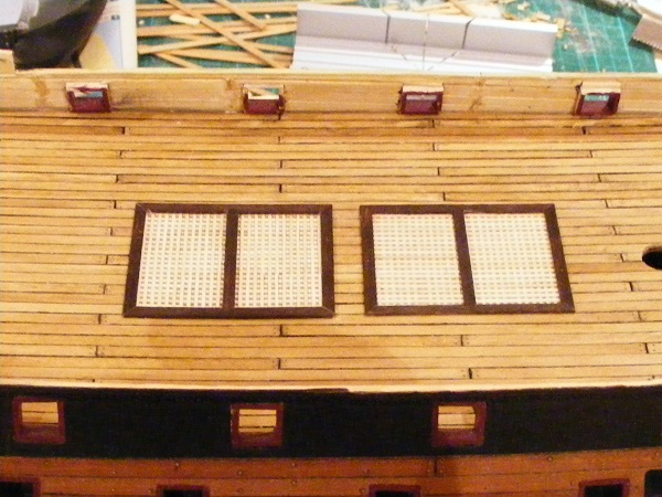

Short update tonight.... Have now finished the second grating so now tomorrow can get started on fitting the forecastle and quarterdecks.... Cool Cool ... Will post progress soon....Cool Cool
NMBROOK
#1685 Posted : 05 September 2013 23:07:04
Wonderful work AlanCool Cool You are quite an expert at splicing gratings together.

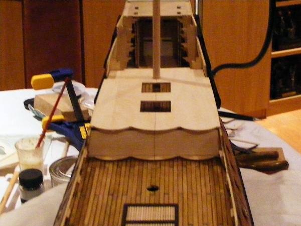

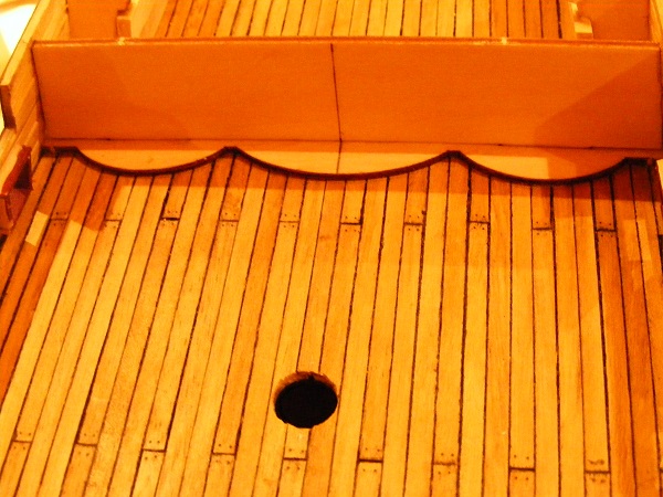

Ok, so a short update on progress tonight.. Have made a start on fitting the forecastle and quarterdecks and looking at the instructions have decided to deviate on the order of the build... First thing I did was to draw a line down the centre of the decks and the supports. Also made discrete marks on the deck to ensure I kept everything in line, especially the lining up of the mast holes..Cool Cool .. The cutting back of the bullworks on the quarterdeck is also being left till after the deck is fitted... Cool Cool
#1692 Posted : 06 September 2013 23:24:53

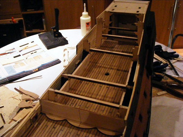

When happy, glued and clamped the quarterdeck bulkhead support in place and left to set.... While that was being done, moved onto fitting the dummy gun supports and as I planked the whole deck I had to cut small notches in the supports to ensure a good fit under the rib ears, again glued and clamped in place..Cool Cool
#1693 Posted : 06 September 2013 23:32:41

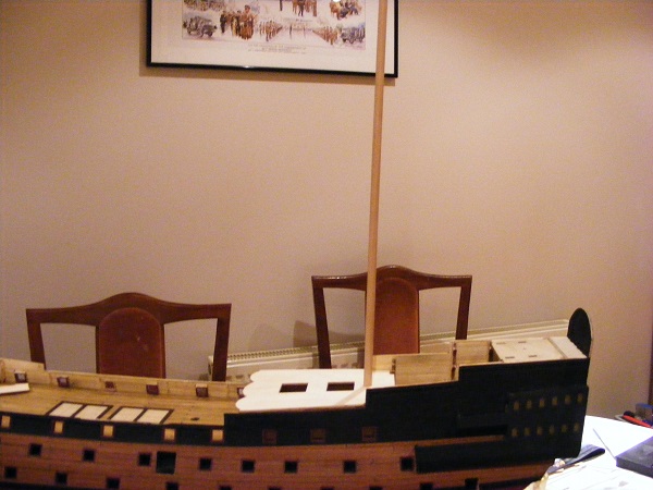

Finally when everything was set then did a further dry fit of the quarterdeck to ensure everything still lined up... was pleased to see it did.. Cool Cool .. As I lowered the decks earlier I can now see I have to add additional support under the forward bulkhead to ensure I end up with the deck at the correct level... Cool Cool .. Inserted dowel into the mizzen mast area and was very pleased to see I had maintained the angle to the stern, my only concern here was so far I cannot find any information as to what the actual angle of the mast should be so will have to keep hunting for that information.... BigGrin BigGrin .. Will continue fitting the quarterdeck tomorrow... Cool Cool
Happy building all..

#1694 Posted : 06 September 2013 23:45:46
Fantastic work AlanCool Cool
The mast angles are mentioned in Anderson's bookCool SomewhereBlink Blink Blink I remember reading it but can't remember the angles other than the foremast is actually angled forward 1 degree.
Kind Regards Nigel
#1695 Posted : 06 September 2013 23:52:17
Kind Regards Nigel
Thanks Nigel, I did see it in Anderson's book but it left me a little confused... He doesn't talk about angles he talks about ratio's..I think...LOL LOL . The foremast has a slight rake forward, the main mast a slight rake towards the stern and the mizzen has a rake greater than the main mast. He doesn't give actual figures for the mizzen but does refer to a rake to aft of 1 in 20.... 1 in 20 is where I lost it....LOL LOL..
NMBROOK
#1696 Posted : 06 September 2013 23:57:08
One in twenty equates to 2.86 degrees,don't you remember pythagoras?LOL LOL Flapper Mind you I only remember because I used to use it daily in my job.
Kind Regards Nigel
#1697 Posted : 06 September 2013 23:59:32
Kind Regards Nigel
Py who????? LOL LOL LOL .. 2.86 degrees I can equate to as it's simply language.... remember, I'm almost an old foggie who got excited being issued with his first pencil... slate and chalk back then......LOL LOL Flapper Flapper LOL LOL ..
Thanks again...
#1698 Posted : 07 September 2013 00:04:17
Another question about 2.86 degrees.... is that in relation to the deck or to the waterline.... deck also has a slight slope to it....

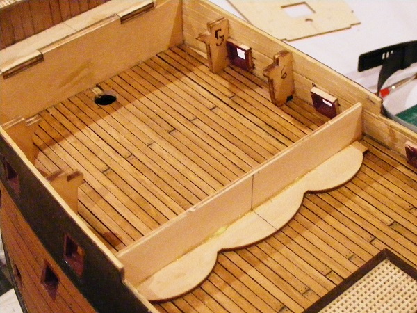

Tonight continued the process of fitting the quarterdeck and forecastle. Cut, fitted and glued the deck supports in place for the quarterdeck. When dried I carried on with sanding down the sides, down to the level of the deck supports ensuring I would have a nice flow at the edge of the quarterdeck and hull... Cool Cool Once happy I then trimmed down the bullwork to the edge of the forward bulkhead... Only remains for me to actually glue the quarterdeck in place, that will be done when I have finished the forecastle.... Cool Cool
#1700 Posted : 07 September 2013 23:43:06
Turned my attention now to the forecastle.. Again drew a marker line down the centre of the deck and the forward bullhead supports... Dry fitted the base of the bulkhead and drew a line across the deck. Cool Cool... Glued and fitted the bulkhead support and left to set ensuring it lined up with the discrete marks I applied to the deck... Dry fitted the forecastle and noticed a small problem than will need to be dealt with Crying Crying .. Noticed the edge of the forecastle deck is a little narrow for the span, think that the gap is just a little too wide to try holding in place with clamps and worried this method may actually crack or break the hull sides.... Will have to look to extending the deck by about 3mm in total, will get onto that tomorrow and post the progress...
Happy building all
