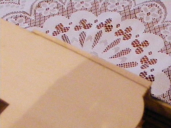

Tonight I got to work on the forecastle area and started by extending the width of the deck... Dug out the fret the deck came out of and cut the sections needed for the fix... trimmed the pieces down the glued and clamped the pieces in place.... Once dry and secure carried out a test fit to ensure I had enough width... Cool Cool

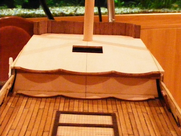

Fitted the dummy gun supports, painting the inner sides black followed by fitting the deck supports in place... Cool Cool .. Having reduced the level of the main deck I now set to work on ensuring I maintained the correct height for the forecastle. Using some offcuts of 2 x 5mm walnut, glued strips along the top of the forward bulkhead support which raises the front of the deck to the mark I made when lowering the main deck..Cool Cool
#1713 Posted : 08 September 2013 23:10:37
Continued then to sand down the bullworks to their correct level an in order to ensure support for the new width of the deck I added additional strips of bamboo to the inner bullworks. Finally carried out a test fit, ensuring everything lined up and was happy everything was as it should be... Cool Cool .. Tomorrow will glue the forecastle and quarterdeck in place and give a final tidy up of the edges before painting the edges black.... Cool Cool
