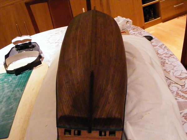

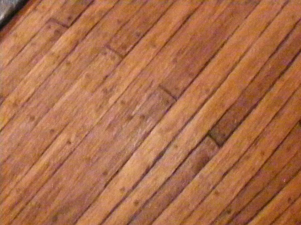

Having finished issue 47 I decided not to go any further until I had finished protecting the hull.... Have spent quite a bit of time over the past few weeks experimenting with different finishes and my overriding objective was to ensure I pulled the grain out of the walnut and that the treenails could still be seen... Cool Cool Over the last couple of evenings I have been applying a medium oak stain, 2 coats in total with a light rubbing down in between and am really pleased with the results so far....Cool Cool .. One side still to receive a second coat before moving onto applying a couple of coats of varnish.... Cool Cool .. Hopefully will post pics of the finished hull over the next couple of evenings....Cool Cool

Wonderful AlanLove For what is in essence a first build,that looks tremendous,you should feel duly proud.Are you going for a matt varnish?if so I can't recommend ronseal mattcoat enough,especially if sprayed on.

Thanks very much Nigel for your very positive comments, especially from such an experienced builder as yourself..... Cool Cool .. My intention is to use a satin varnish purely because it is a display piece, I think satin has a lovely soft appearance and on the test pieces I have done think it looks really good..... Cool Cool .. Thanks again....

I too am varnishing my Hull, my original intention was to use Satin, but the Sapele did not finish well in the Satin, so I've switched to Matt on the Upper Hull (Sapele and Boxwood) and Satin on the Lower Hull (Maple). I agree with Nigel, the Ronseal is a top quality product and it's what I'm using (3 coats). We want these builds to stand the tests of timeLaugh

Hi Andy, my thoughts entirely.... Wasn't too happy using satin varnish on the Sapele, tests made it look a little patchy in places... Will also be using Ronseal matt on the upper hull and Ronseal satin on the lower... The varnishing stage will start tomorrow evening..... Cool Cool

Short update, have now finished staining the lower hull, 2 coats of medium oak followed by a light rub down with very fine grade sandpaper... Tomorrow will make a start on applying the Satin varnish, will see whether it will be 2 or 3 coats that will be needed... Cool Cool
