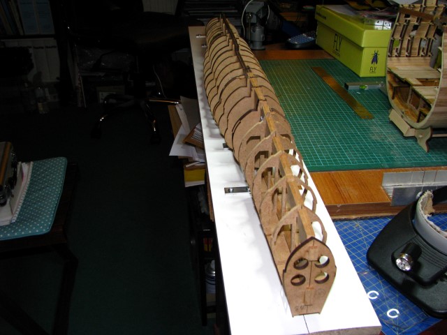

I also would recommend to put her into some sort of jig to keep the keel straight while planking the hull.
Keep up the good work,
DaDokta

I agree, she's looking good and that it would be a good idea to rig up some sort of clamping jig to hold her straight whilst the planking is added although this may be tricky as the plastic covering for the keel is fitted prior to planking. I'm sure we'll think of something.

Hi guys, thanks and yes, you're right, I do need something to keep it all lined up while the cladding is going on. What I've got in mind now is something that will hold the model in an upside-down position and holding the top of the keel frames because work doesn't start on the deck area until most the planking is completed. This will allow almost complete access to the rest of the hull while work is ongoing.
Watch this space and I'll see what I come up with BigGrin

BUILD UPDATE #19B
Hi again, and thank you for all the nice comments.
I have been to the local DIY shop today and bought some bits and pieces to make a jig for build, and this is what I came up with.
Nothing to elaborate, just kept it simple and functional.
A piece of white shelving board 4ft x6" x 3/4" (or for those who like metric - 125x15x0.75cm)which I bought at the start of the build to lay out the hull when there was only one side finished.
Also used were several packs of 40mm corner braces and a few 'knock-down joints.
I used the 'knock-down joints at the bow and in the centre of the hull and the corner braces spaced out equidistant for the rest of the hull.
A centre line was made down the length of the board, and I used the joining line between the two halves of the model to line it up with center line.
Working in from each end, I used two of my spare frames glued together as a spacing guide to fix the brackets to the board.
The model is held quite firmly now and there should be no more trouble with the MDF 'flexing' at each end and I will be able to work on cladding the hull with far more confidence now.
Happy building
David

Nice jig!

Nice one David, I will do the same sort of thing for mine. It certainly keeps her straight.

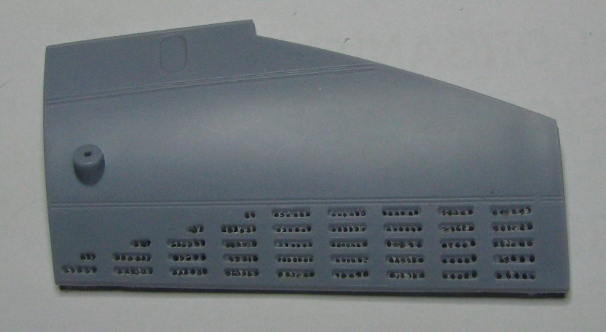

The delivery of my next set of parts has got me thinking. Some of the small slots on the hull (they do have a name but I don't remember what they're called)are open and others are not (see picture). I feel that to give the model more uniformity and authenticity, I have been pondering over whether or not to open up the 'closed' slots in the moulded parts. I've seen it done in a German forum which I found and the results are impressive.
So I've tentatively decided to open them up. I have the necessary tools, and as there are only 2 parts each week now, I've got plenty of time to carry out the work on them.
Another issue the next few weeks is the assembly of the plastic parts for the keel. I've decided to build them all in one 'session' so that they all line up with each other, but first, the drilling out of the slots (I'm sure one of you guys can tell me what they're called).BigGrin

The parts you could mot remenber the names of are the vents used for ballasting the submarine when submerging. look forward to seeing more of your build Ian.

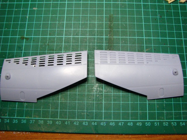

Well my friends, I finally finished cutting out those ballasting vents. What an endeavour that was, and it's only the start.
As you'll see from the photos, there's still a little tidying up to do. Had to use some plastic putty on one of the small slots because I enlarged it too much so had to fill it up and reopen it.

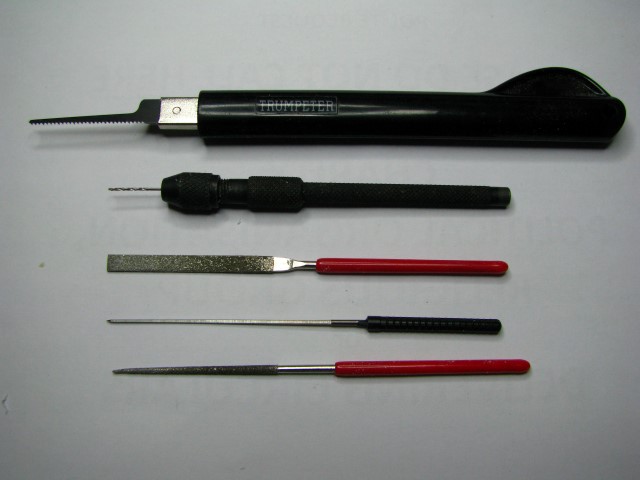

The tools I used comprised of:
Trumpeter Micro saw: a pin vice with a 0.9mm drill bit: a flat diamond micro file: a 1.2mm cutting broach file, and a round diamond micro file.
First, I used the pin vice and drilled out a series of holes in each slot, then reamed them out with the broach file, used the micro saw and cut across the holes.
Then I enlarged the slot again with the broach file, and finished off using the flat micro file. The micro file was just small enough to get into the slots to smooth them all off.
After all the slots were opened, they were finished off by using the round micro file to contour the ends of the slots.
After completing all the work, I used some various grades of 'Micro mesh' to work out any scratches on the surface of the parts.
As I said, there's still a little tidying up to do, but all in all, I'm very pleased with the result and I'm glad that I took the time and effort to attempt this alteration and in my opinion, it has made all the difference to the look of the parts.
Well that's all for now, I should get some work done on the build in the next few days, so until then, thanks for looking in and a big thank you for the comments.
Happy building
David

I have to agree, well worth the extra effort, its given the ballast vents an much more impressive look. Great efford Cool

David, i love the result of your effort!
Keep the good work going!
