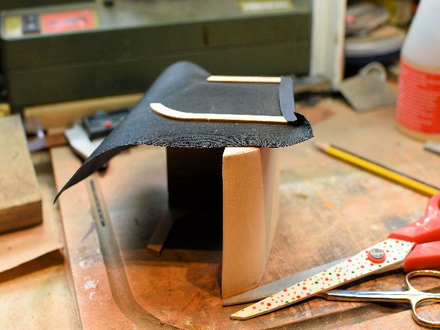

#164 Posted : 26 September 2019 12:23:38

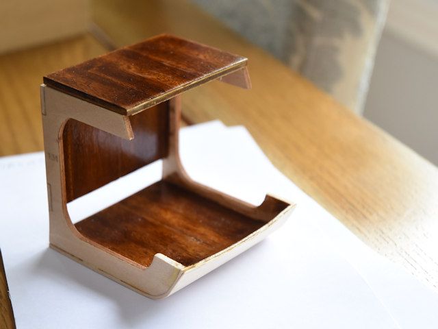

Making and assemble of the Winch Box:
The winch box will be were the driver will sit,this will be made from wood and leather as you will see in the next post.The main frame is made from ply
which has to be turned up at the front to fit the foot plate,also it will be fitted with a internal door which has a brass handle.there are two small seats to upholster should be good fun.
Trev.

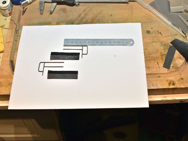

#165 Posted : 01 October 2019 11:19:33
This picture shows marking and cutting the Leather side to shape.

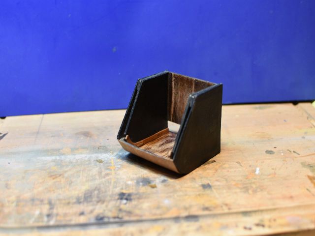

#169 Posted : 05 October 2019 18:03:44
The Winch build has moved on to this stage,floor and back have been added also the sides Left-Right,next will be the main foot rest (5 pieces 1.5x 2mm)then the roof and more wooden side bits all hand made.
Trev.
ps: Winch is were both drivers sit.

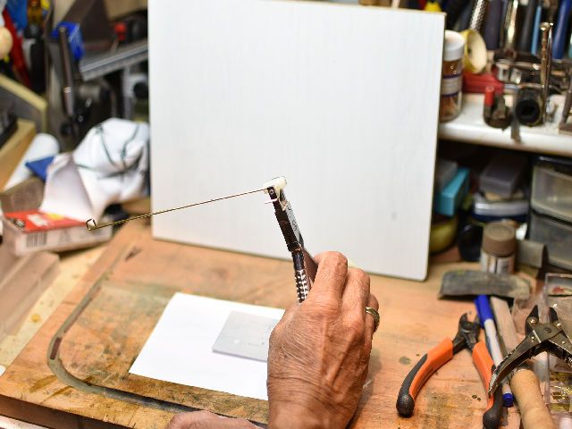

Thank you for looking in and your nice comments,I have moved on a pace now just finished bending and soldering the hand rail,which forms a small rail around the drivers,air brushed black today hope to post tomorrow.
Trev

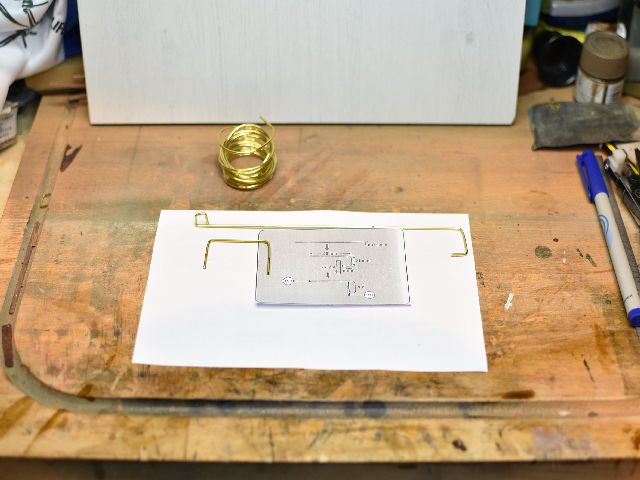

UPDATE:THE WINCH.
Cutting and Soldering Hand Rails.

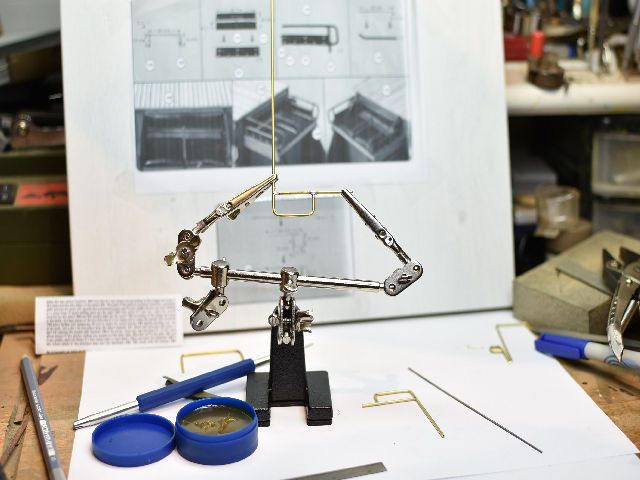

To make two hand rails take the 0.2mm brass rod, cut two 85mm pieces then shape into 3 bends (8mm 21mm leaving 56mm length,now solder and clean up,
when finished make one more to match the first.
With the same 0.2mm rod make the central rail this is the one between the cushions, this one you have to adjust to the length of the winch box.
Brass rods ready to be Soldered.
Having fun.
This shows horizontal bar to be soldered.
This bar shows where the leather dust sheet will be stitched on.
Finished and painted
Trev.
