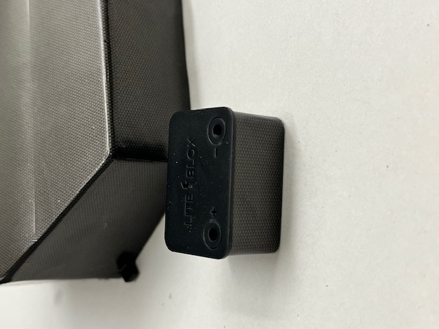

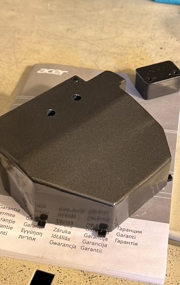

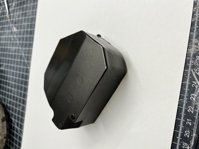

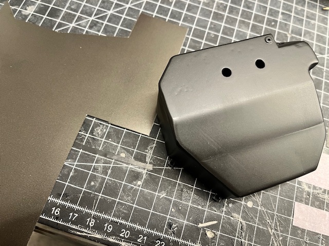

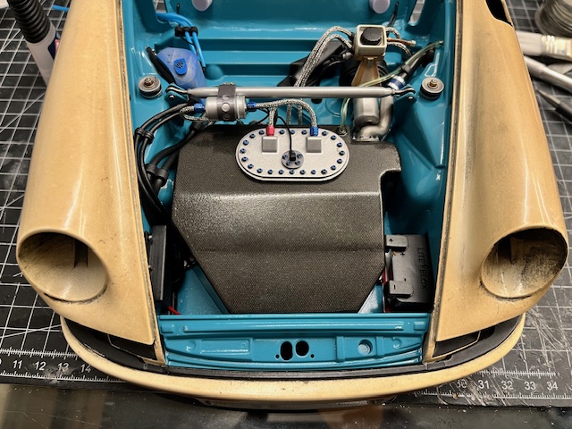

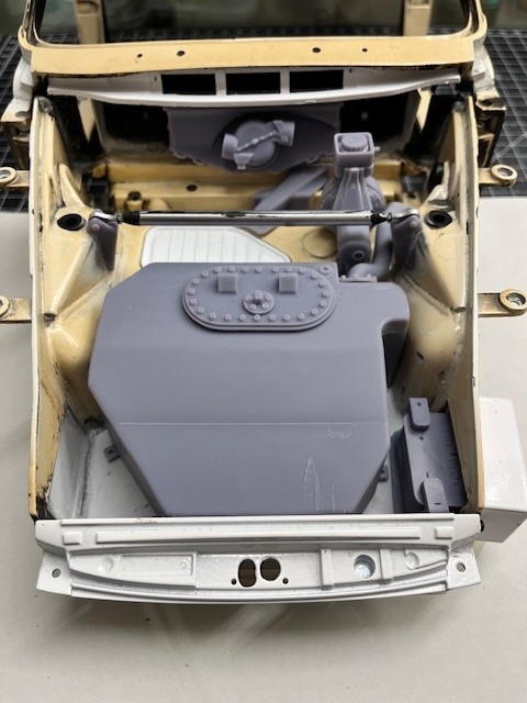

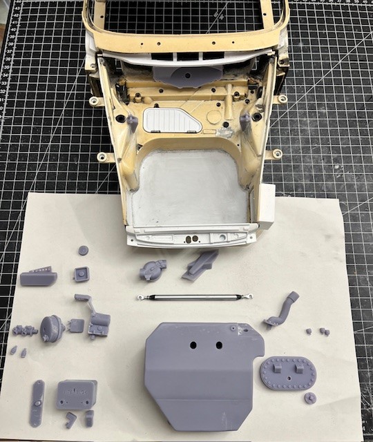

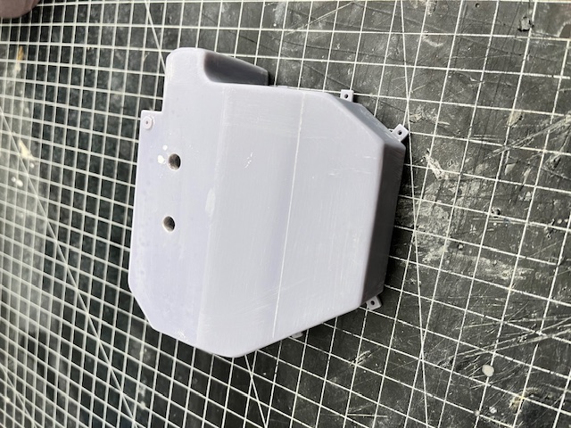

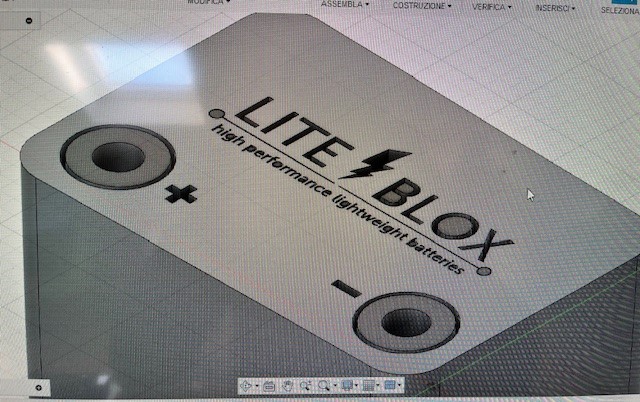

With the tank in place I had the reference for the battery measurements....wandering around the internet I found some ultra-light batteries from Lite Blox.
After drawing the battery I imported the vector to obtain the logo in low relief.
I then also designed the totally omitted steering column cover.
Once everything was printed I took a photo with the assembly of my personal TK....
DeA uses 12 files to compose this section.....I used 2.5 of them

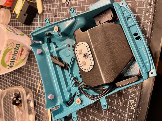

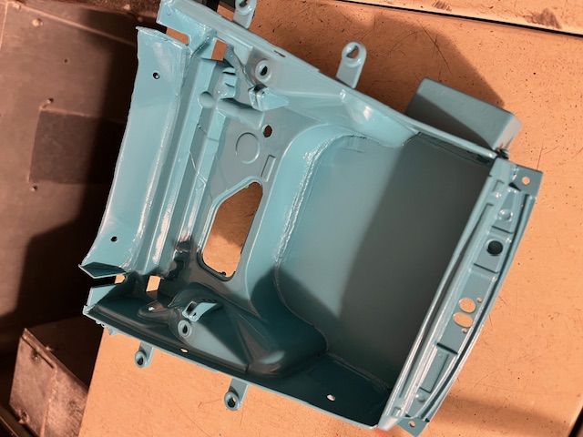

Having prepared the tank and battery with the usual 600 sanding process, then primer and two coats of matt black, I moved on to laying the carbon not before having created the templates.
I allowed the decals to dry completely for 24 hours and sealed everything with glossy clear coat
Finally, the tank compartment also received its "new skin"
frah2o
#164 Posted : 31 January 2024 14:19:12
Joined: 05/04/2016
Posts: 720
Points: 2,163
Location: Ferrara
I mimicked the glass water tank, I gave two coats of white, masked the upper part and painted the rest blue. I "dusted" the entire tank with the same blue to try to replicate the blue translucency of the upper part of the tank not reached by the liquid level.
Finally, always spraying from afar, I applied various layers of opaque transparent both to opaque and to give a classic textured effect of liquid glass tanks.
I then finished further mattifying with the Tamiya powders. The cap was then painted blue and applied to the tank.
I then continued with the coloring of the upper flange of the tank and the smaller flange of the float for the fuel level sender; once finished I mounted everything on the tank.
I created some cable glands and after painting them I fixed them to the sides of the front uprights
Finally mounted and connected the Lite Blox battery
frah2o
#165 Posted : 31 January 2024 14:22:26
Joined: 05/04/2016
Posts: 720
Points: 2,163
Location: Ferrara

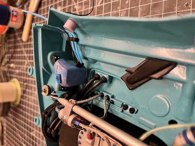

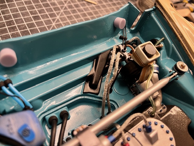

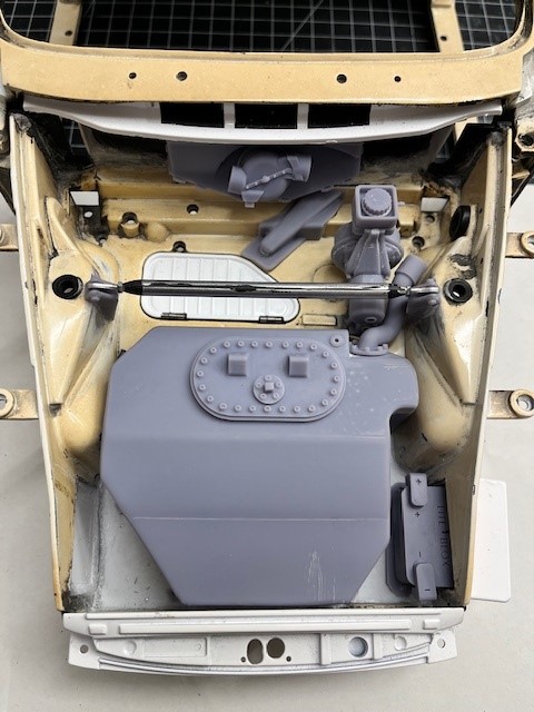

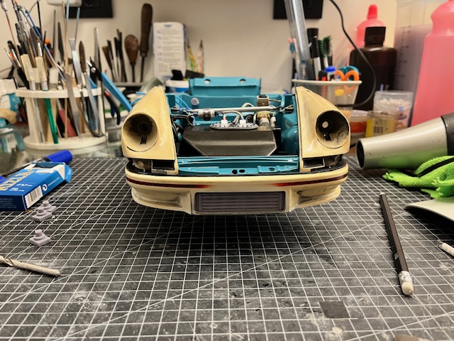

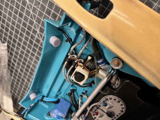

I'll continue with the assembly of all the various details and connections:
- Relay box positioned and front electrical wiring loom connected
- Connected the passage of the front oil cooler pipe
- Positioned the missing casing from the kit that covers the steering column
- The upper front suspension plates are mounted
- Mounted primary fuel pump on the struts bar and connected both the inlet and return supply pipes
- The fuel fill hose and the petrol vapor vent hose are mounted and connected
-Position the windshield washer tank with its bracket and connect the hoses to the pump. Hoses that in the future will connect to the nozzles located at the base of the windshield. Also connected is the electrical wiring that operates the windshield washer pump.
frah2o
#166 Posted : 31 January 2024 14:24:08
Joined: 05/04/2016
Posts: 720
Points: 2,163
Location: Ferrara
Last job to finish the front compartment: the brake booster-master cylinder assembly and brake fluid reservoir.
The tank was painted matt white and then I worked with Tamiya pigments to yellow it to mimic the color of the dot4
A light general wash is a bit of wheatereing and I placed the assembly in place.
Last job, I connected the hydraulic pipes and the braking circuit pressure sensors
I then mounted mudguards and bumpers to check that the bonnet closed without various impediments.

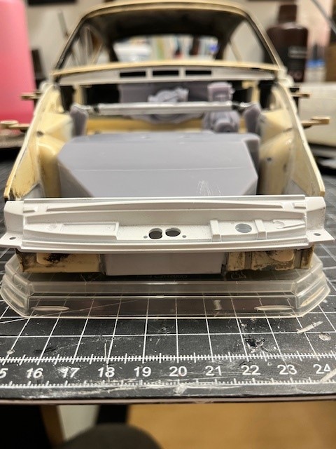

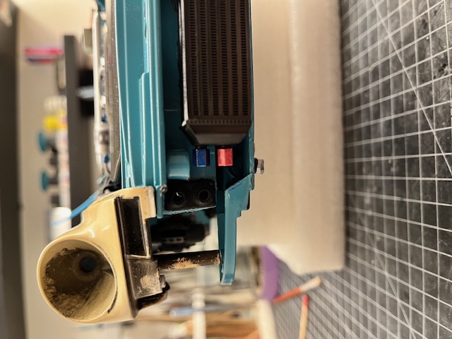

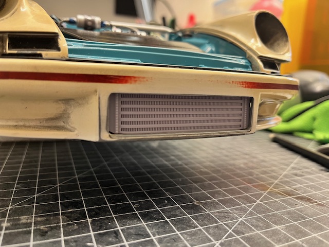

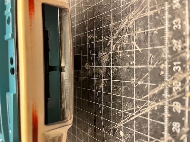

Once the fuel tank compartment was finished I concentrated on the front oil radiator.
From the intake on the bumper I found a lip in the middle which is part of the floor which is exactly in the middle of the area where the future radiator will be housed.
Turned on the dremel and removed the lip from the floor.
frah2o
#168 Posted : 31 January 2024 14:31:24
Joined: 05/04/2016
Posts: 720
Points: 2,163
Location: Ferrara

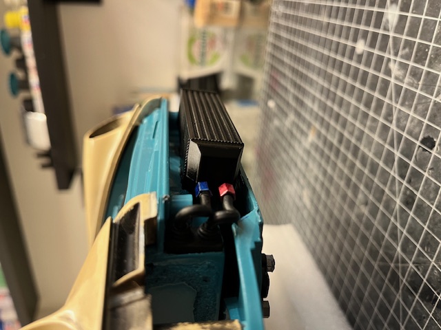

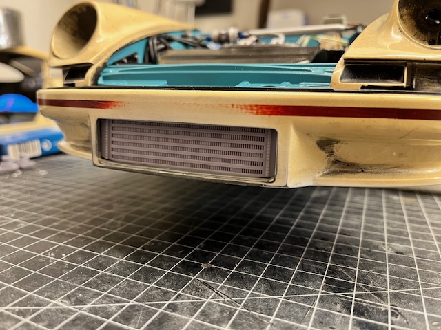

Taking inspiration from some 911 RSR Iroc, I created the radiator and tried my hand at welding for the first time.
I then also created the supports and drilled the radiator in various points in order to have various possibilities for positioning the supports
Once everything is assembled and in terms of dimensions and performance i'm quite happy
frah2o
#169 Posted : 31 January 2024 14:33:40
Joined: 05/04/2016
Posts: 720
Points: 2,163
Location: Ferrara

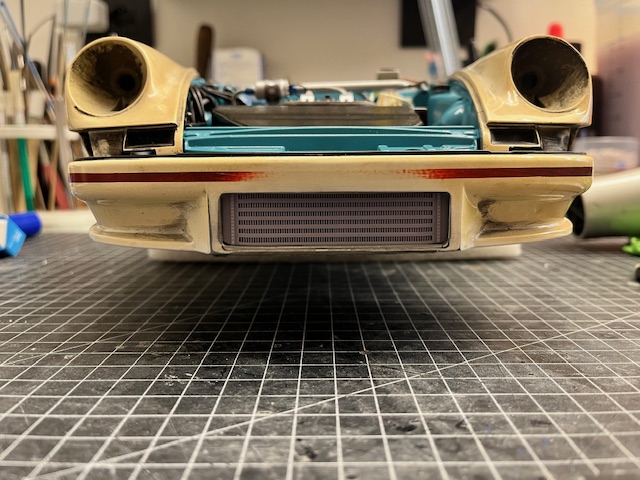

I painted The front oil radiator and the inlet and outlet joint
Even if everything will then be hidden and invisible I didn't feel like leaving him there without connection. I added a cable gland and connected the last part of the pipe which connects to the pipes previously mounted in the tank compartment.

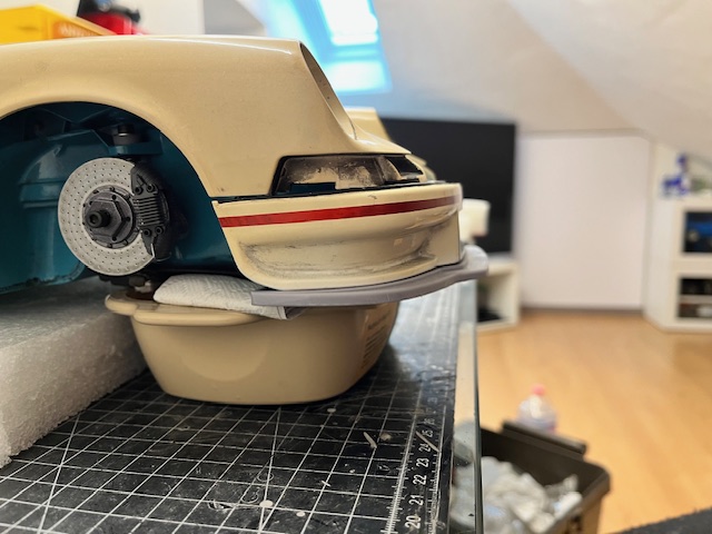

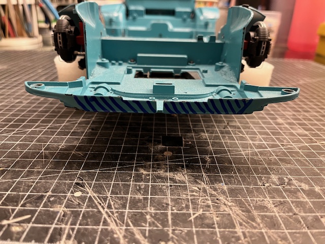

Before focusing on the last major macrogroup(the bodyshell), I already had a front splitter in my mind.
Before painting and with the risk of ruining it, I thought it best to put the worry out of my mind.
I imported the 1:1 scale profile of the area underneath the bumper and created the not too excessive splitter as a "sidewalk" and followed the original profile of the same bumper.
And with this I updated the work progress of my little 911

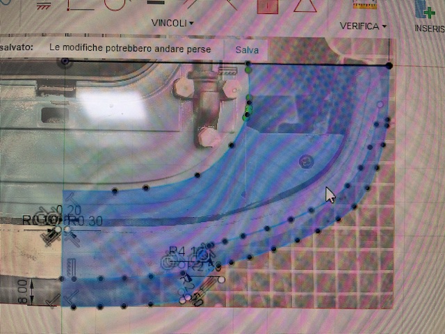

Once the splitter was finished I started thinking about fixed rear windows also known as quarter window
With the adoption of the IC I already had a forced air flow in mind that would always remember the rsr system.
I started the work by importing the graphic area on which to work and obtain the initial shape on which to then build the air intake: the fourth one was good.

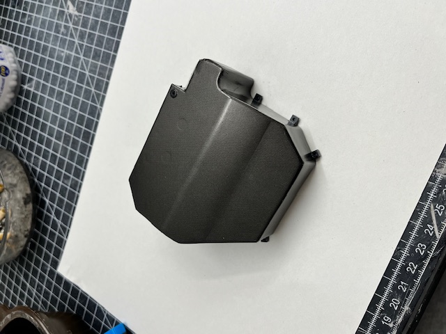

In my first idea of air intake system I had in mind to put the cone filter directly on the cold side turbo but it seemed too extreme and not very functional.
The RSR use an intake air flow system that I tried to replicate: periscope intake on the wing - duct - airbox and finally turbo.
I started from the periscope air intake that I positioned in the right side area of ​​the cooling grill.
As usual I imported the various graphic areas in fusion to have a direction to follow for shapes and curves.
I then continued to work on the duct with the airbox cover (which is the carbon air box of BMC-CDA) and finally the filter element.
The system works when the bonnet is closed; when it raise it the airbox remains in position, but the duct with the airbox cover is raised.
To work on the last components to connect to the turbo and get the measurements, i dry fixxed the CDA airbox with its duct to the air intake scope.
frah2o
#180 Posted : 26 February 2024 10:42:45
Joined: 05/04/2016
Posts: 720
Points: 2,163
Location: Ferrara
As a first attempt I was getting closer to what I set out to do.
I worked on the coupling between the pipe with cover and the CDA to align the CDA with the turbo flange so as to be able to work on a hose with a single 90° bend without having to create double curves with overly complicated trajectories in such a small space.
Once I found the right inclination I went ahead designing the sleeve on the turbo, the connection flange between the turbo sleeve and the airbox pipe and finally the airbox pipe itself.
I printed, dry mounted and everything came back as I had imagined.
Airbox now is fixxed with the turbo..
With the hood down, everything is connected. When the bonnet is raised only the air intake duct separates.
