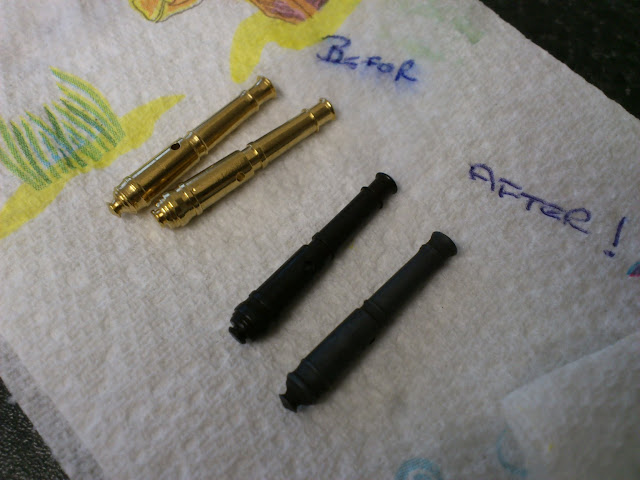

Confused Hi All, Here Some of my Cannon's Not sure if there black enough Confused
Anybody got any comments What do you think as you've done yours.

Hi Robert I am not building the Surprise, but I would be proud to have them aboard my builds any timeBigGrin I think you have done a cracking jobBigGrin keep up the good workThumpUp Regards MikeCool

hi rob, i think they look terrific and i am definately going to do mine same as.Painting would have taken out some detail but this stuff is awesome. Is it permanent or does it rub off to highlite detail of any discription and what is it called.

Hi thanks moriarty, after cleaning the brass cannon's (degreasing them etc) I dipped them in the Carr's solution for about 45 Seconds.
I then neutralised them in Water (think you should use the proper neutralizing solution though} let them dry and, All the cannon's you see are what they look like after I rubbed the soft residue off with my fingers lol, Could of used a tissue.
Rob
Bridlington.

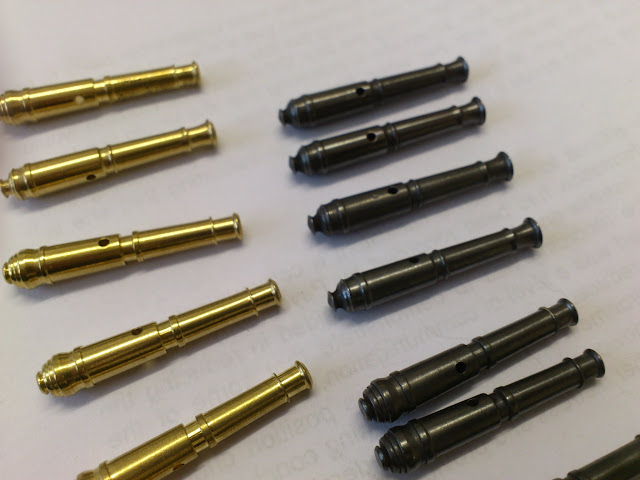

It's A shame we have to Finnish off the cannons ourselves, Bras Wire in and Soldered and all Blackened, will have to paint the pins as there Not Bras,Cursing its not finished yet, going to finish this one then copy the rest off that one.LOL

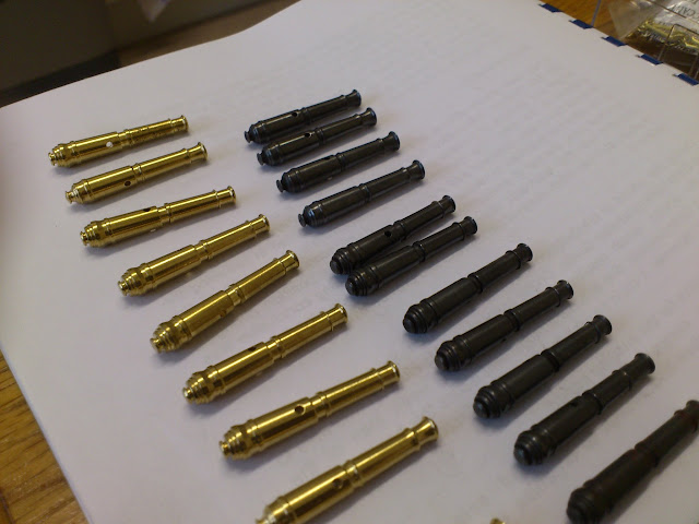

Different Stages. but still not complete
