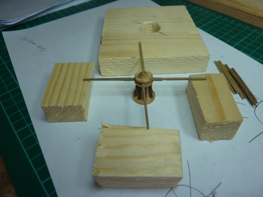

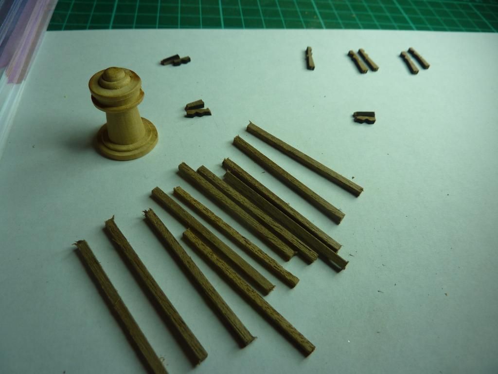

Next its on to the windlass, I detached the timbers from the card, but when trying to seperate them I broke 5 of them.
I got all the bits required together.
I repaired the bits that broke and glued the timber on to the windlass.

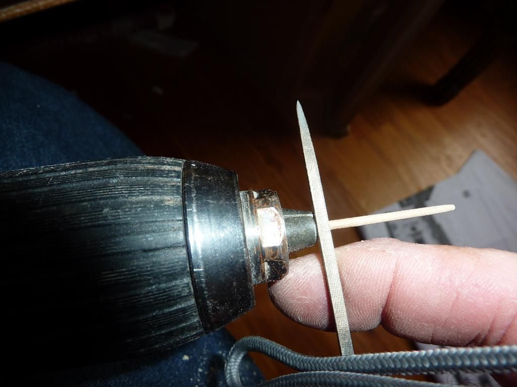

I then had to try and make the handles for the windlass, all 12 of them. I cut the timbers to lenght, 45mm I think, I then marked 10mm in from the end, I then put this in the chuck of my power driver, with the pencil mark on the end of the chuck jaws,
Then I sanded the taper, thiner to the outside point, ( Watch the friction burns to your fingers. )
I then used a file, hard against the jaws of the chuck, to form the joint between the round section and the square section of the handle.

I used a file hard against the jaws of the chuck to form the joint between the round section and the square section.

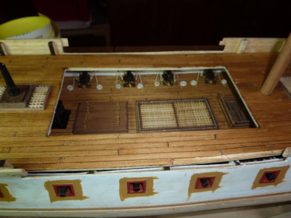

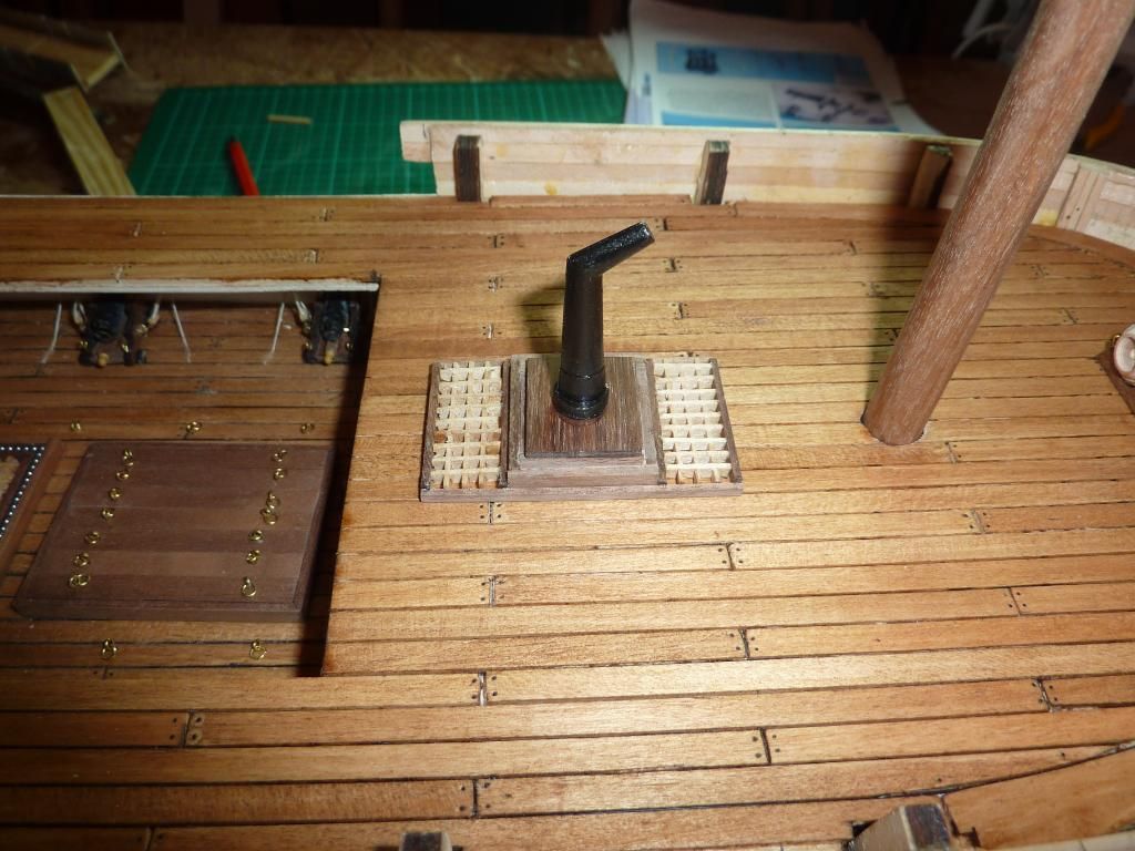

And the finished windlass on the deck

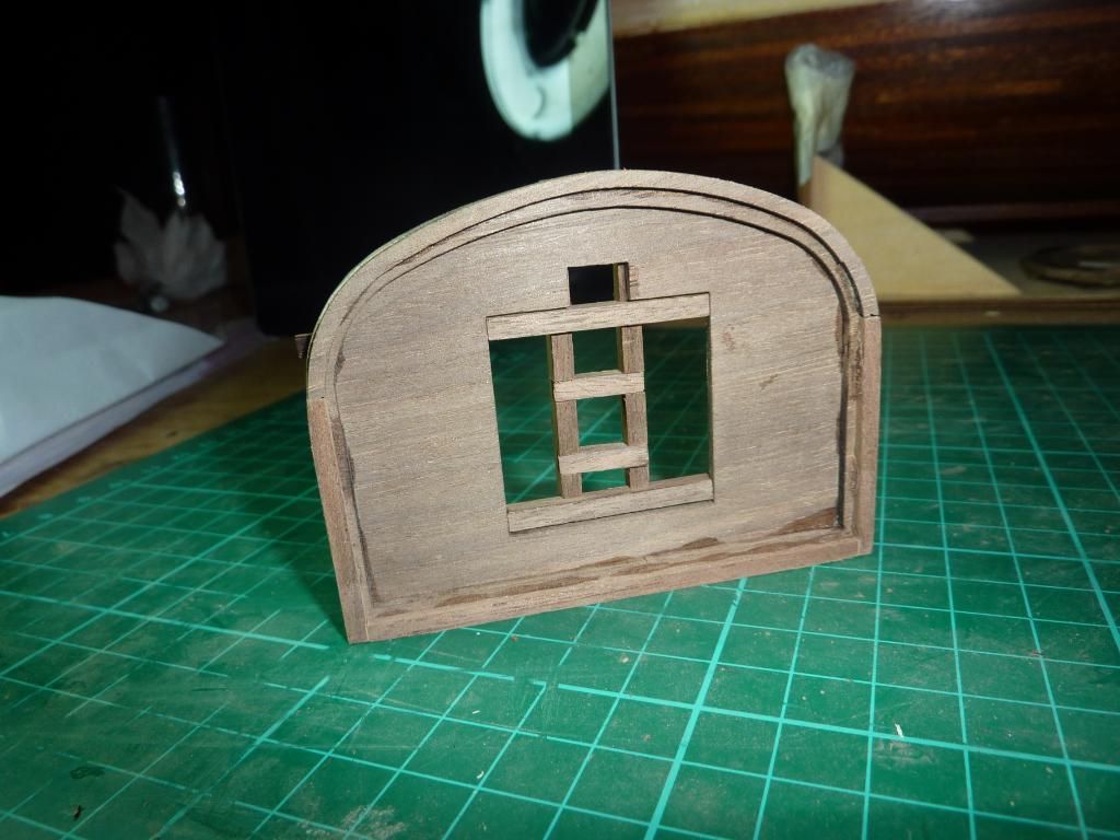

I have made the barrel's and their cradel, I found I had to enlarge the size of the curved bit of the cradel, as the barells were touching each other and not sitting properly, I did this with the sanding drum in the dremmel.

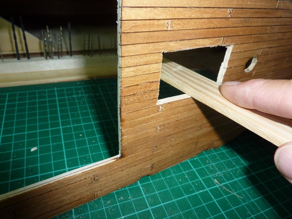

Next I wanted to get the hole bored in the bow of the ship for the bowsprit, I wanted to get this done before I fix the top deck to the hull. I made a ply template of the drawing to get the angle right.
I then bored a 10 mm hole in the bow to take the bowsprit, and used the ply template to make sure the hole was at the correct angle.
Then its on to the rings and eyes on the lower deck, I used masking tape stuck to the deck to get the correct position before boring for the eyes. Very fiddly trying to get the rings through the eyes.
My next task is to make the grateings for the top deck, again very fiddly assembling this item.
All in all, all very happy with my first real attempt at building a model,

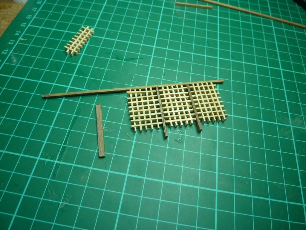

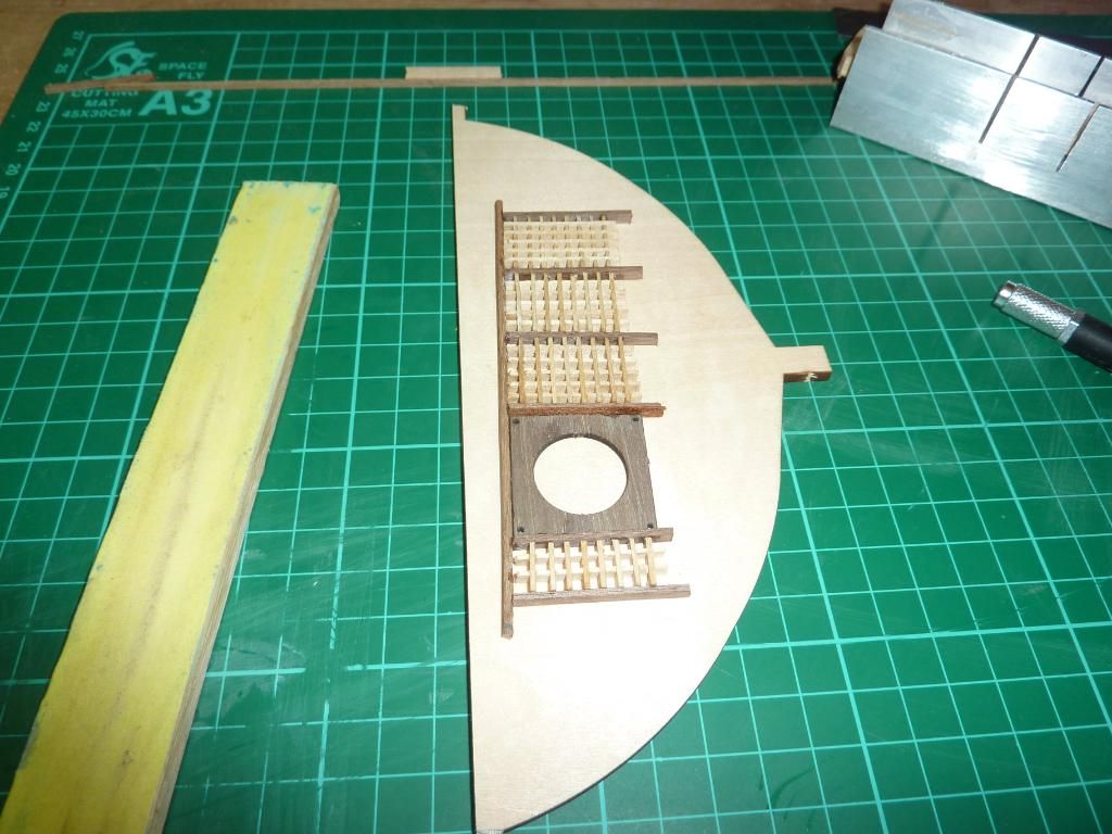

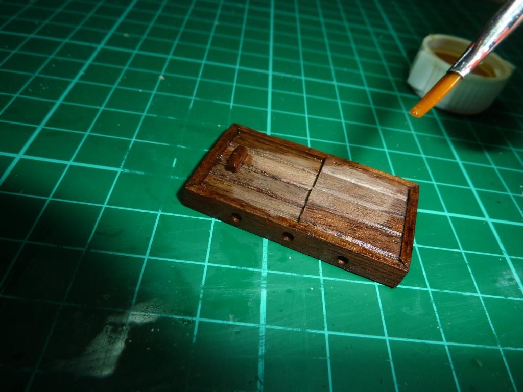

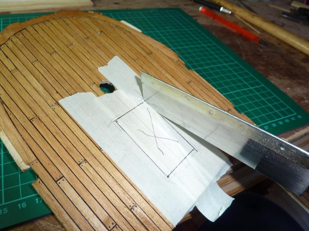

Next on the list is the grating and base for the windlass.
The base for the windlass, on page 32 of the instruction it tells you to use walnut battens to form the base, but on page 35 it tells you there is a base supplied with the kit, I opted to use the base supplied. I cut out the center piece for the windlass to sit in, But thinking about it I should have left it in, because after you cut the hole in the deck the windlass will fall through, as you hev cut the floor out, So I have glued it back in.

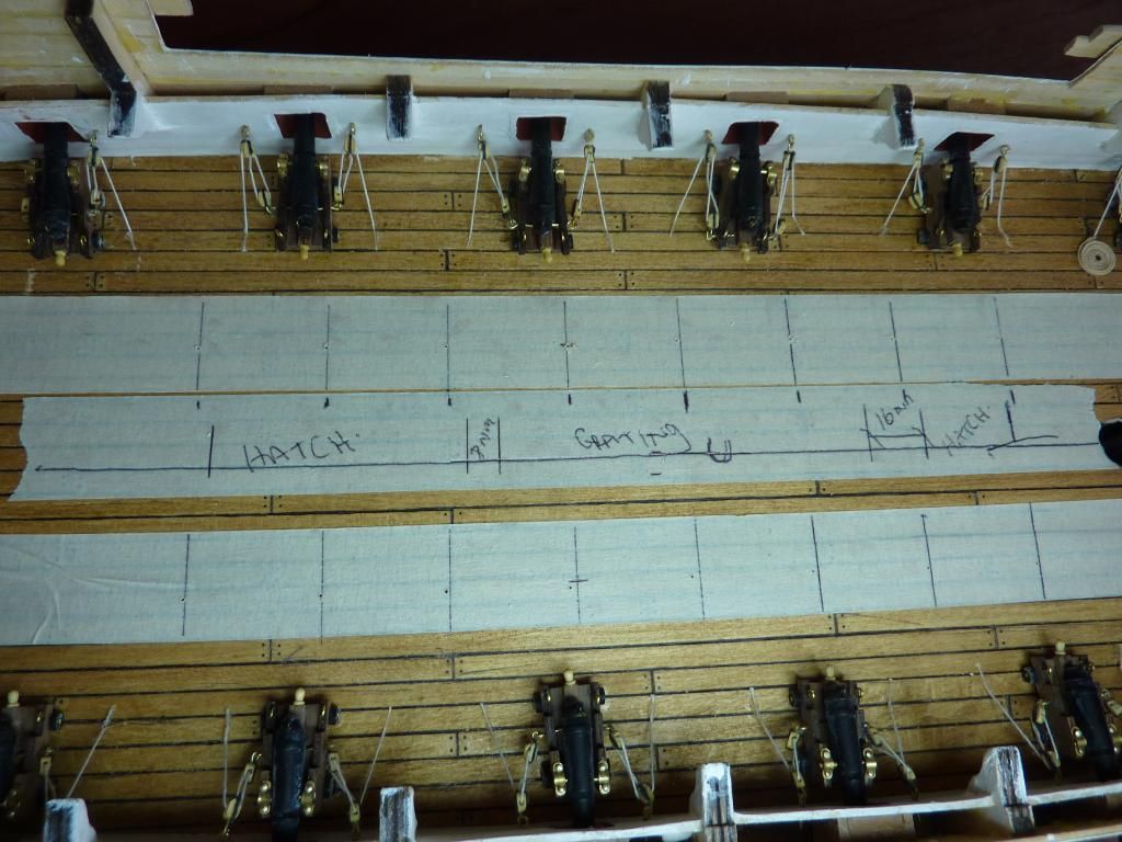

Once complete, its time to mark out the deck, again I used masking tape, and positioned the gratings and marked round them with a pencil, I then bored holes through the deck in the inside corners of the gratings, this will give me the required corners for the cut out, allowing a 2mm margin for the parts to sit on.
All I have to do now is get 4 brass pins for the corners of the windlass base.

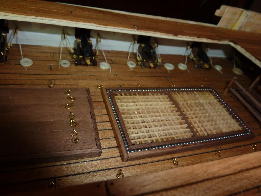

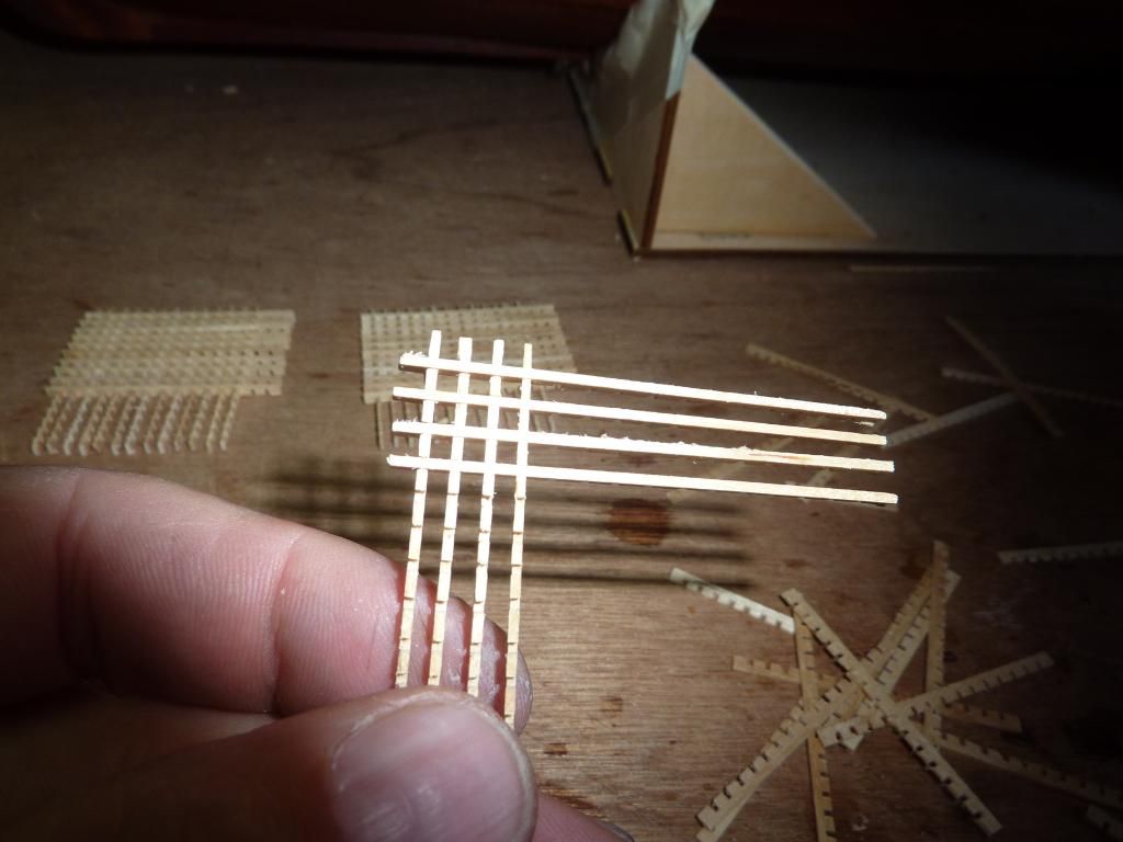

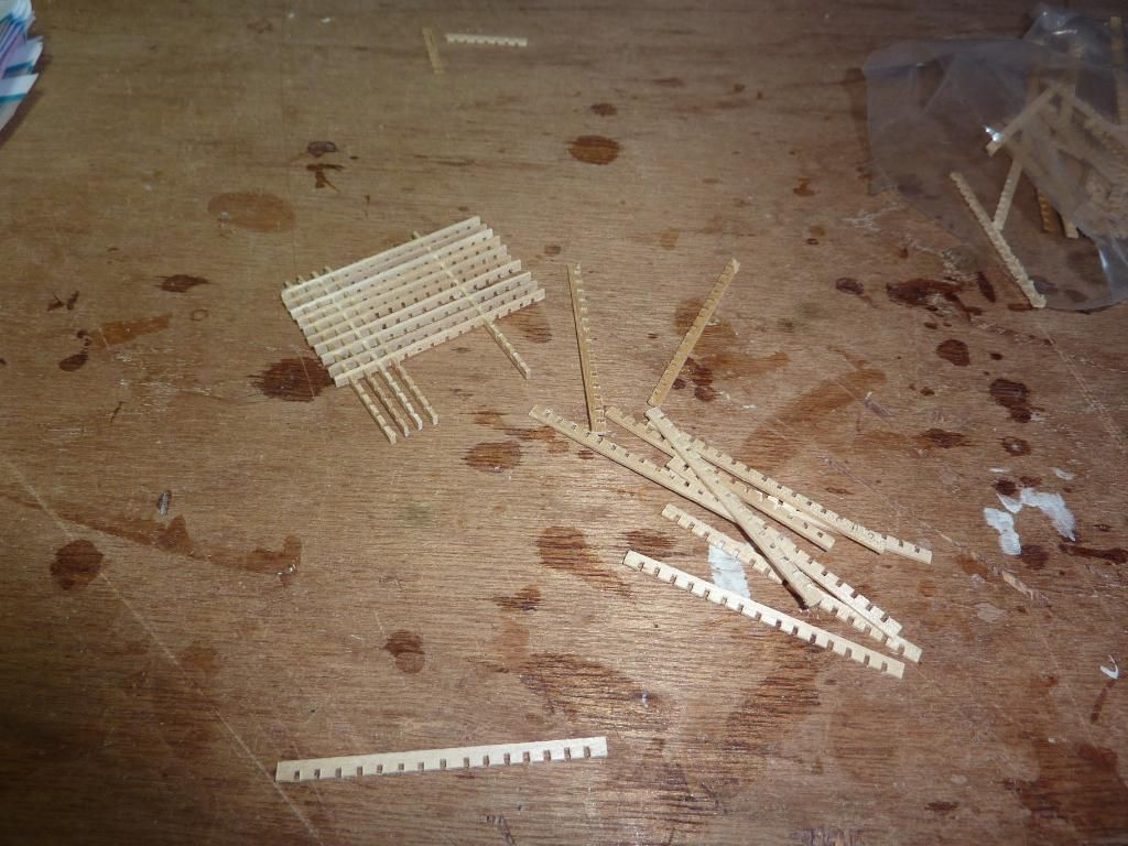

Just about there with the deck furniture, I have now rounded the gratings as per the instructions, and they look good and feel very smooth,

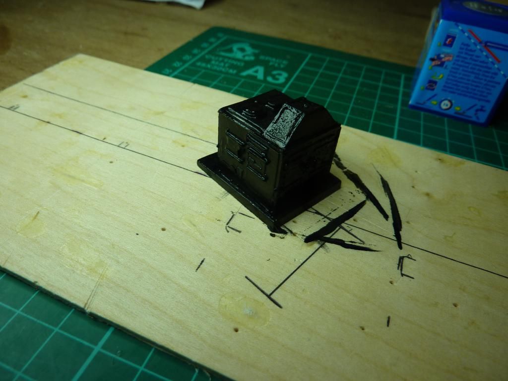

I am going to leave the pin rails till later, I am now trying to finish the lower deck so as I can get the top deck fixed in place and do the bulwarks to the top deck. I have also painted the stove with a second coat of black paint, once dry I with give a light ghosting with silver paint to highlight some of the area's.

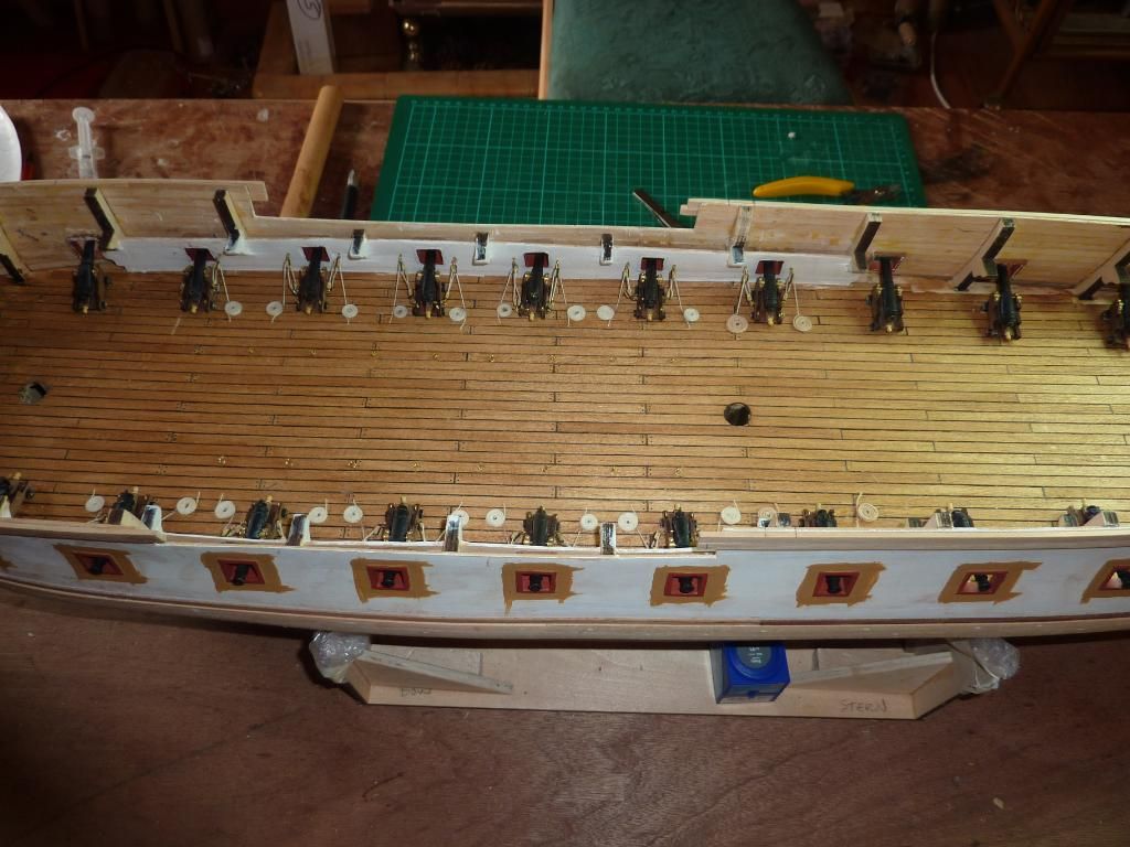

Got a bit more done now,I have been busy making the rope coils for the lower deck, Not all that happy with them, but not bad for a first attempt.I have not got them lining through very straight, I should have taken more care when fixing the rope from the cannon blocks to the deck, as this has dictated to me the line of the rope coils on the deck.

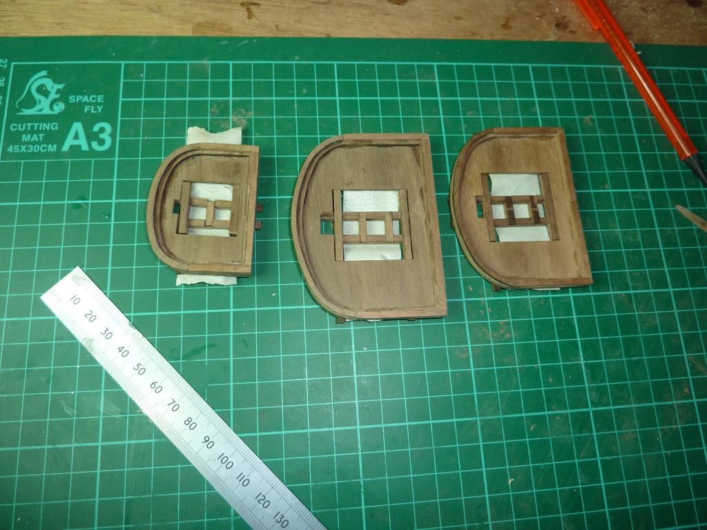

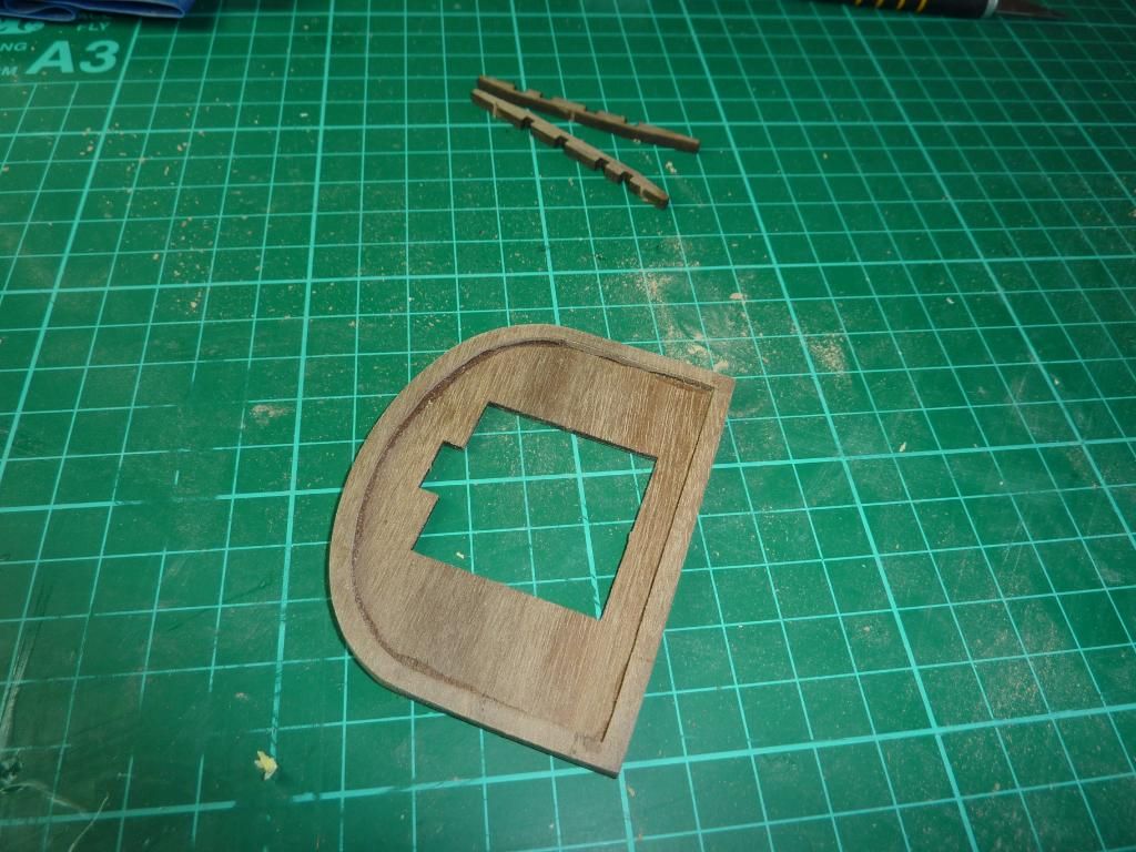

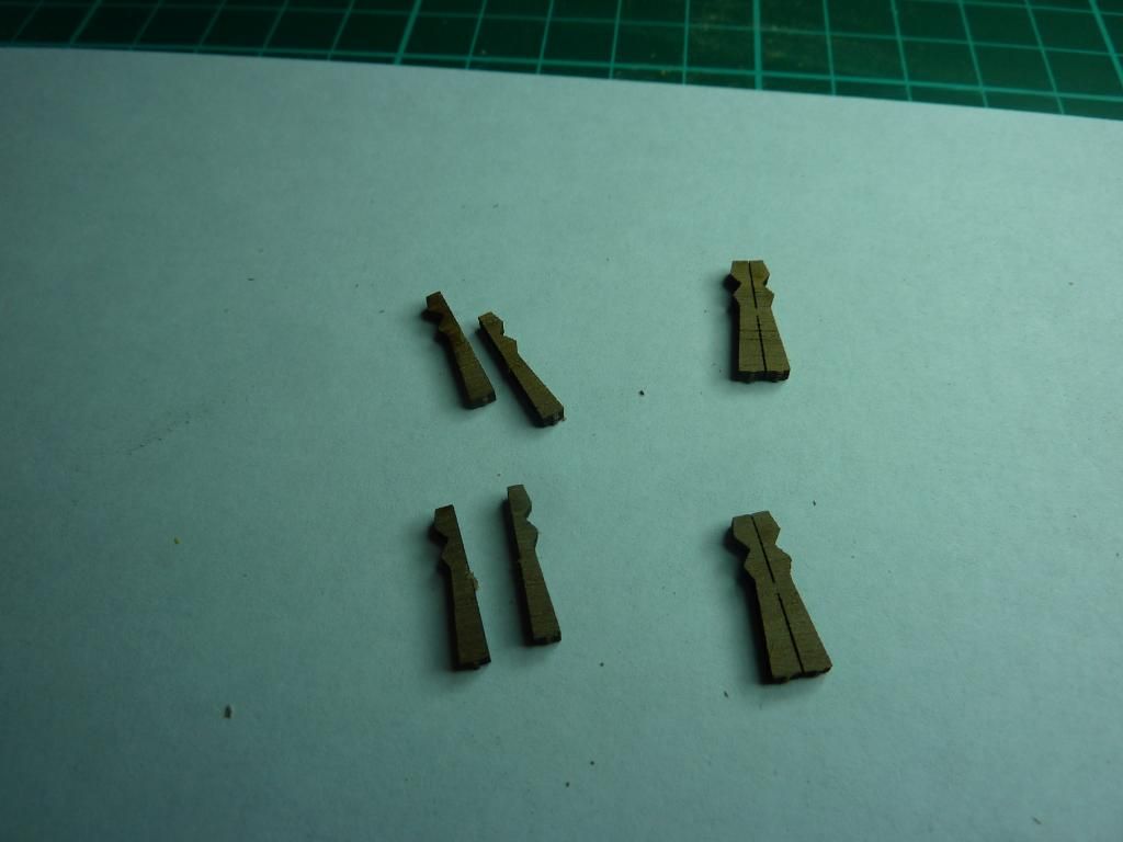

Its been work work busy busy chop chop bang bang in the boatyard today, First of all I made the last cut out on the top deck foe the grating , the one with the chimney in it.
I then gave all the deck furniture, on both decks a Coat of danish oil, It makes quite a differance, brings the colour out of the wood,

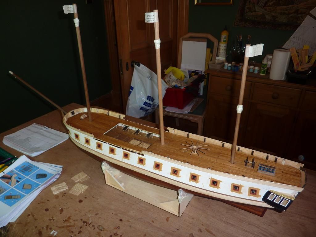

I have been looking at the mast drawing's lately, my big problem is I don't have a full size 1 : 1 scale drawing. The disc I got with the kit has the drawing's on it, but I have been to 2 copying shops and no one can do a full size 1 : 1 drawing. I have sent a pm to admin for there advice. If any one can help I would really apprieciate it.
I have started on the crows nest's
Quite a bit of work involved here, sanding and fileing to get things all fitting properly. I have not glued the cross rails together yet as I need to check the sizes, I will be giving all the timber a coat of Danish oil eventually.
Over and out for now.

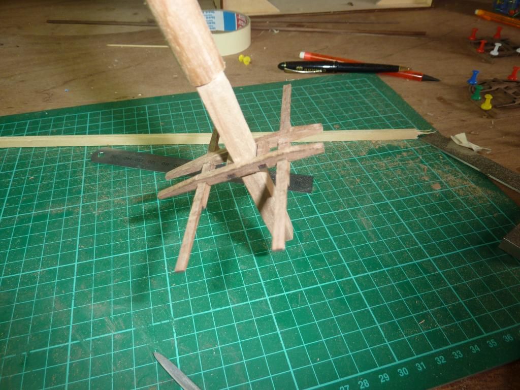

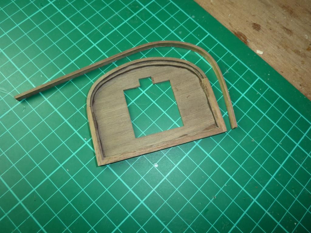

Around the crow's nest and foretops I have to bend a piece of 5mm x 2mm walnut, some very sharp turns here, I did the first one with the electric plank bender, then clamped it in place.
But to be honest I found it a lot easier just putting the walnut in hot water for an hour or so, and it bent round the profile no bother at all, I then pinned everything in place for 24 hours, then I will glue in place tomorrow.

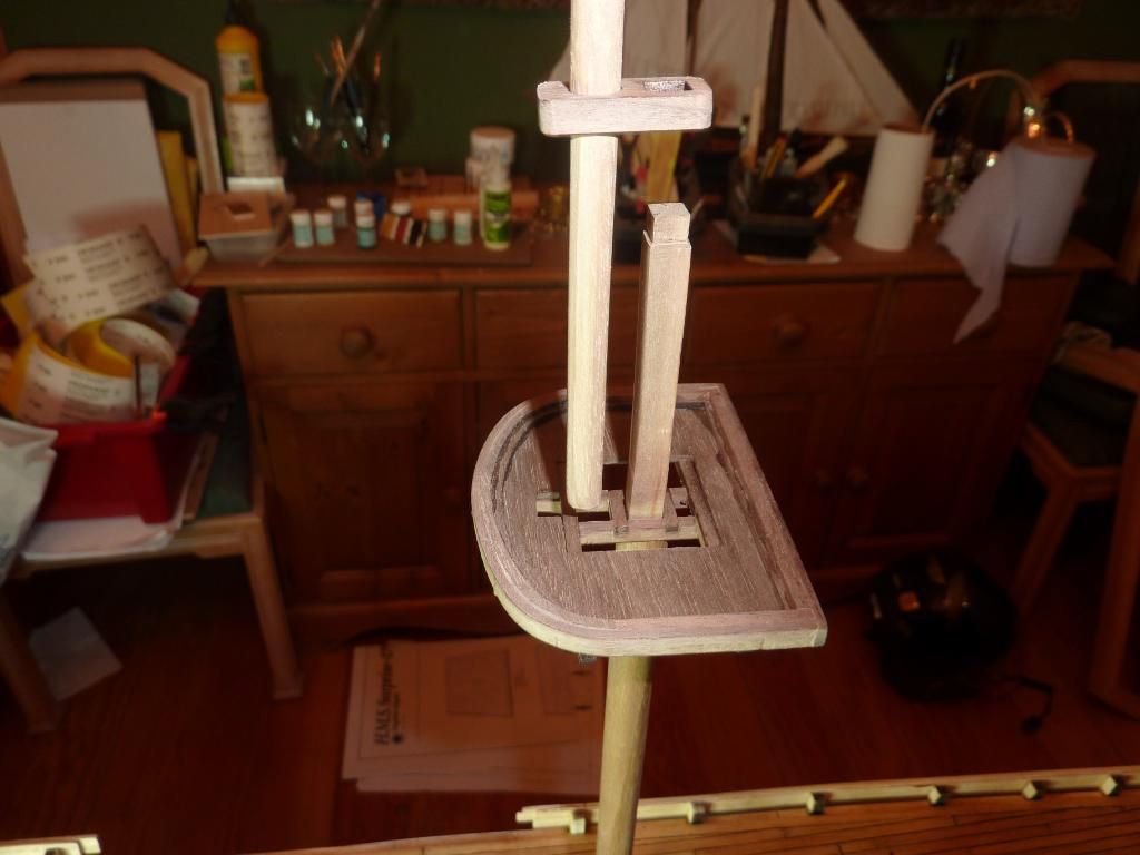

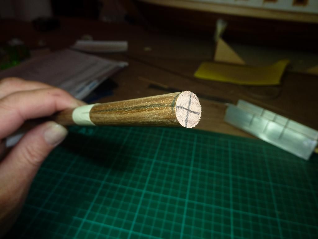

I am doing a lot of things in the wrong order, I am on the masts before I have finished the lower deck, But I was worried I did not have the skills to do the masts, with all that tapering and changing from round to square half way up the masts, so it was something I just had to do, I have done the lower main mast and dry fitted the foretop and I am happy with the out come.
This is how I marked the four corners, to change from round to square.
I then filed the dowel to the lines, this gave me a square profile, I kept checking the size against the hole in the foretop timbers, until the square section fitted the foretop.
I have also shaped the middle section of the main mast, into a hexagonal section and dry fitted it to the main mast.
I can now relax knowing that I am able to do the work to the masts, I will carry on and take all 3 masts up to the same level.
