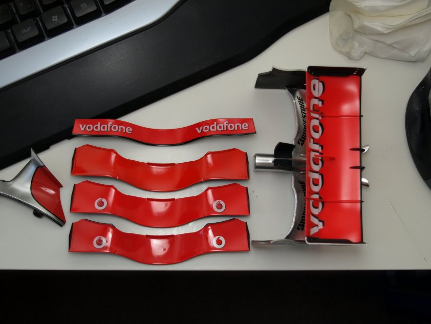

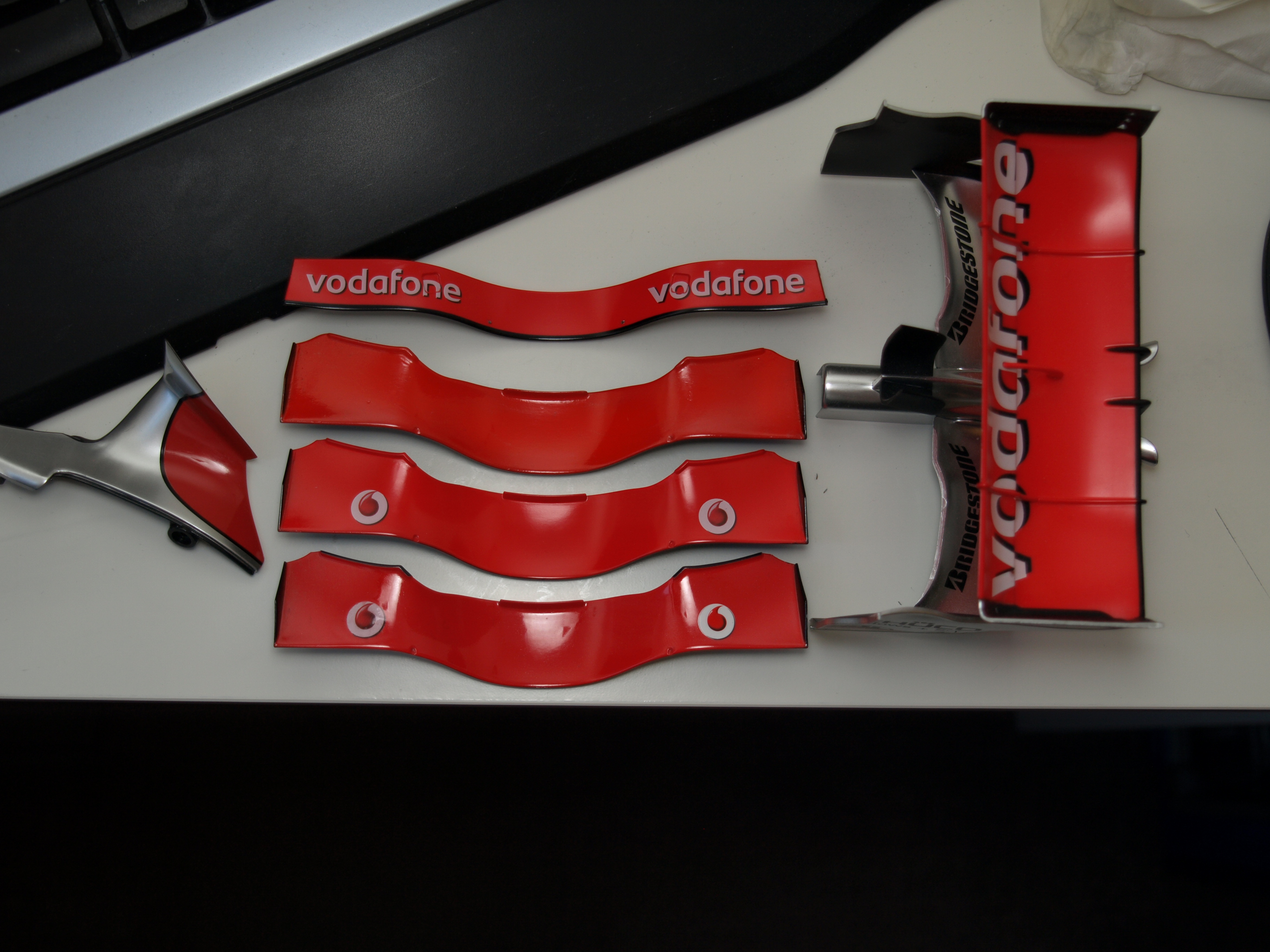

Ok... here is a picture of the front wings with different types of finishes..
The top one with the Voda logo's has been done with "Klear" (formaly Johnsons but now by "Pledge") This has about 10 coats to achieve the finish..
The Second one down is the wing painted with "Zero paints MP4 Red" with a coat of Halfords Clear coat..
Next is the "Original" part with 10 coats of "Klear"
And last is the "Original" with a coat of Halfords Clear....
Beside is the rear wing "Untreated" to give a comparison along side the Pods... I could give you my thouths on those but if I do then... well thats a different ball game Blushing
I will attempt to put up a small video on utubebookface thingy showing how to do the "Klear"... It really is simple as "Bigmal" will tell you.. He is the "God" when it comes to this stuff lol

spencer, cheers for putting pics up. what do you think to the finish with the halfords clear?? is it any good as thats what im going to be using on mine as i did with the suspension parts.

Hi, from looking at the pictures above, the best colour match and shine seems to be the Halfords clear coat to me.
Does anyone else agree?
Also, how easy is it to do? And is it spray or brush on?
Thanks
Ian

Hi Ian... It's a spray can but used for cars so if you do go down this route then I suggest light coats in a well ventilated room with no dust.. one light coat from about 7 inches away then 2 mins later another... should be ok after that... you could then T-Cut the finish to get a good shine but if you have had no experience with either then just do a few coats as suggested... One other thing is to only do the RED wings... you must dismantel them because if you get any on the "Chrome" effect it will destroy it...
Spencer

Hi Scott... The Halfords clear is fine and gives a good finish but see my reply about light coats above... You've done the suspension arms so you should know about the light coats to get the bet finish etc..

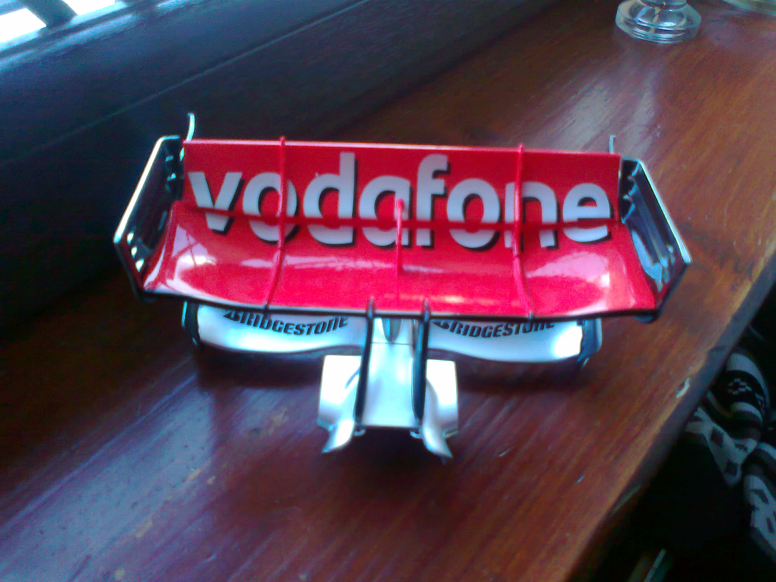

bit of advice all DON'T use acrilic spray just a clear gloss spray you get a better finish have a look at mine pic i put on earlier in a different post on this matter page 8 post 160Mellow
