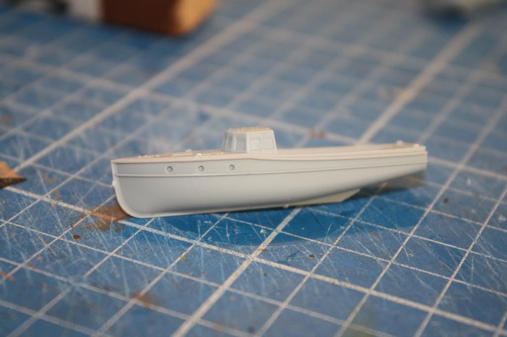

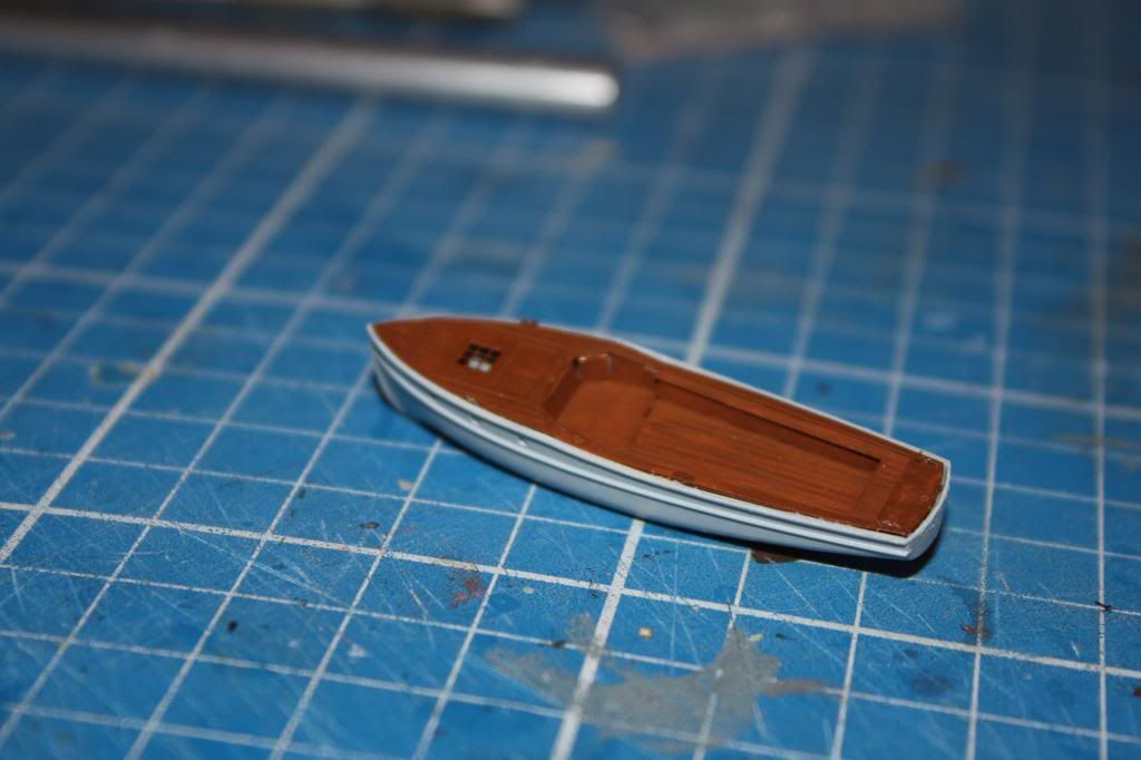

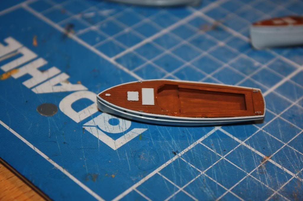

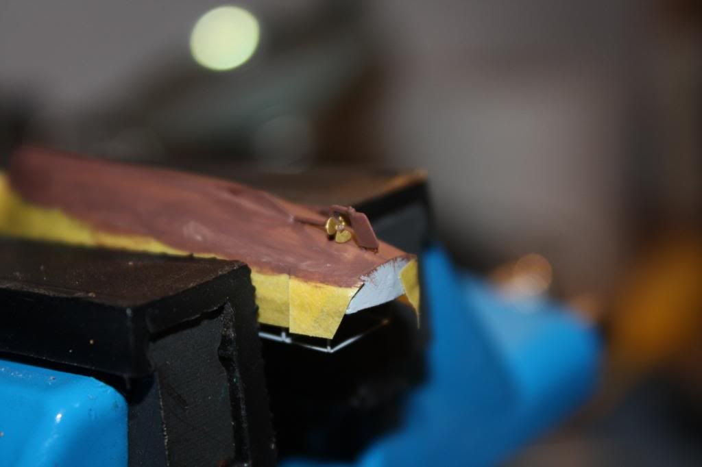

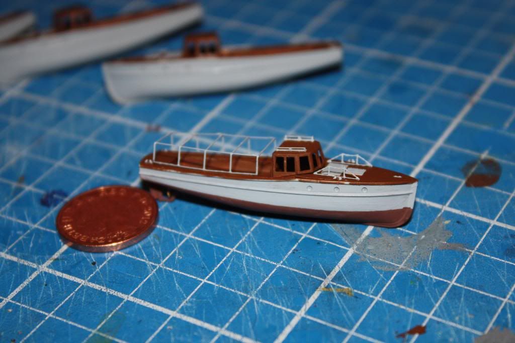

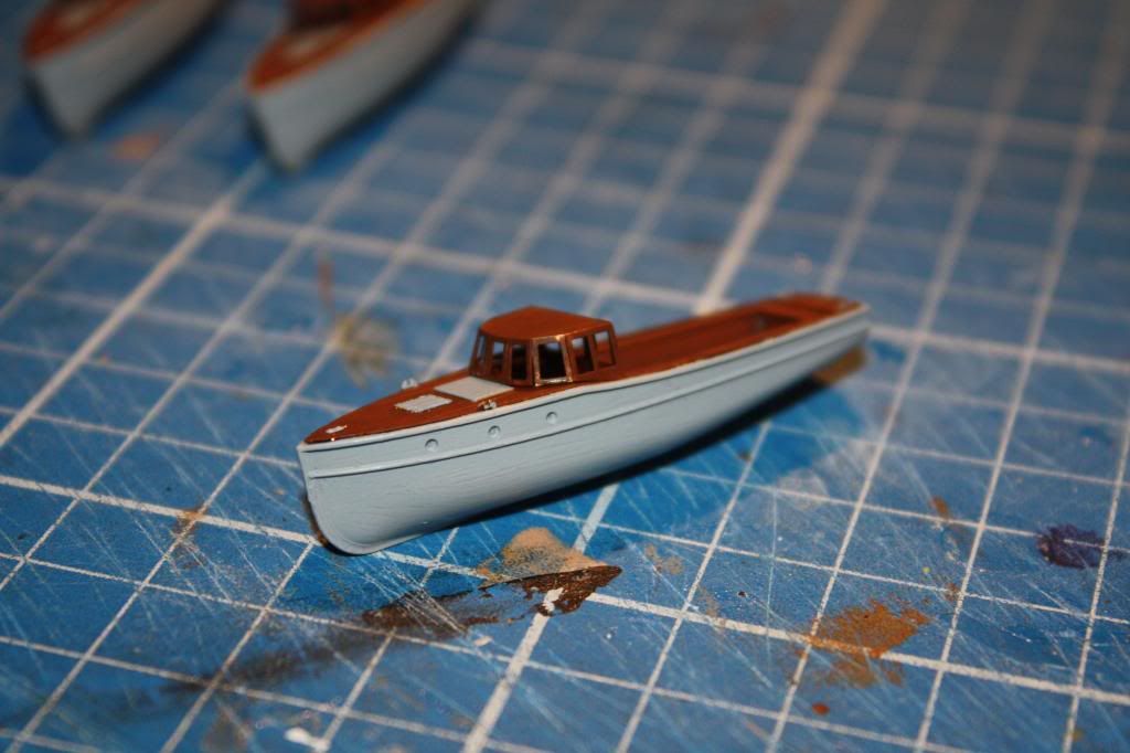

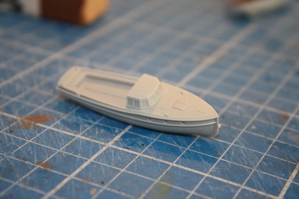

11 Meter Launch
Total build time 63 hours
Whilst i am waiting for more etch to be delivered I decided to make a start on the ships boats. The 11m Launch comes as a 4 pice in the kit. I have seen some uncomplimentary comments on the web about these but i don't agree, i think they could paint up rather nicely. The MK1 upgrade set however is an improvement replacing the top of the boat with 19 etch pieces. I used the kit supplied etch propeller as it is thicker and easer to form the blade angles. I chose to paint the etch on the fret before building, not essential to do that although you will need to paint the inside of the cabin prior to fitting. The hull and steel work are all the same grey as the superstructure i have used WEM colour coat U.S Navy Mahogany Flight Deck Stain for al the wood work and Schiffsbodenfarbe Rot 5 for the lower hull leaving the propeller in Brass.
The Ships boats should all be lashed down with a combination of webbing and chain - may have to play with scratch building that as nothing in the etch sets so far. The two flag staffs will be added when the boats are fitted to prevent any damage.
As always any Constructive comments greatly appreciated Cool

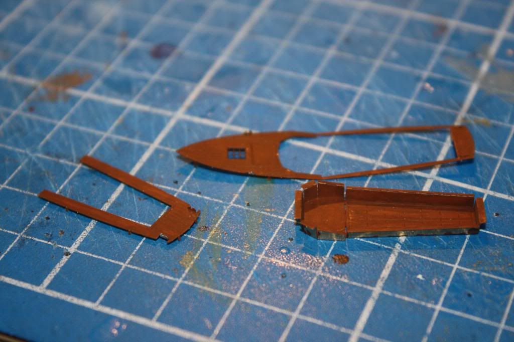

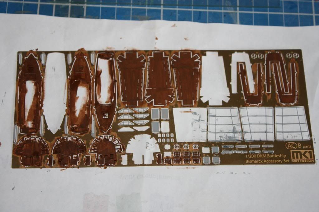

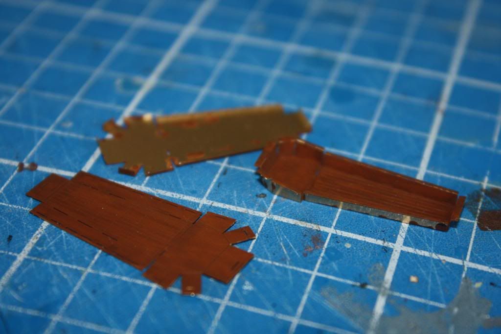

All depends on the application and the etch. I use Humbrol number 1 grey primer for enamel paint as a rule but only on larger small parts if that makes senseLaugh . smaller parts with fine detail i tend to just paint without priming so i don't lose the detail. if the etch is part of a larger construction then I may prime the whole thing in one go I use Halfords white primer for that, but again may add the finer detail later. In the last few years I have moved away from Acrylic paints, although you can get a more even brushed surface and they are less noxious there not as hardy and i have had problems with thinning and multi coating, I find they clog more easy, my way of working is to paint components before assembling. I tend to spend a moment planning the build of each sub assembly and decide what is being painted when and if I will prime or not. Generally i find there is less need to prime enamel paints that are more hardy than acrylics .
I did not prime the ships boats at all, usually I would have primed the deck parts and not the smaller detail. This time however I wanted the brass to come through the thinned paint a little to give a wood type depth which I think worked well, The deck paint was quite thin so had three coats thinned at 6 parts paint to 1 part thinner. the reveal (grey) paint has a much higher viscosity so was thinned at 2 parts to 1 and only needed two coats.
Hope that helps
J

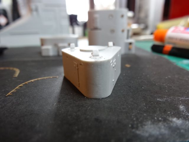

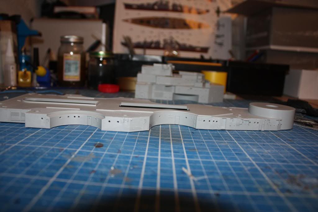

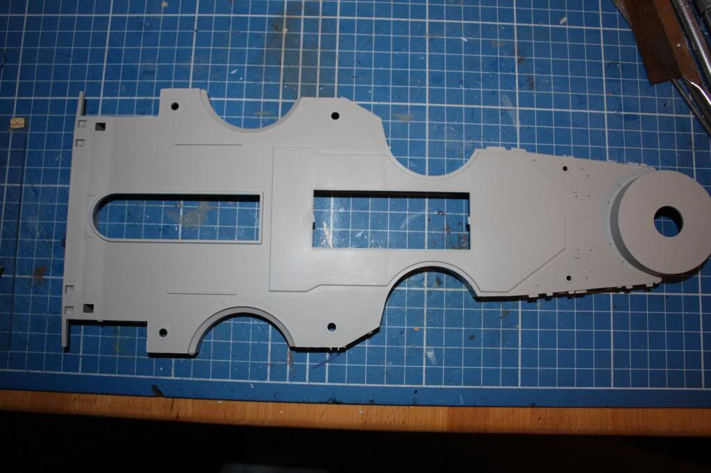

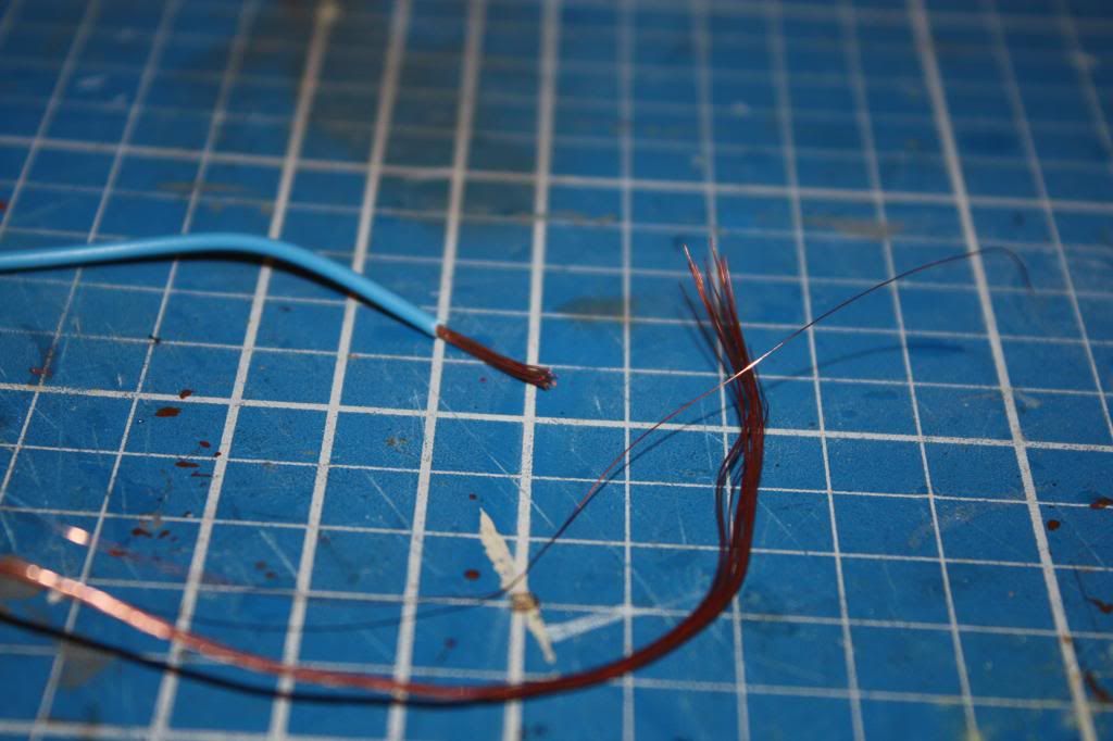

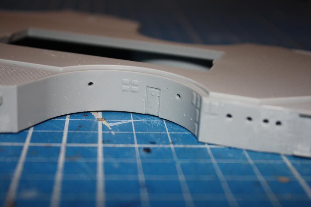

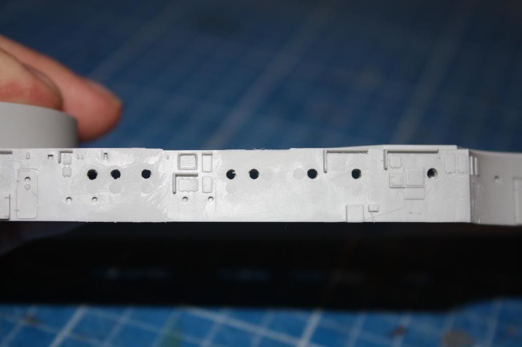

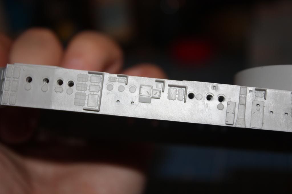

Lower forward superstructure preparation.
Total build time 66.5hours
Started preparing the superstructure in preparation for adding the etch and some scratch built detail. Scuttles have been drilled out and the covers removed. most of the vents and covers have also been removed. i have left the doors on for now but i do have replacement etch doors on their way from Germany, but I will wait to see how many I have first before i remove the moulded ones BigGrin I have also removed some of the deck that will be replaced by the Eduard etch where it overhangs the superstructure.
I have also striped down some scrap electrical cable ready to add some of the missing cabling. Once i have some clearer plans and my remaining etch arrives I can start to put this together.
#178 Posted : 11 April 2013 09:43:22

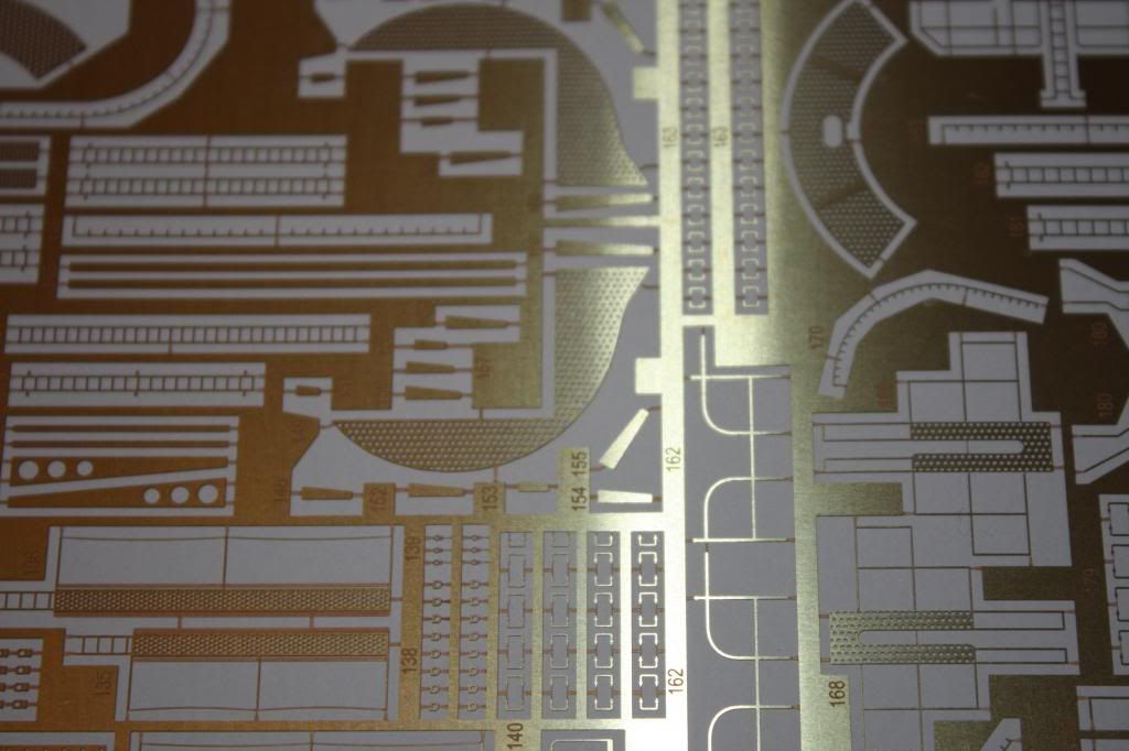

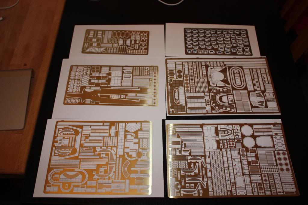

Bit like Christmas today received my delivery of plasticard, strip and rod ready for some scratch building and I received 4 sets of eduard etch.ThumpUp
There is plenty of aditional bits that will compliment the MK1 set and some duplication. of the duplicats some are nicer detail others not. the etch is much thiner and therfore more delicat than the trumpeter and MK1 etch, and some very fine detail indeedHuh Mellow . oh and som figures!! going to reserve judgment they are pre painted and i probably wont use them but we will see.
