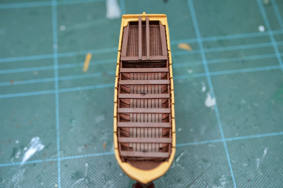

Have made the thwarts from 0.75 X 2.5 mm styrene strip and temporarily laid in place.
The mast brackets were made from thin copper strip, cut down to 0.75mm wide and bent to shape.

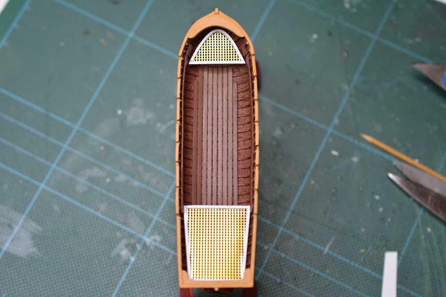

Well, the PE parts arrived from Germany this morning (Saturday) and among them was the sheet of gratings I had ordered for the ships boats.
There are four sizes on the sheet, starting at the bottom of the photo above with 1mm square
then 0.75mm, 0.5mm and 0.4mm.
For the boats I wanted the 0.5mm grating and cut it to shape using templates made from thin card to get the internal shape of the hull. Once I hade cut the grating, I made and the edging from 1mm X 0.5mm styrene strip, glued it to the grating and tried a test fit.
After a couple of coats of paint, they were ready to be fixed permanently.
Next I painted and fixed the thwarts that I had made earlier, plus the port and starboard ones at the stern.
Next I will make the rear davit and the central windlass.

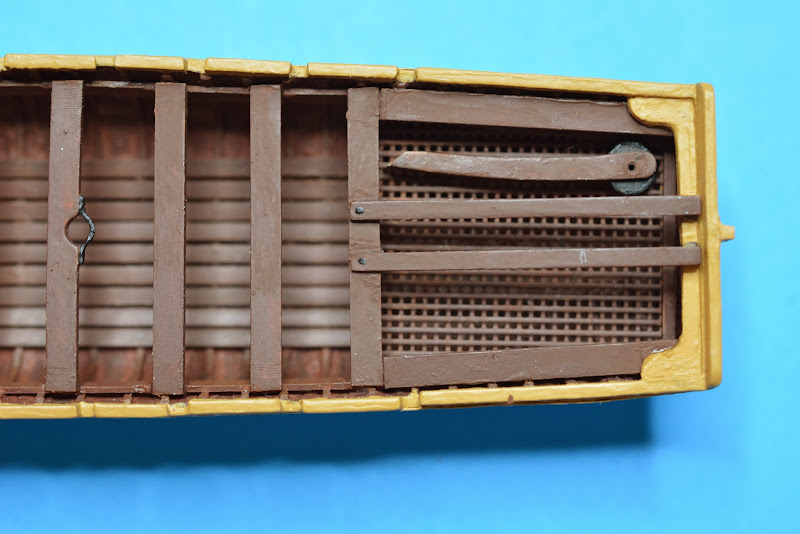

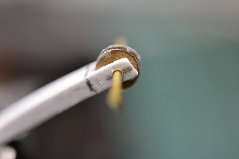

More on the launch. I have spent tonight making the stern davit.
Started with a piece of 2.5mm square styrene and filed to shape.
For the pulley I used some small plastic discs,
I think they are sequins, we were clearing out some cupboards and drawers the other week and found these in a box of buttons etc, I think they were my late mother in law's and my daughters used to play with them,
I immediately ear marked them for the pulleys on the bowsprit but they are getting a run out
sooner than I thought BigGrin
In the same box were some really small oval beads that I think I can use to represent the mouses in the rigging.
I digress, anyway, I glued the smaller disc inside the two larger ones then filed them down to a smaller diameter. Once I had the size, I formed the locating recess in the top of the davit.
A test fit using 0.6mm brass micro tubing for the pin and I have a working pulley.
The parts were disassembled for painting. Once dry I refitted the pulley with a shorter pin.
Below are some photos of the davit in position.
I made it a tight fit between the support beams so that it would stay in place without glue as I think on the real boat it would have been stowed away when not in use, so when it sits on the skid beams it will be inside the boat.
Windlass up next BigGrin
