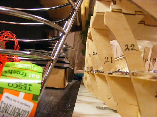

Ok, started fairing the hull and shaping the stern and have now decided to stop a little while and take stock of a couple of problems that are now staring me in the face.... will try to explain the dilemma I am now facing.... Glare Glare.. Although I previously said a couple of the ribs needed to be packed out I have found rib 22 to be way to narrow, pics show the rib is too narrow by about 5mm on both sides, this will have to be built up before going on any further... If I tried to plank as is then that area of the hull would have quite a distinctive hollow Glare Glare .. There are more problems to resolve...

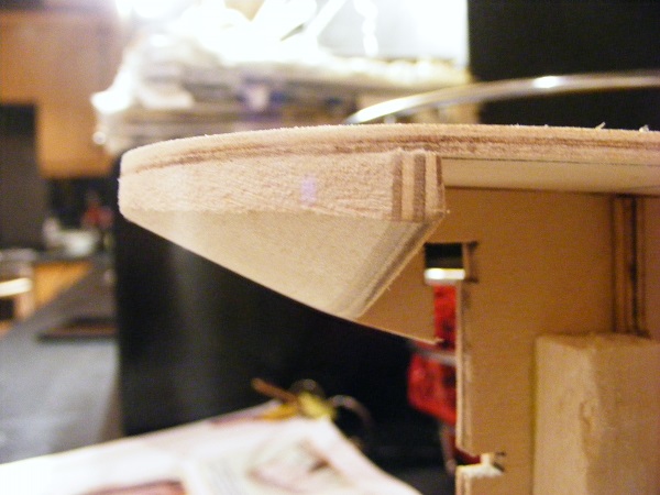

#177 Posted : 04 February 2014 23:11:59
Once planked the stern would look like this and it was here that I really started to notice things didn't look right, certainly did not have the iconic ships stern profile that's for sure.... Looked into the next box and studied the instructions there and suddenly the instructions showed a different profile but no explanation or diagrams as to how this was to be achieved....
#178 Posted : 04 February 2014 23:19:25
Another dilemma is when using balsa to shape the stern area I now have to try and find a way to get the portholes to light up.... Have to do some thinking now and am going to start by removing the balsa blocks and starting this area again.... Concerned however by changing the profile I may end up with problems fitting the ply etch later but that will just have to be a problem to be resolved when the time comes.... Finding it hard to believe there is this distinct difference in the stern profile between part 1 and part 2.... Glare Glare .. Am now going to order some balsa from CMB so until that arrives I will get on with fairing the rest of the hull.... Cool Cool .. Will post how I intend to resolve this and how I progress..... Any ideas or advice would be welcome......
