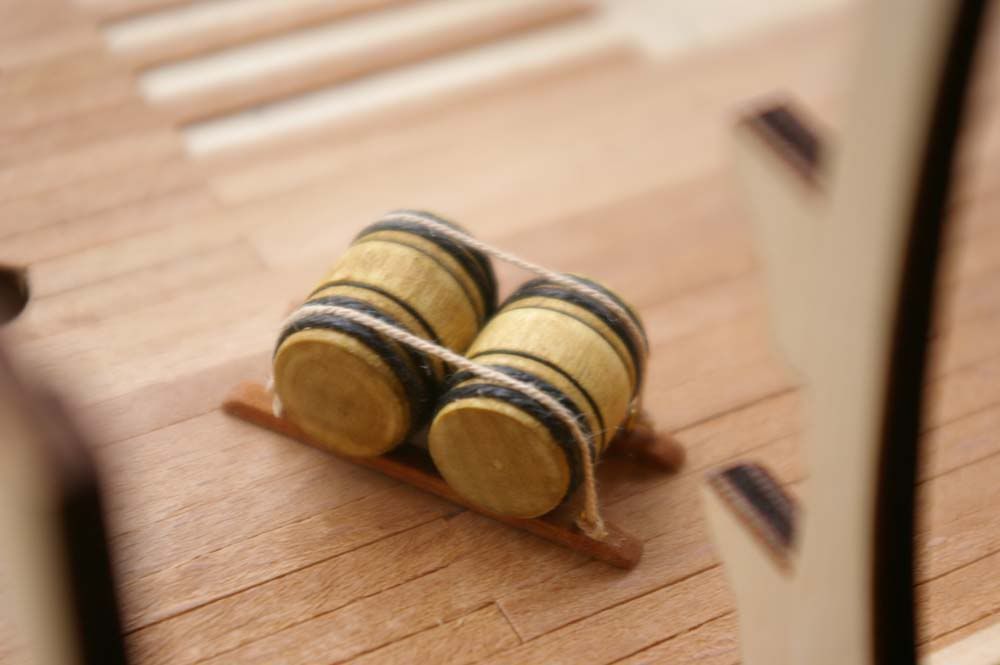

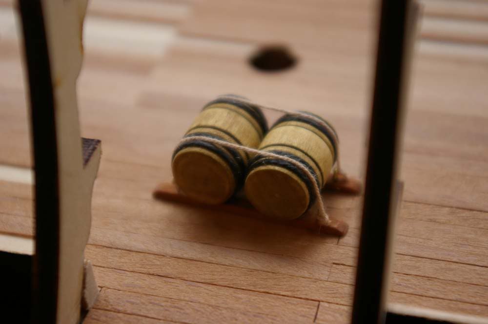

Sorry for the delay - heres what I ended up with:

Hmmmm..methinks a bit of bashing is going to be done by some people as those barrels don't look right,the staves should extend beyond the lids for a start.Please don't think I am criticizing your work in any way.

Methinks there will be a challenge here where I can use my lathe to turn back the inside of the tops of the barrels to form a rim?
I think I will also use some 160 g/m2 card to make the metal bands for the barrels. Painting the card with Admiralty metallic black paint seemed to do the trick for the iron bands on the anchor stock.

I think my solution will be to shorten the barrel. scribe in the plank joints and then add the lip with some modeling clay/epoxy putty. I recon the bands could be done with the plastic card this will also allow you to add rivet detail. not got mine yet us subscribers are 2nd class modelers BigGrin
