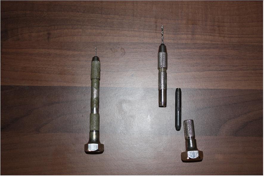

You may also like to try the Pin Vice. I found them easier to use/control when drilling numerous holes in my Victory. about the same price as the Archimedes.
One thing to note there is an additional chuck "hidden" in the handle. Took me weeks to accidentally discover this when changing drill bits one day. The handle came appart and bingo an additional chuck stored in the handle.
