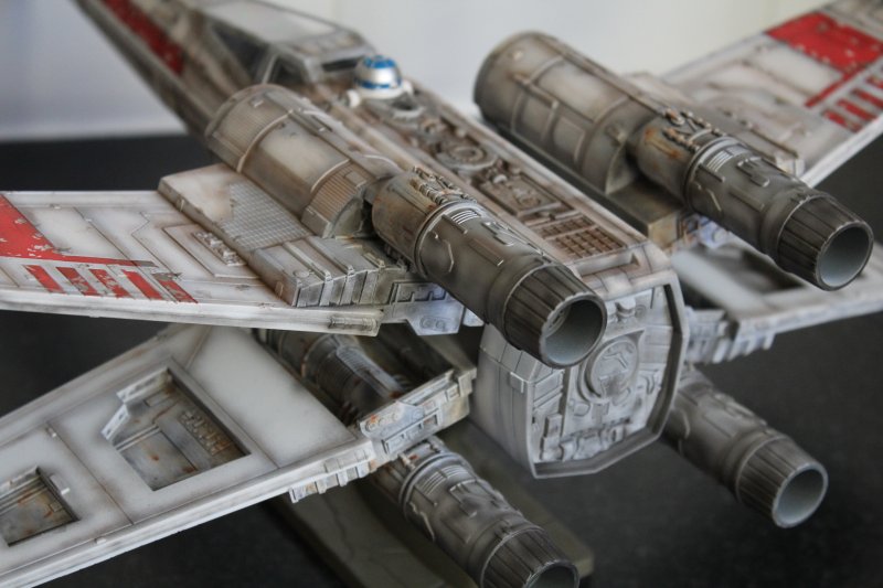

Hi Guy's... other bits of detail added and to be honest you can go as heavy or as light as you want.. battle damage, laser strikes etc can be achieved in much the same way.. Pictures of the finished model.
