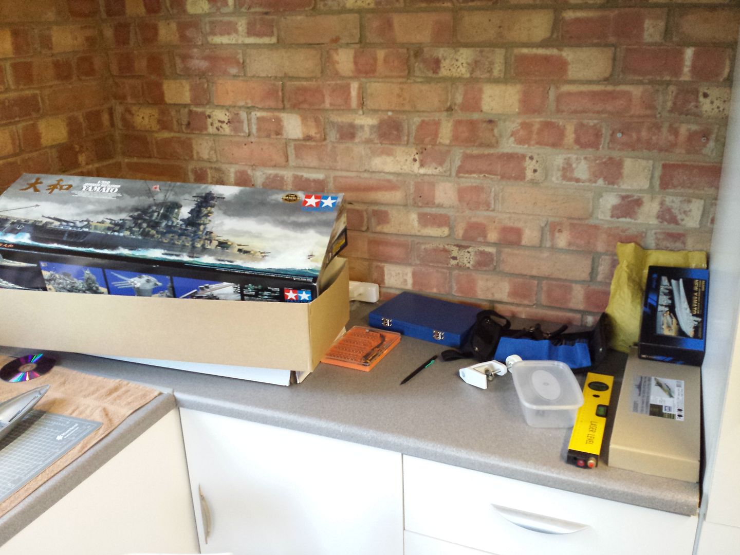

So I am returning to modelling after a 18 year break (I'm 36 now) and have got myself the new tool Tamiya Yamato, Tamiya IJN utility boats pack and detail up kits from Pontos, Lionroar and MK1. I purchased a house in September and just got the garage emptyed and setup 2 weeks ago to start getting back into modelling

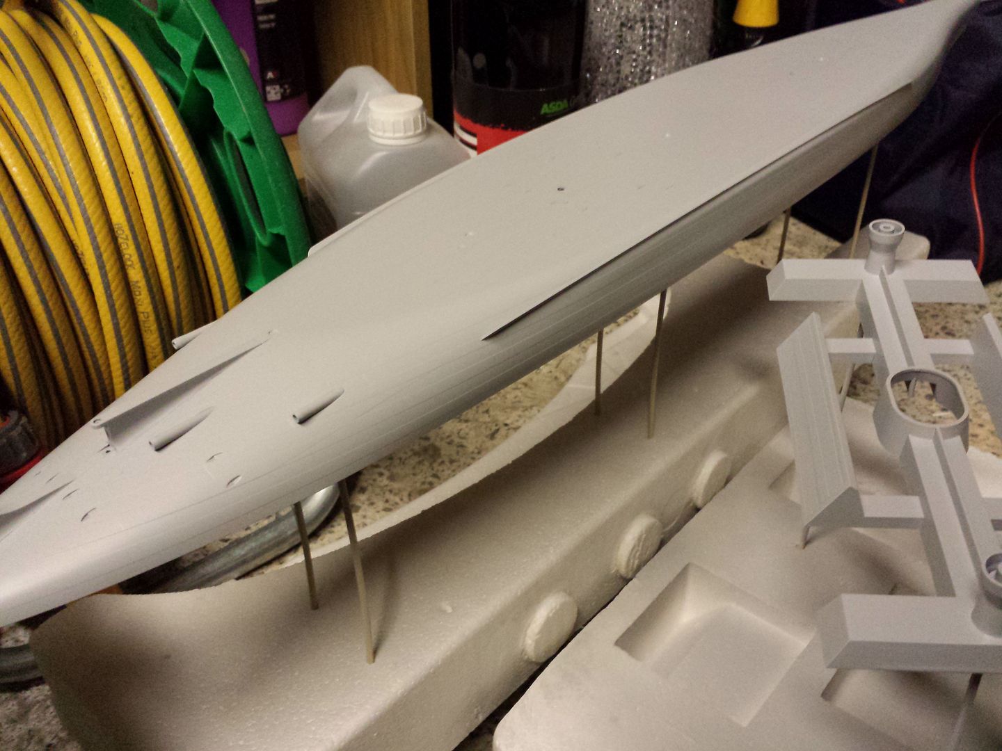

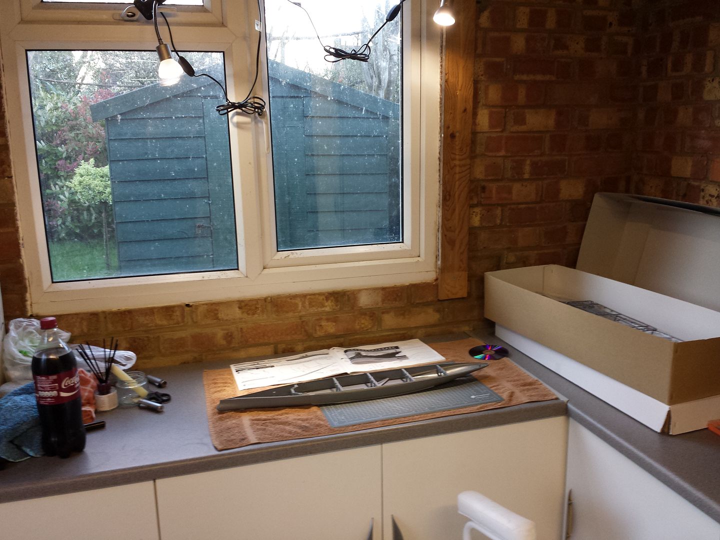

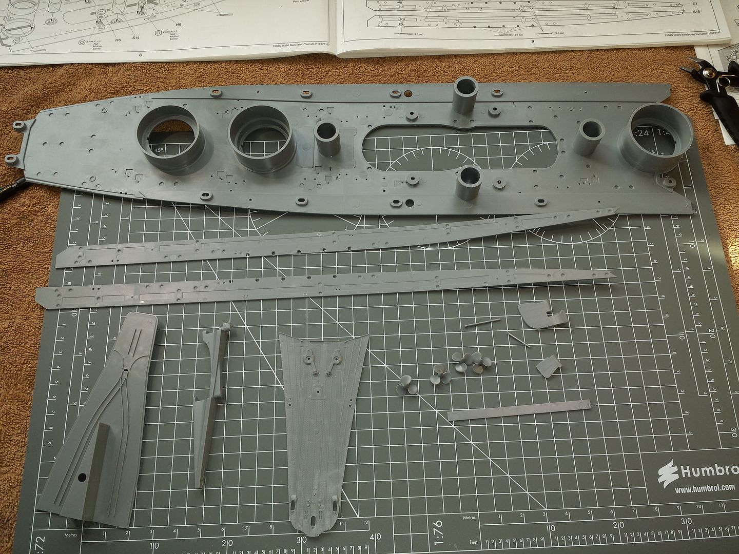

This is by no means going to be a quick build so settle in for the long haul, a few pictures of my current build area and the keel being laid, nasty seem to be filled already although as I understand it the rest of the fit should be very good.
Apologies for anyone that has already read this on another forum

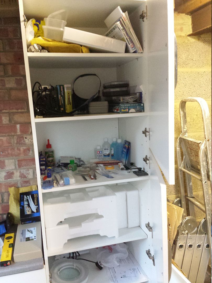

Some pictures of the work bench as it is, I have a nail technicians 5x magnification table lanp for when I really get stuck into the PE

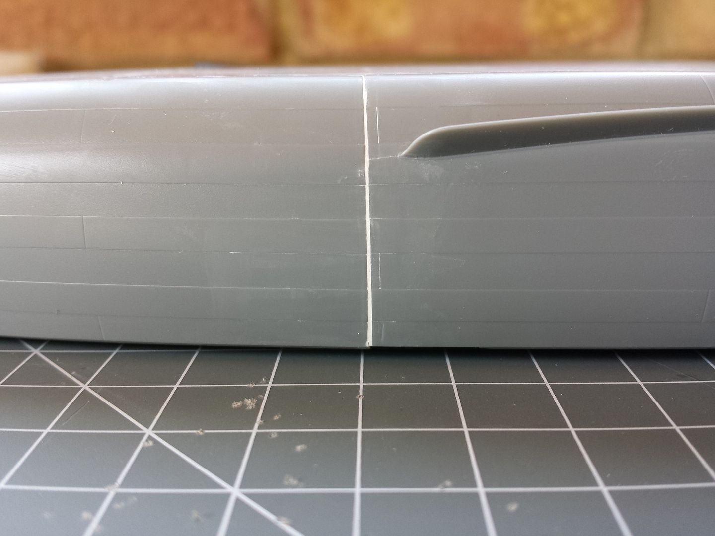

Really bad seem putting the hull together, the box is big enough for it to have been a single peice hull

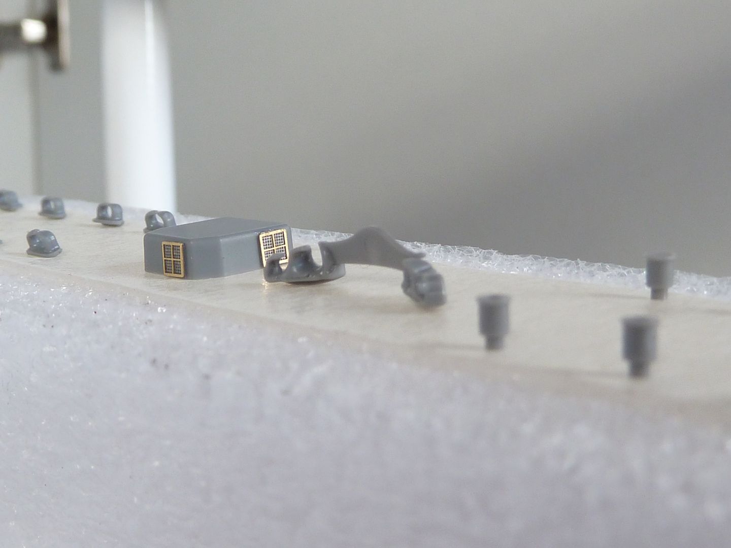

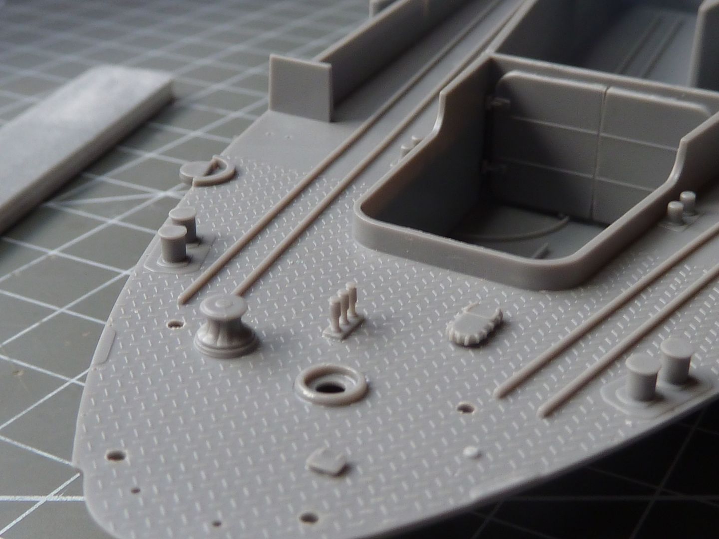

Just some cutting, trimming and sanding here to get bits ready

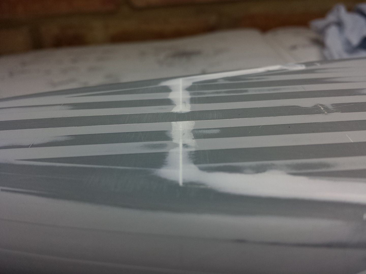

Seem all filled using perfect plastic putty, really nice stuff, had to build up numerous layers to get it right, perhaps that was just my technique as I havent used fillers before.

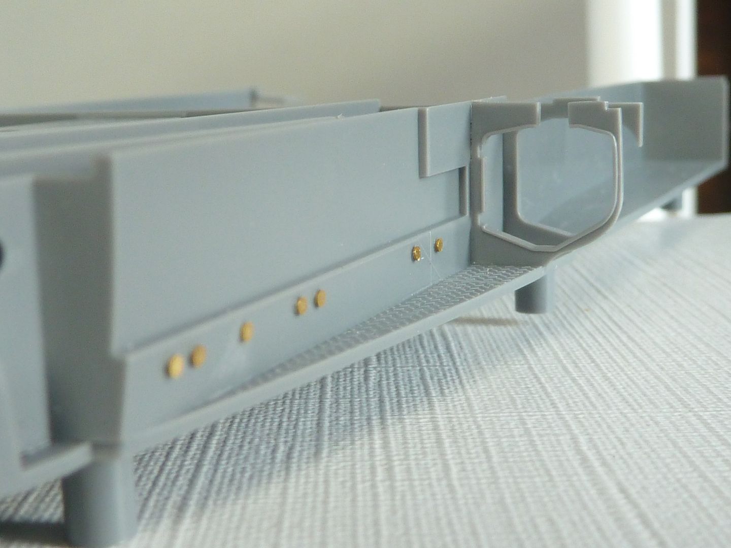

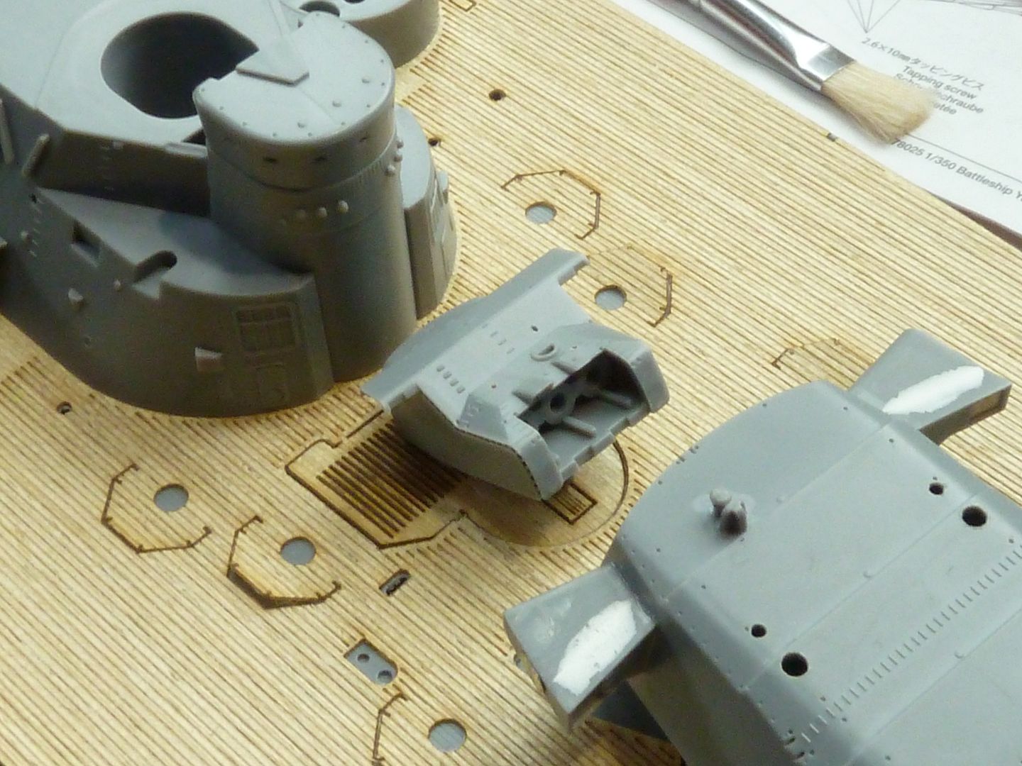

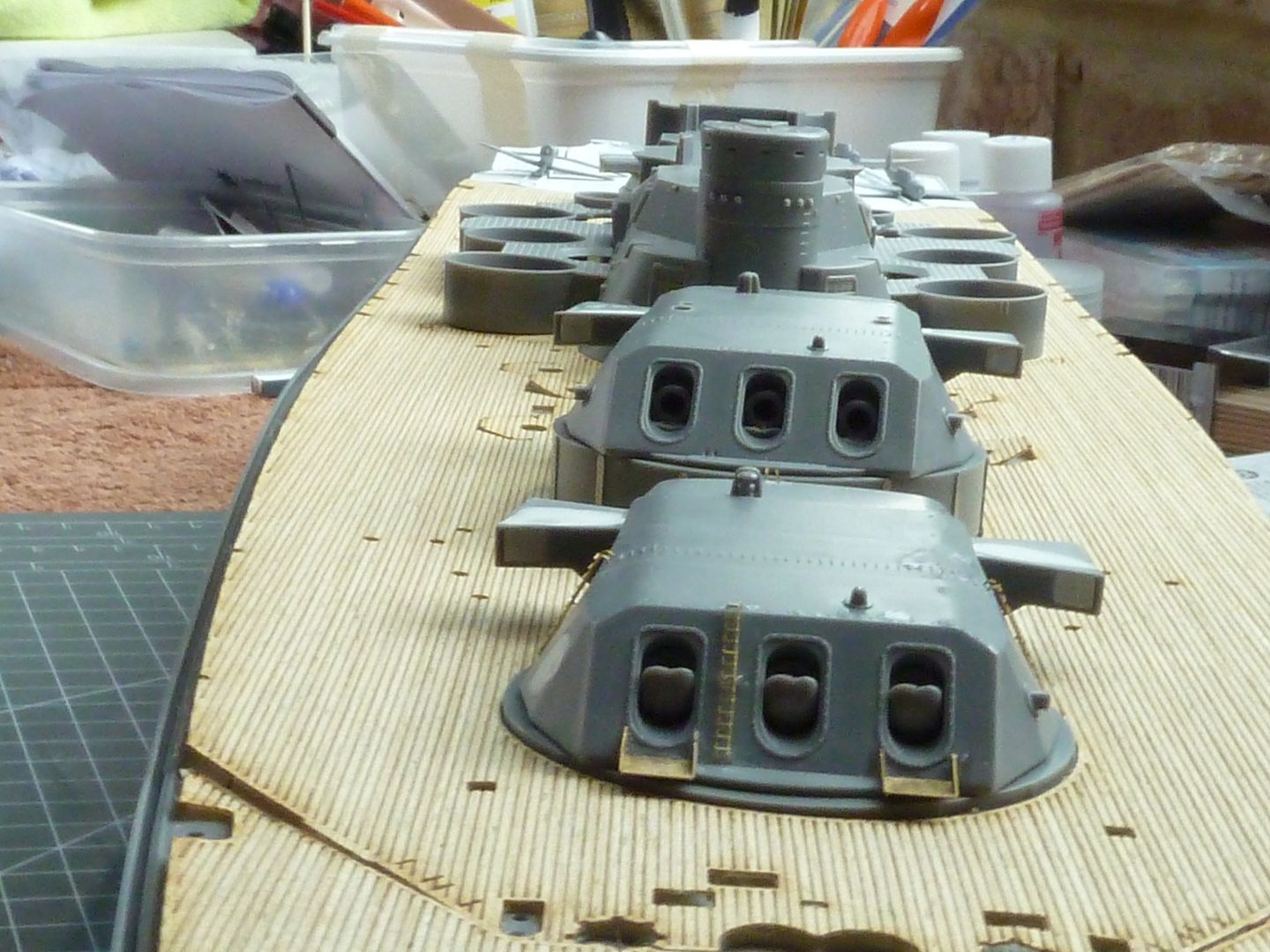

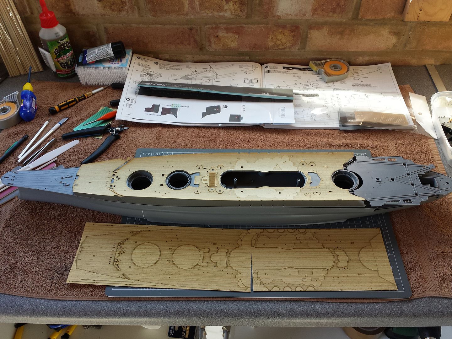

Seeing as I had previsouly spent a lot of time cutting, trimming, sanding and drilling I thought I would dry fit all those bits. Wooden deck dry fitted is the MK1, I will be using the Pontos one in the front of picture

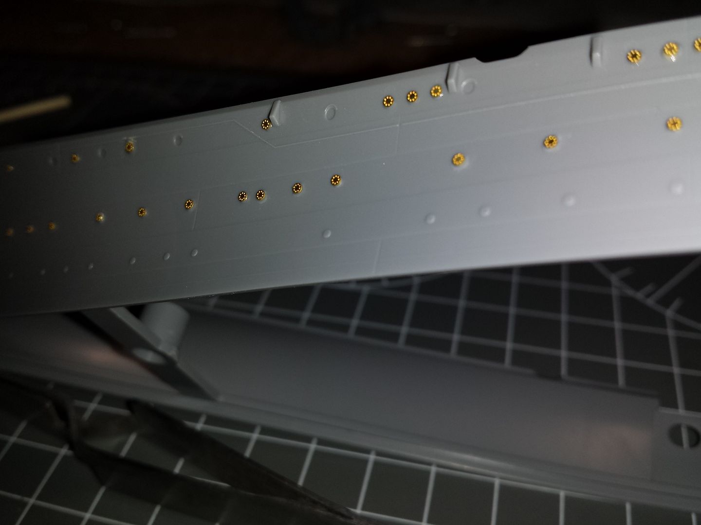

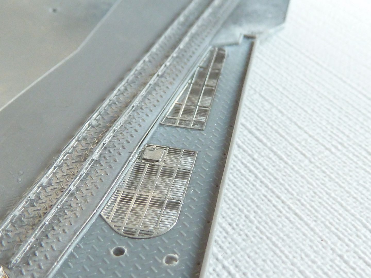

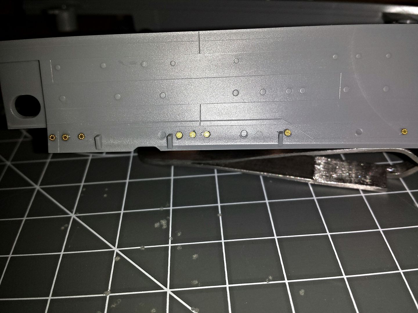

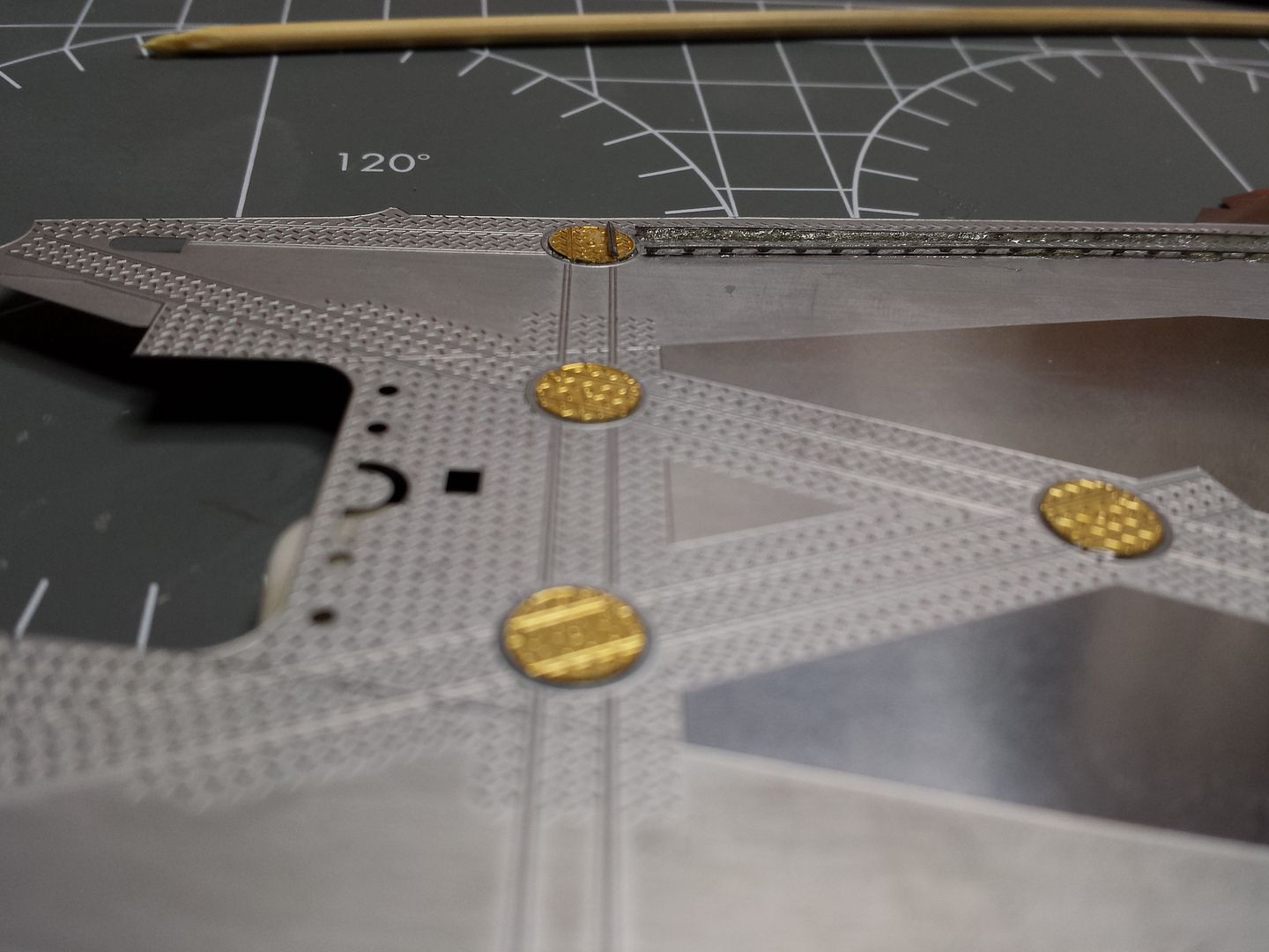

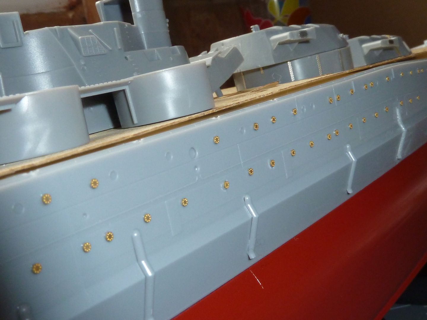

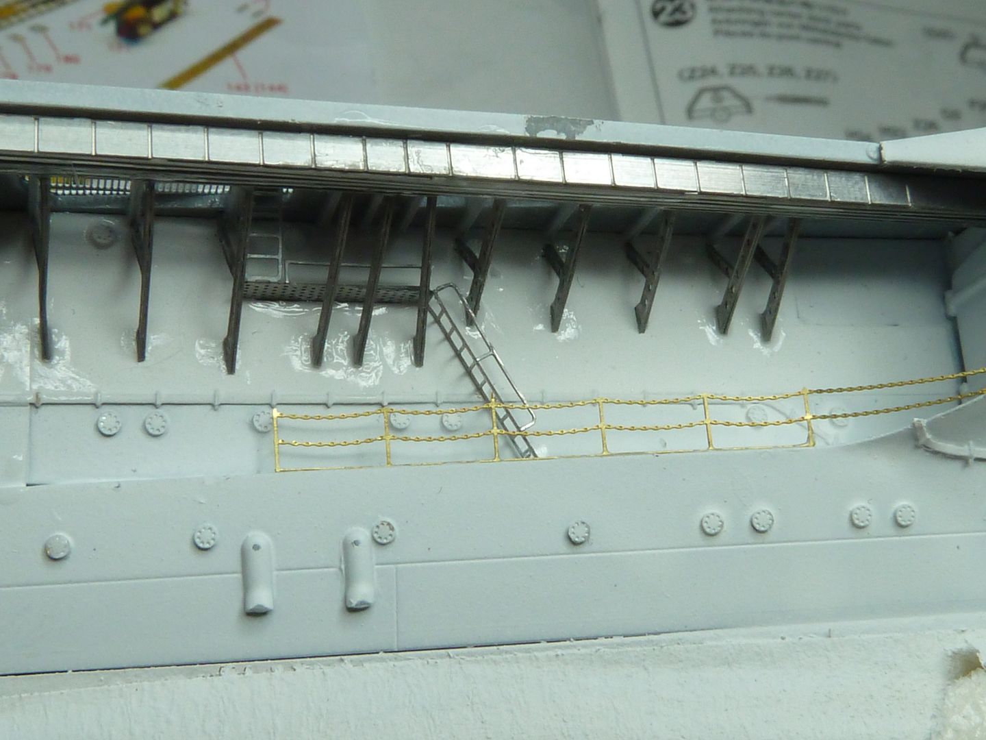

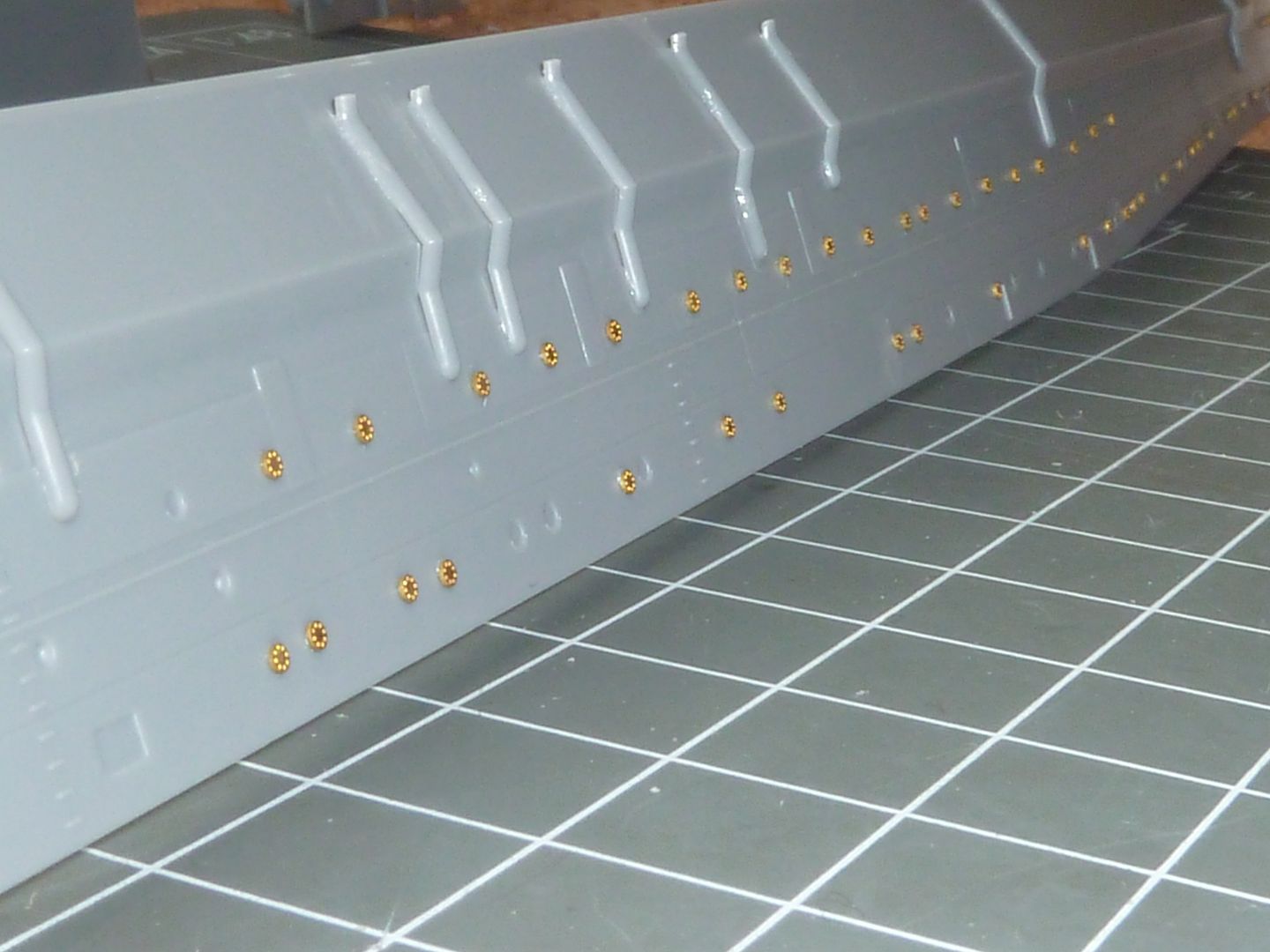

Time to tackle some of the PE, Ive kicked off fitting the deadlights from the lionroar kit, damn small and LOTS of them, there 660 supplied but I havent counted up how many are on the ship

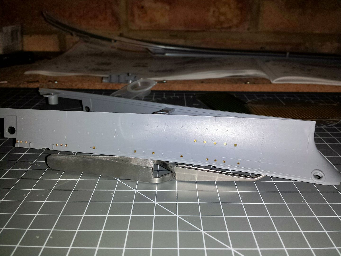

have fitted some more deadlights as well as refining my technique making them much neater, now I have applied a small bit of blu tak to the pointed end of a pin for picking up and applying the PE. I am applying a small tab of gator glue with the end of a cocktail stick

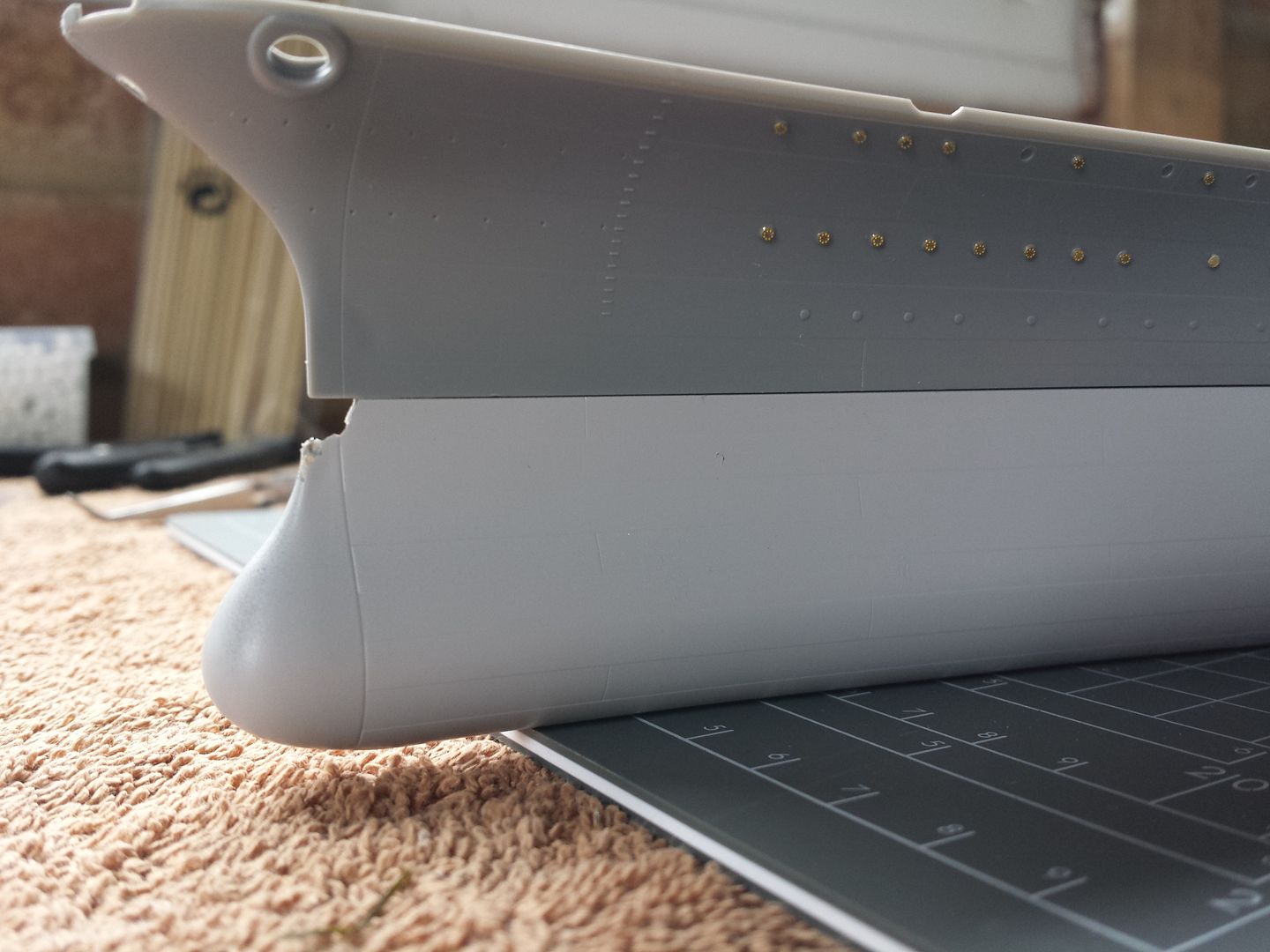

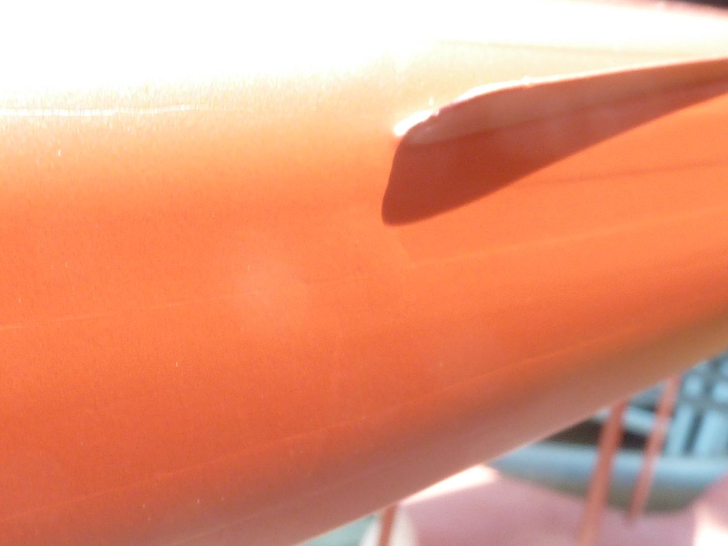

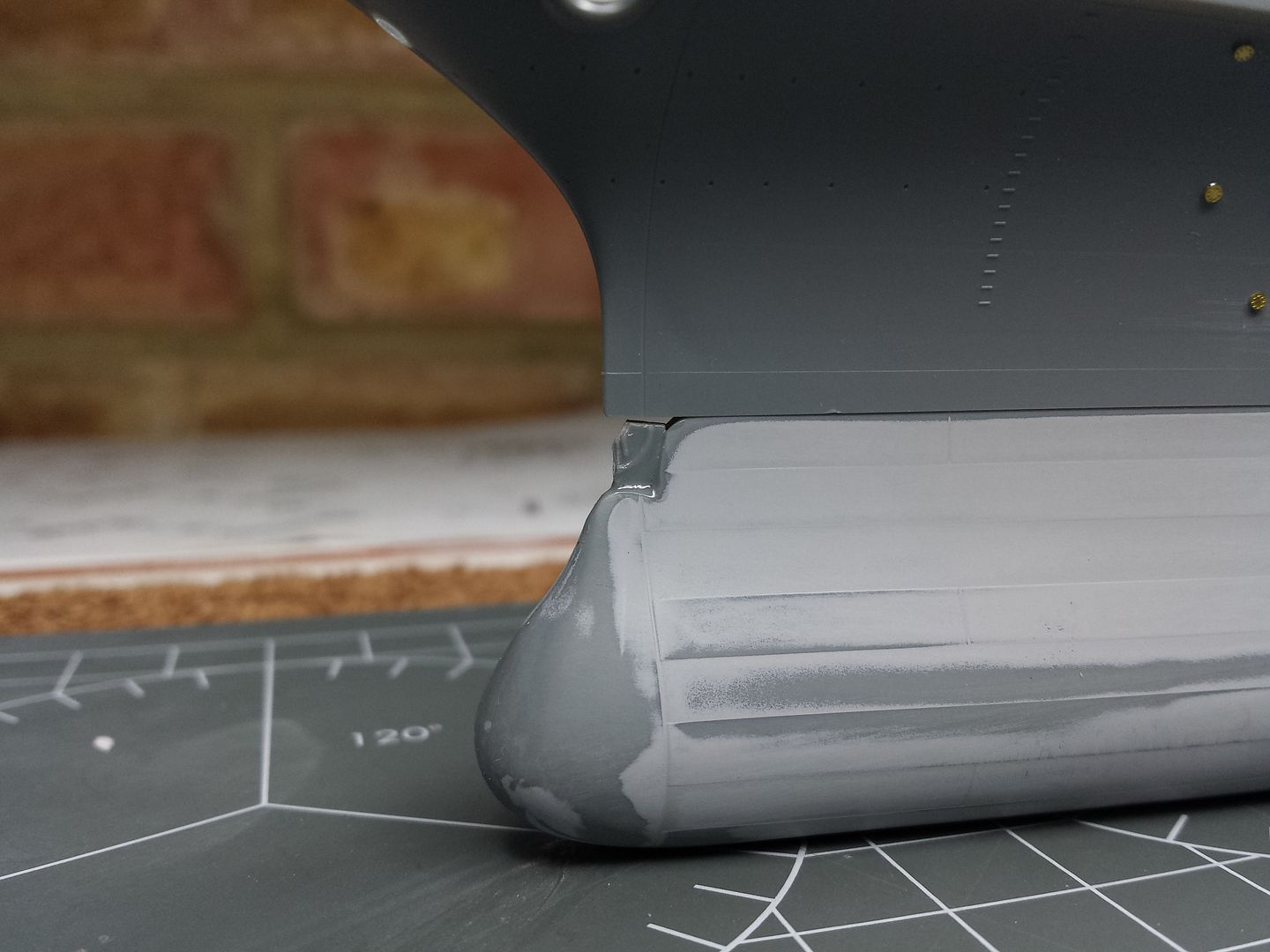

Also had a total nightmare, went to pick up the hull to examine it to see if I needed to wet sand before applying final colour and the worst possible thing happened, I DROPPED it :banghead: This is a picture of the damage, could have been worse I suppose, down the local hobbybase today for some milliput.
This will be a bit of a learning curve as I have never used milliput before or even had to make a repair like this, doesnt look to bad to putty up and shape so I am confident

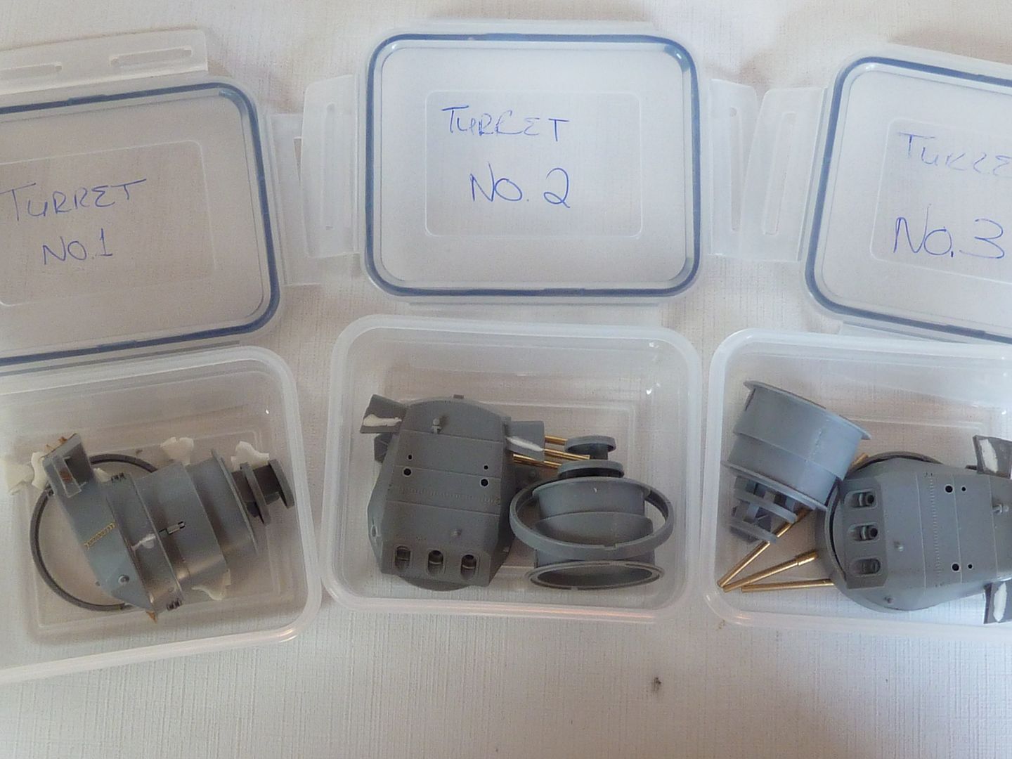

I haven't fixed the hull yet, perhaps will get on that tomorrow. Over the last few days I have been putting together number 1 turret. Cant believe how many parts are involved with this, about 40 used so far, most are internals.

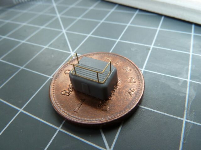

I also started on some real PE use, not just sticking flat bits on, this is my FIRST time and Im glad I've got a few different sets as I ruined a few ladders getting the hang of it. I have straightened the front ladder since this photo was taken after leaving the glue to dry)

Stuck a bit of plastic in my chip ready for the milliput, now I have the plastic in it looks even less scary of a fix to make :speak_cool:
Seeing as I needed to fix this I decided to get more filler on the seam, its so much better than before, nice and smooth now, sides still left to sand and a bit of polishing to plastic before repriming.
Another go at some PE, definately a lot of patience needed for these small rails but Im slowly getting there. Im hoping it looks a little bit better when the gator glue has dried, it does dry clear.

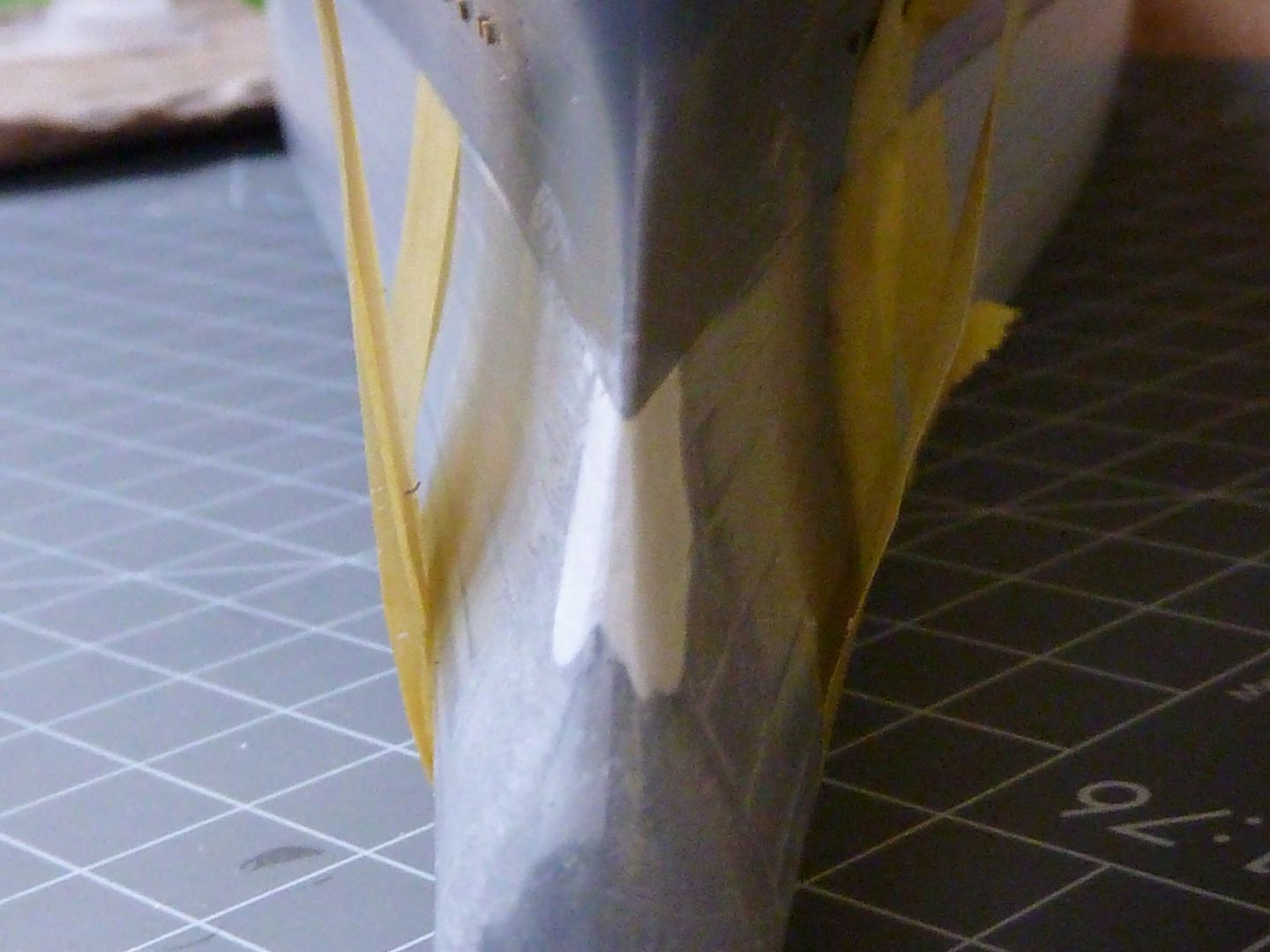

Spent a bit of time playing with milliput to get the feel for it and must say I am really loving the stuff, wet your fingers and its almost like using clay. I've got the white milliput.
So after having a play I made a first attempt at repairing my damaged hull and must say for the another first Im am quite impressed, I need to do a little more work then polish the plastic ready for repriming and painting. Yet another first was attempting to rescribe the lines.

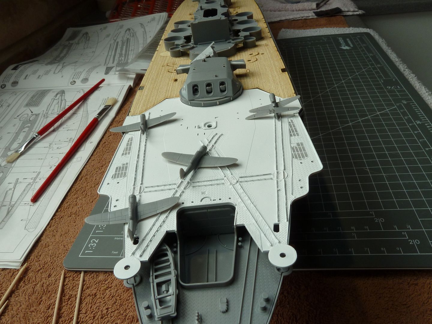

Flight deck completed, this took quite some time to complete but patience paid off, redid 2 rails as used the worng glue to start with which looked a bit messy

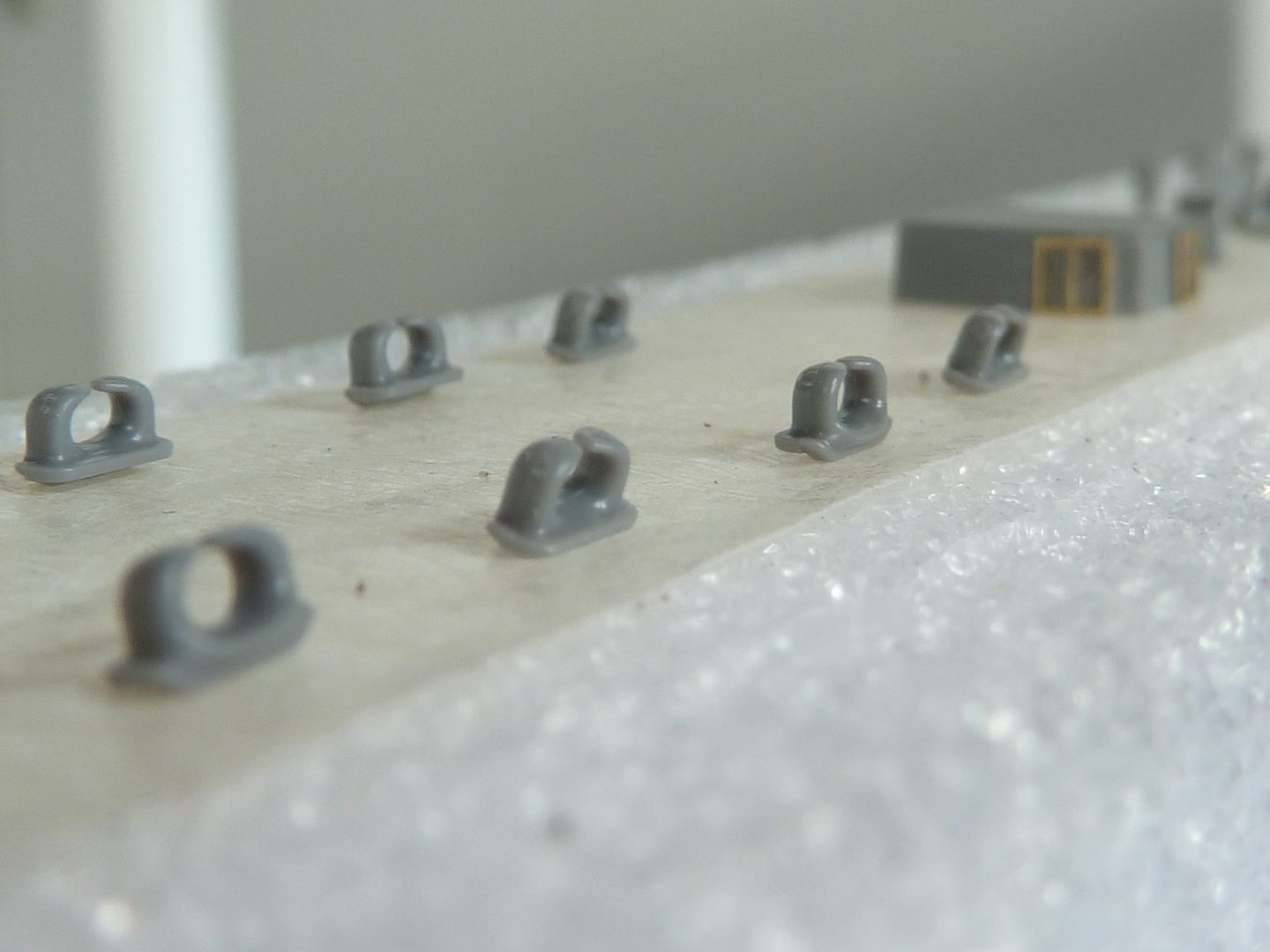

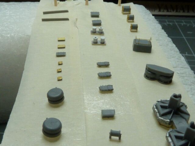

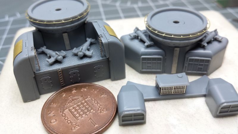

Lots of little parts cut off, cleaned up and ready for spraying. Its amazing how long it actually takes to get all these little bits ready
Bit of work on boat deck and more tiny bits added
More photo etch added to flght deck
Turrets in varying degrees of build

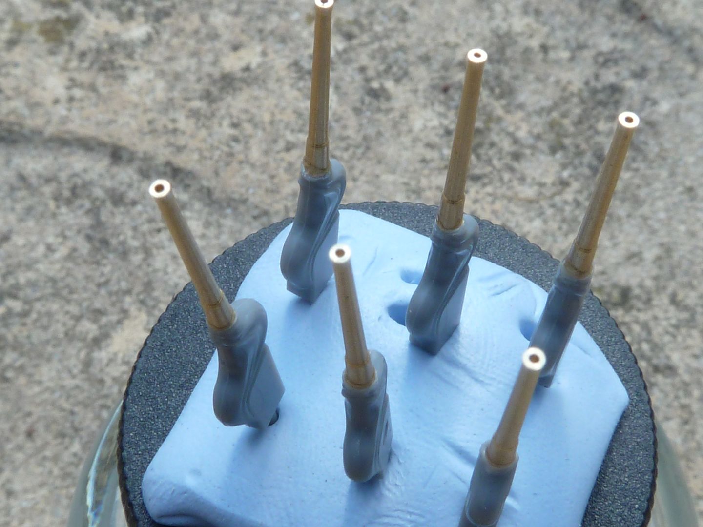

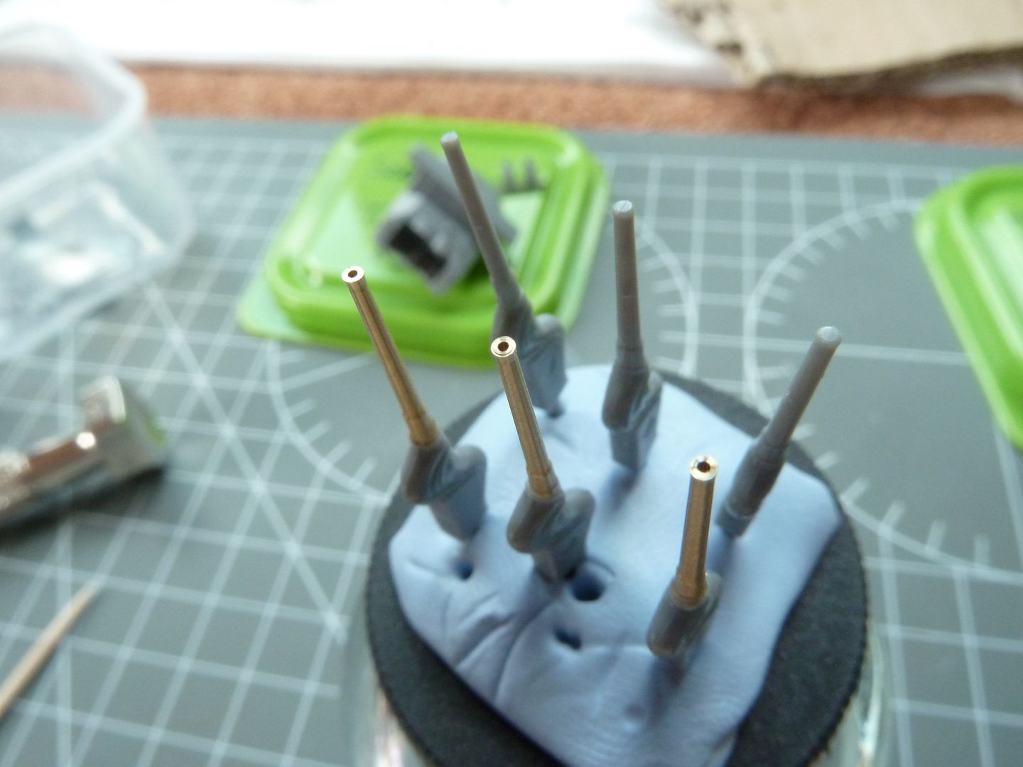

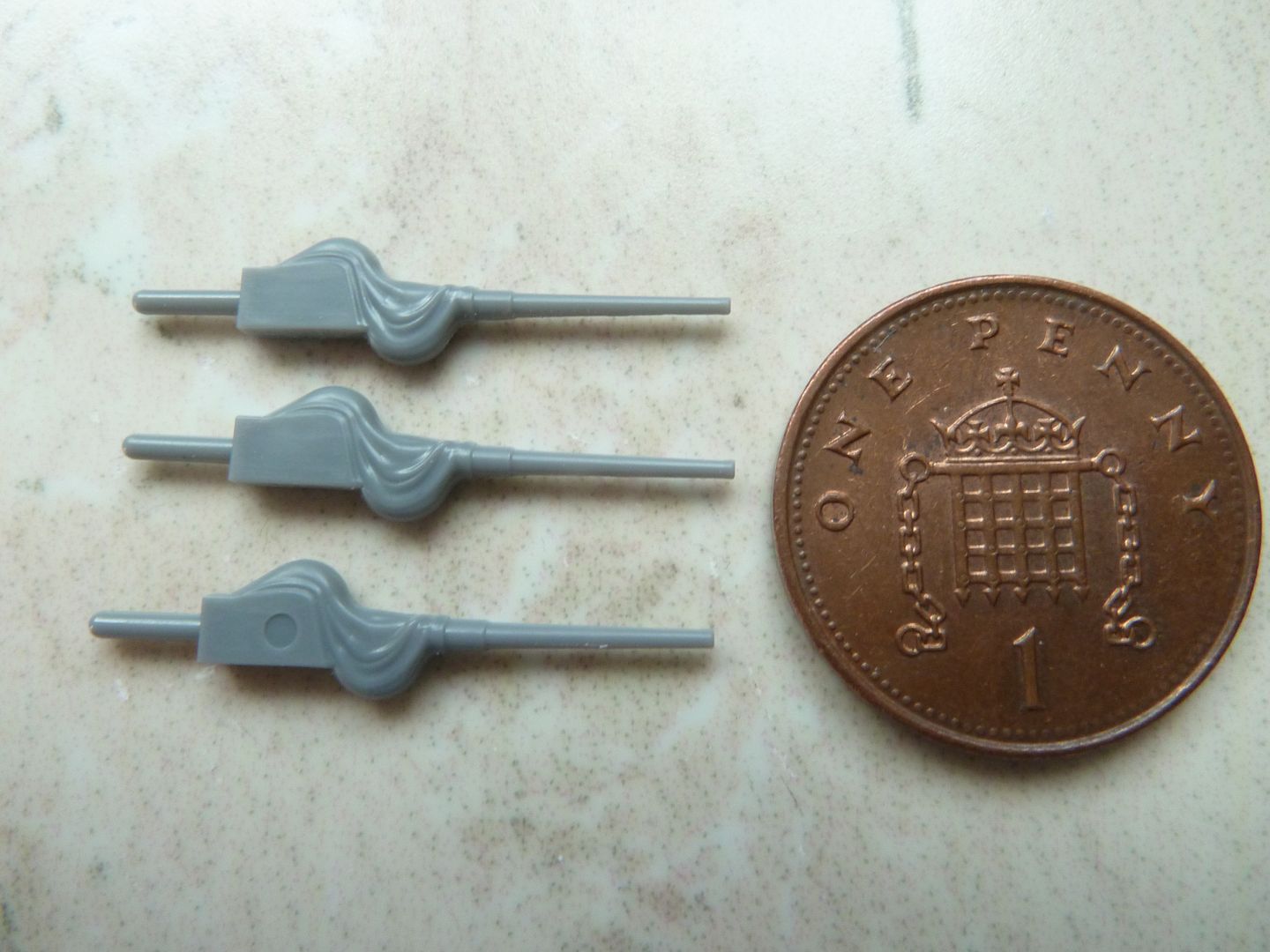

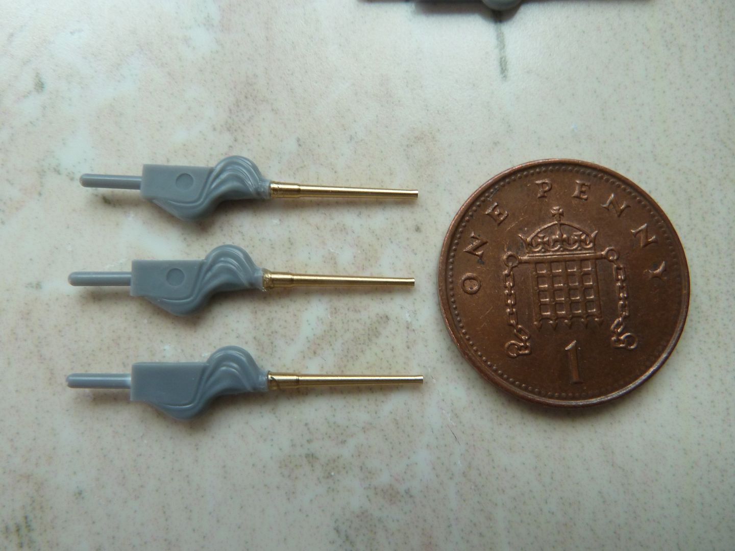

Prepped the secondary gun barrels and replaced the plastic with turned brass
All done ready for spraying

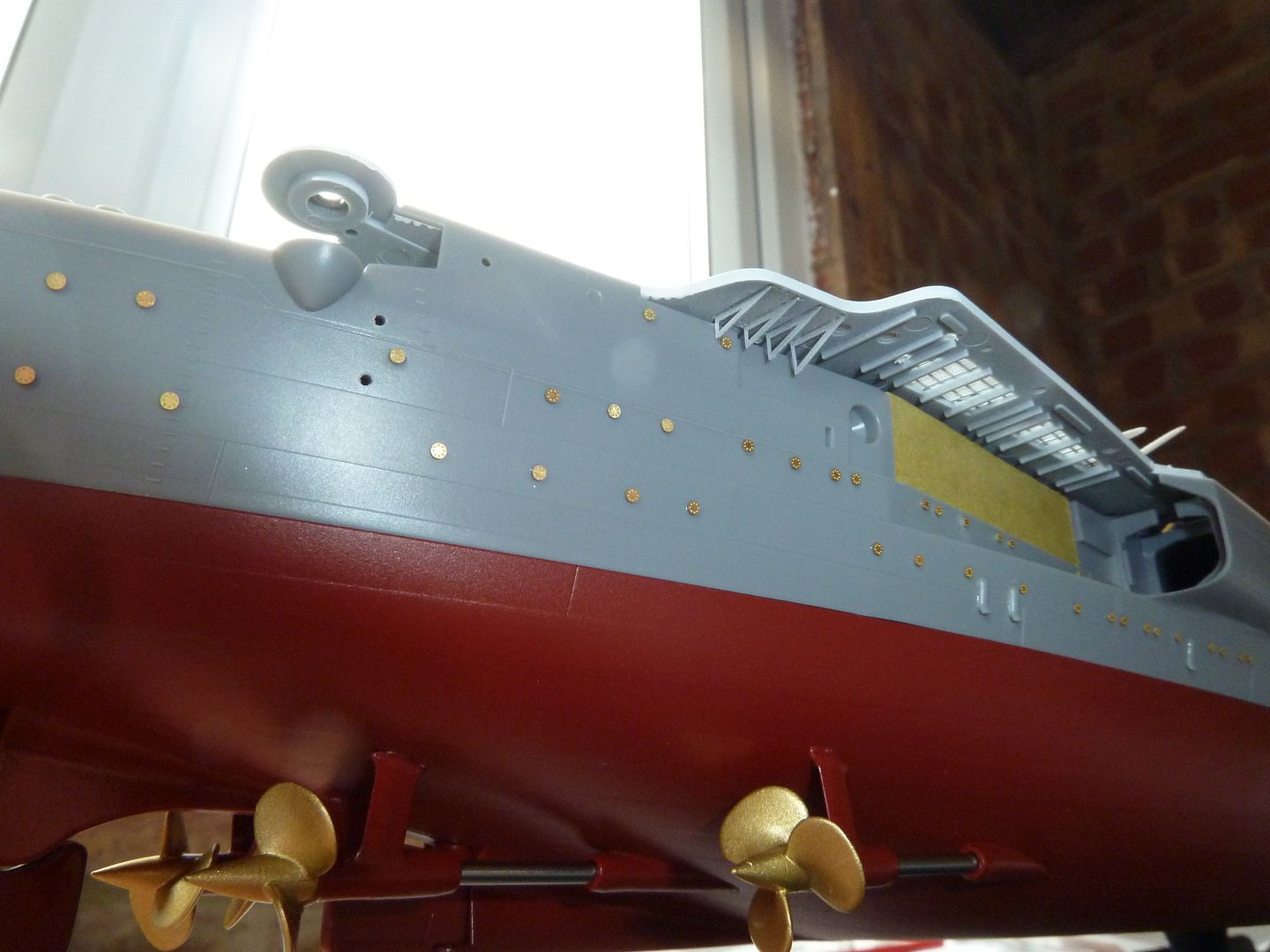

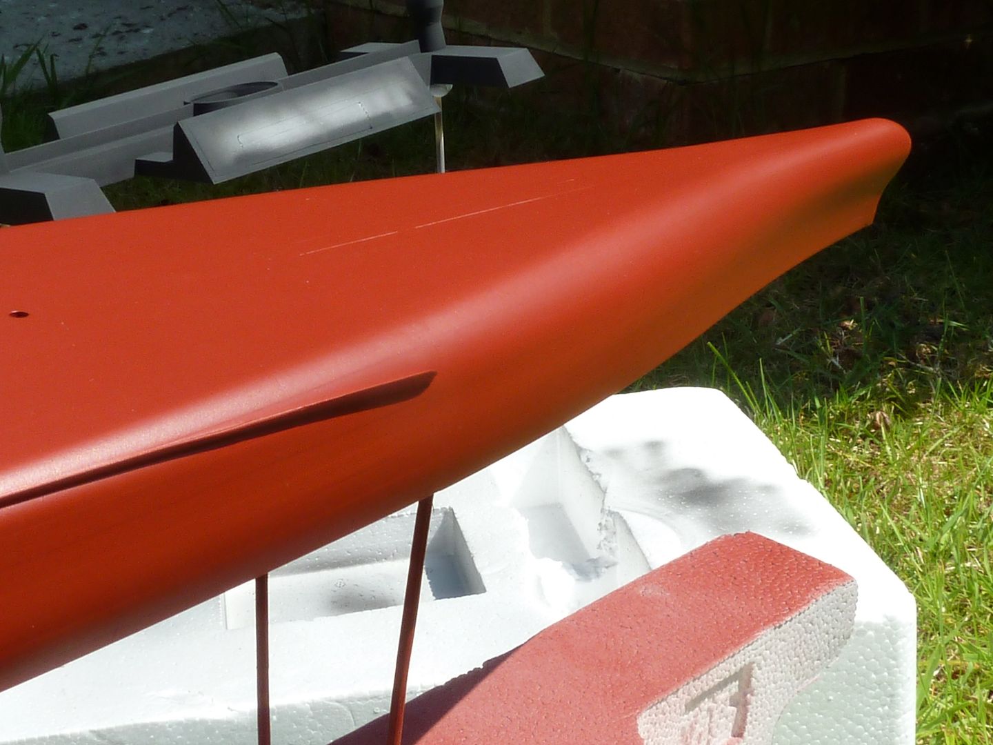

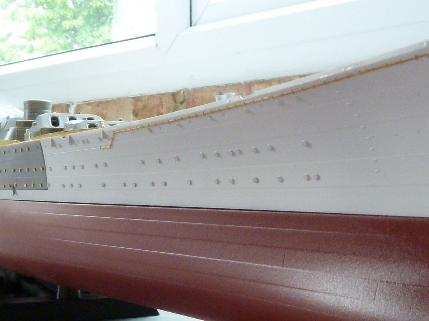

Hull repaired, reprimed and final colour added, I am going to do a bit of gentle wet sanding on the bow to soften the rescribed lines as I think they look a bit sharp and rough, also a few at differernt angles to try and show the work at hiding that nasty seem, its not 100% but you have to really look for it to see it and I am very happy with what I have done with them. The little white specks you can see just brushed off after the photo showed them up.
You can just see the stand in the background with its matt black coating ready for varnish coat. You will notice that I did a pretty good job of the seam as it runs all the around the bottom of the hull however I didnt do such a good job with the seam running for to aft, not quite so happy with this one, I am not going to go back and redo it now as its not going to be seen once mounted on the base.

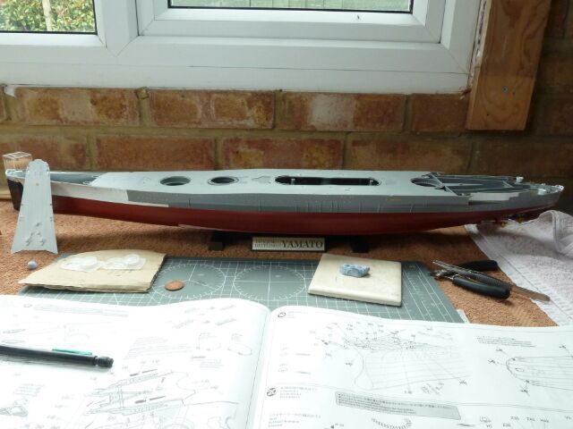

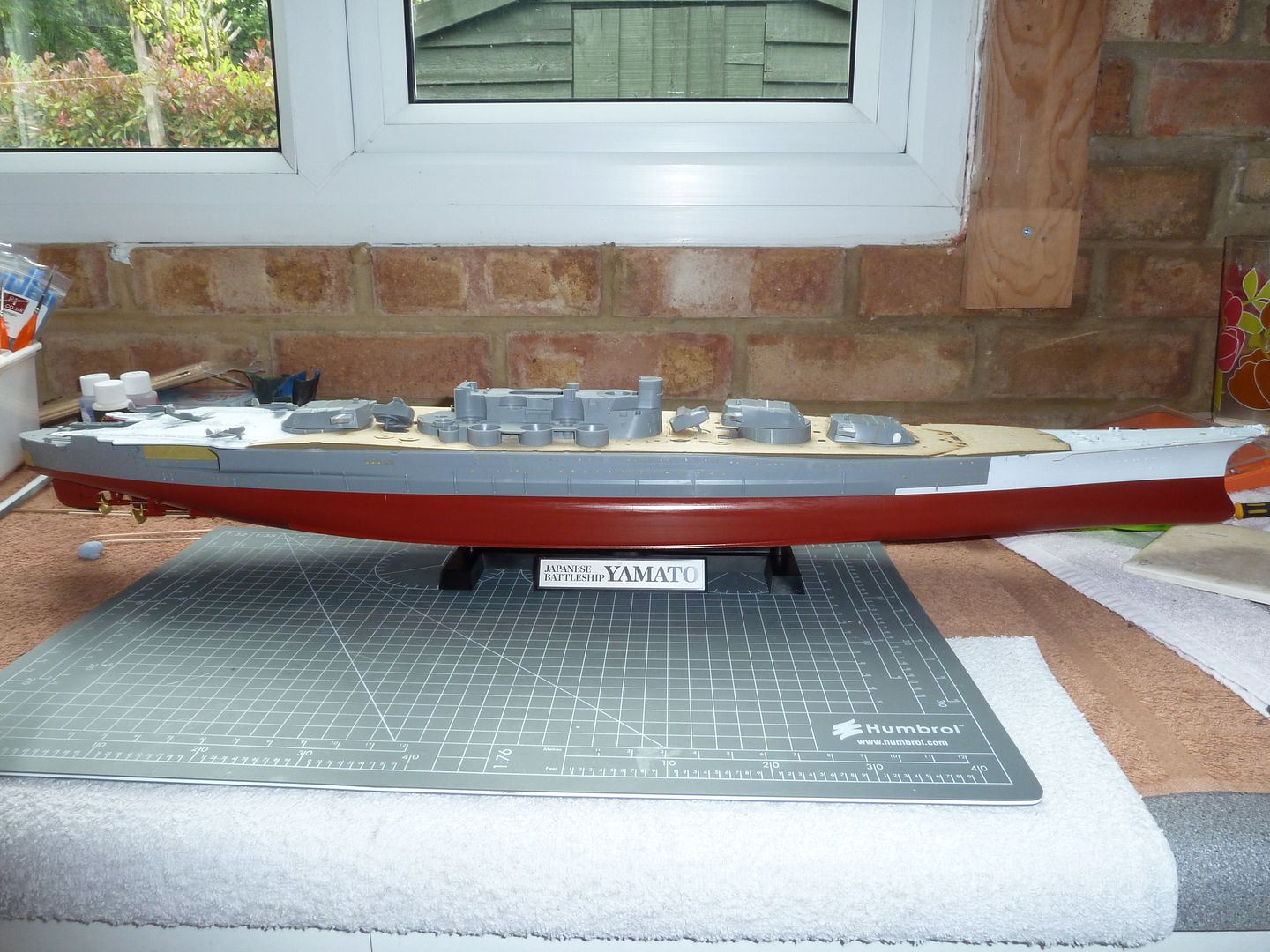

I have cut all the planes and boats off of the sprus and cleaned them up. As you can see from the first picture the base and hull have had the gloss coat applied, I am undecided yet if I am going to leave the base in gloss or apply matt over it. You will also notice that I have started to apply primer to various parts, started priming before i realised I hadn't put the degaussing cables on. It took my ages to get all those dead lights on, there must be about 300 of them.
I have now decided to stop where I am and get the hull finished, decals, matt coat and then get the upper hull attached so I can finish the de-gaussing cables and get the upper hull all sprayed up.
Lets see if anyone notices the little error I have made on 2 of the turrets

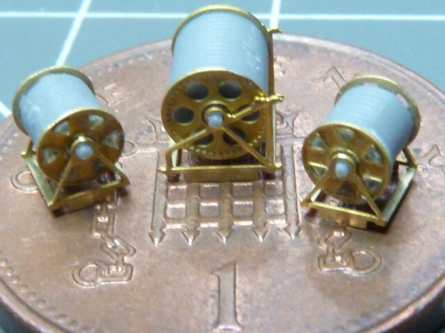

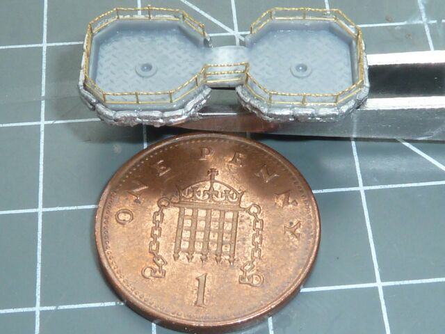

In the meantime I have started to prepare more small bits ready to spray and stick on after the deck has been applied. This has involved more PE work, starting with the rear gun platform which has had sandbags from the MK1 PE kit added as well as MK1 rails, their rails are really nice giving a chain effect. This was the first time doing rails and just these rails alone took me hours. I think they came out pretty good. They do look a bit rough in some areas but this is full zoom on macro zoom mode.

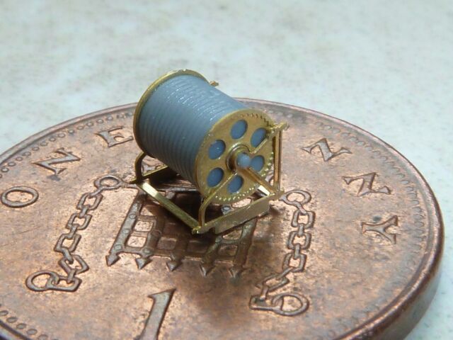

One hose real completed
3 hose reals completed
More railings, this one was a bit easier
Finally all the little parts ready for spraying

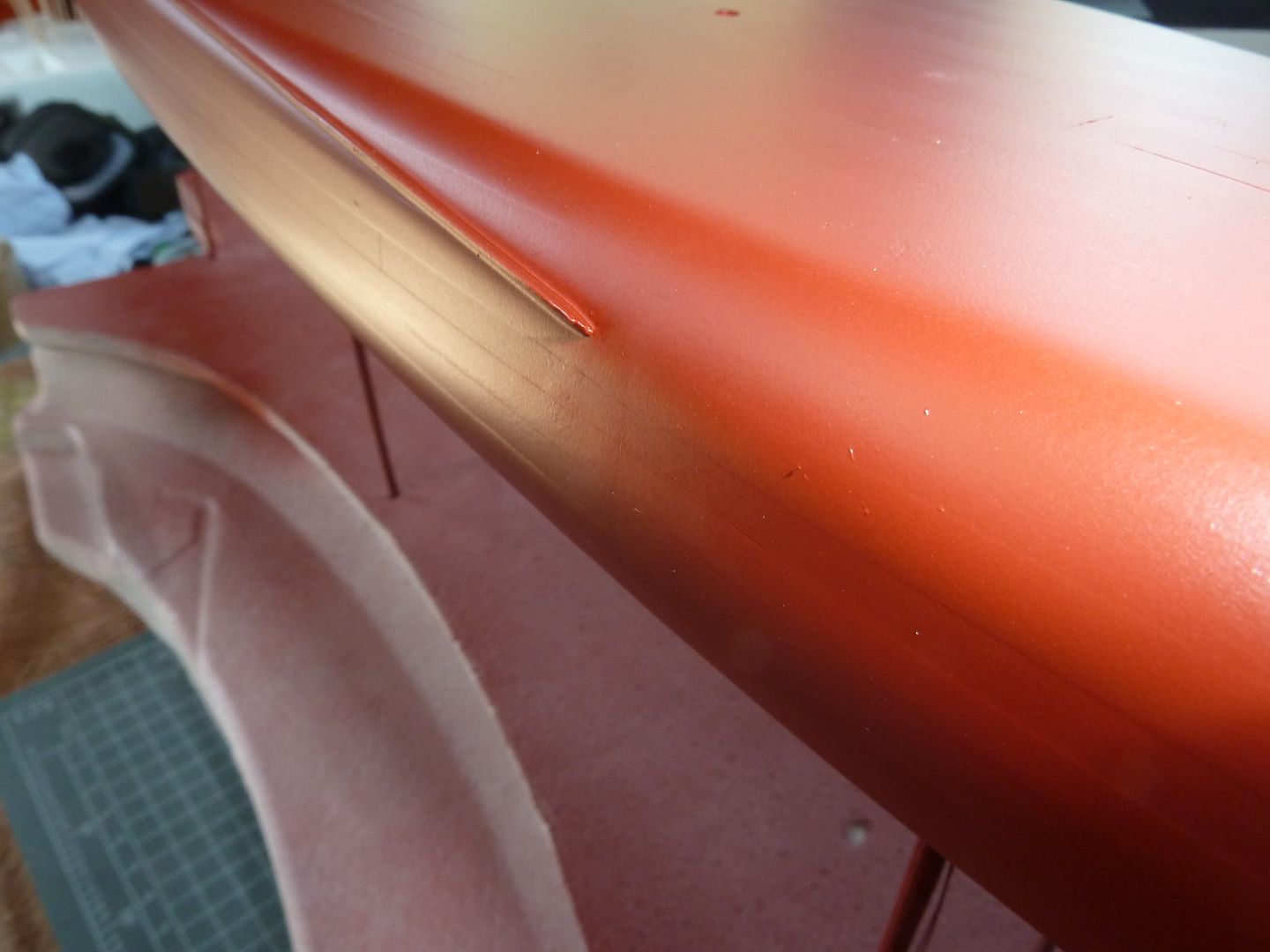

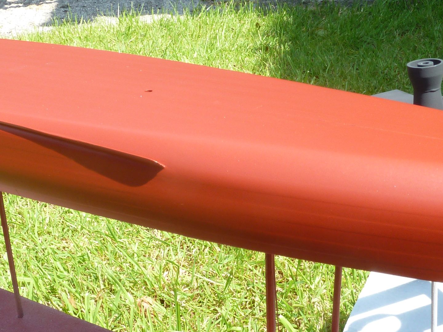

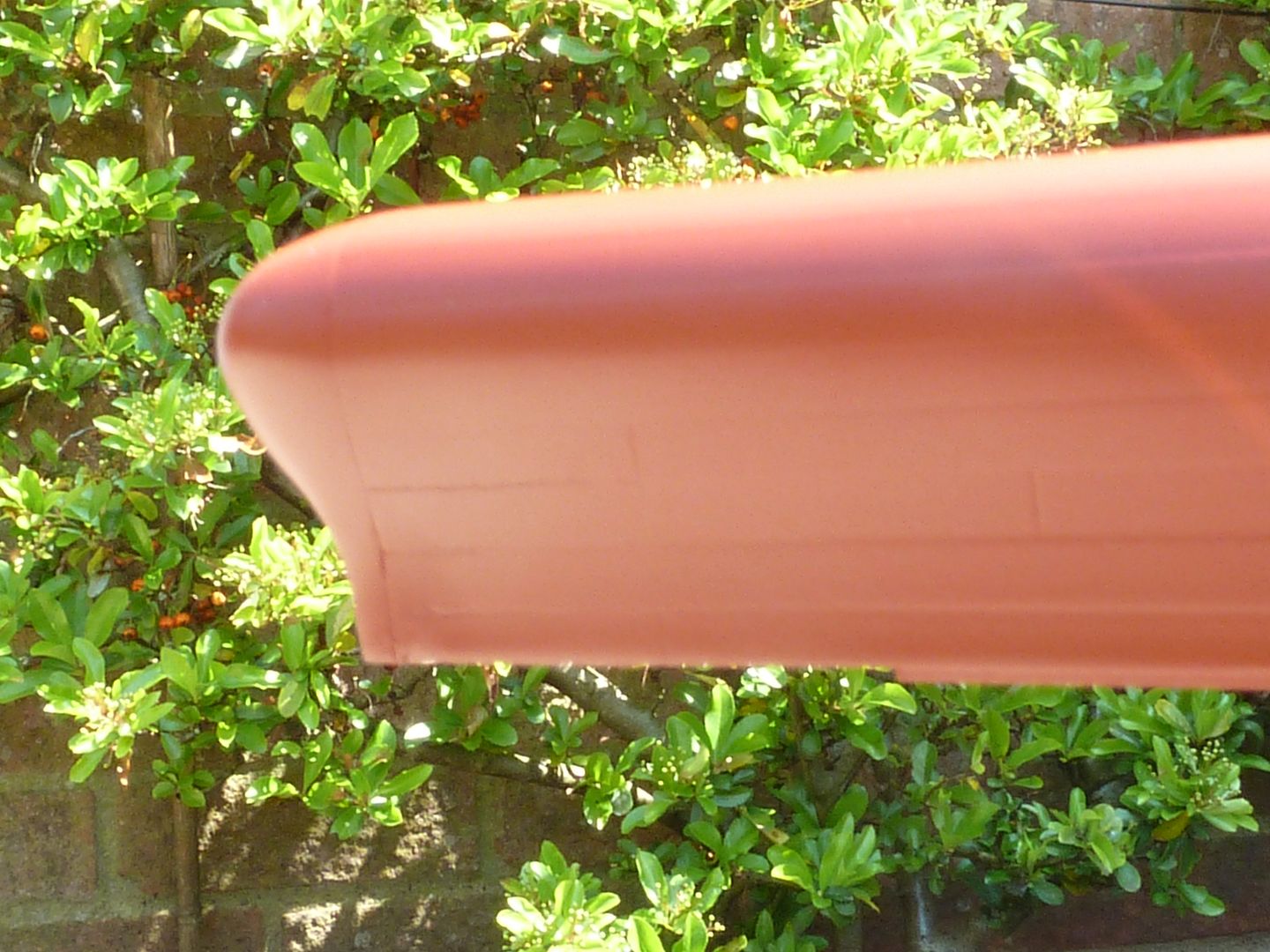

I have deflated myself a little bit since my last upate. When I sprayed up the upper hull and small little bits I made a bt of a mistake and have been pondering what I should about it.
The issue is that I read that airbrush cleaner sprayed on the model is good for cleaning any finger grease off before spraying so i gave the parts a once over with this. My problem being that I thought that the cleaner wouuld evaporate quicker, so I didnt leave it long enough to dry out.
When i started spraying the primer (Vallejo) it was watery due to the airbrush cleaner still on the model, I then made a further mistake of just spraying some more not thinking at the time it was the cleaner. The end result is that the primer is a little too thick and in the out area it has pooled.
It sounds worst than what it actually is and you need to get really close to see it, I am thinking about just leaving it as is and spraying the top coat as due to all the little details added to the upper hull it would be extremely difficuly to sand down.
If anyone can offer any advice with regards to removing Vallejo (Acrylic Polyurethane) primer easily and safely withough affecting the lower hull I would consider it to get a better job on the upper hull.

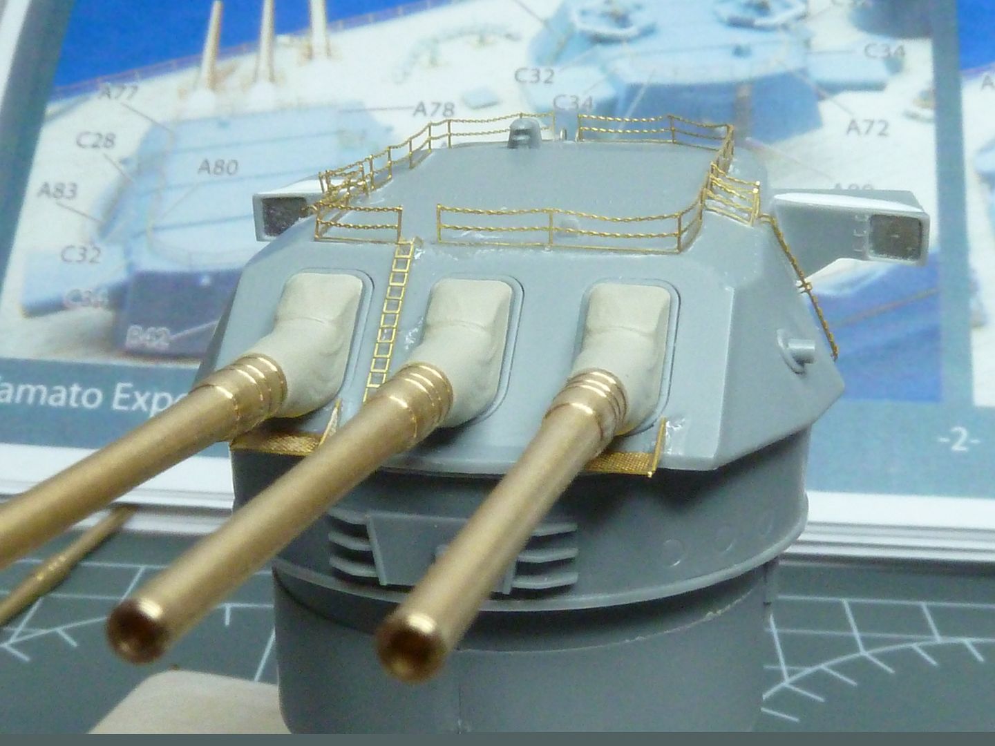

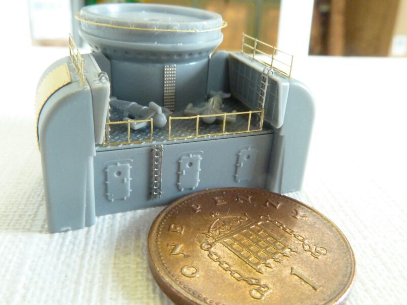

Been doing a bit more PE, first picture shows the external boat housings (not sure of the correct name), PE ladders, railings and boat winch thingie attached to both sides. Excuse the shiney glue marks.
Turret number 1 finished and ready for painting
