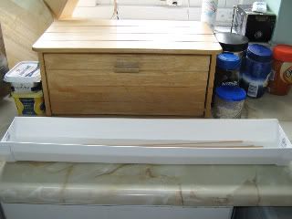

Sorry for size of pic having trouble with resizing. This is my solution for plank soaking anyway it works for me. Went to wicks got a lengh of gutting the square kind for stability, two ends bits and some sealent. Cut guttering to size in this 24inchs and attached ends and sealed with sealent. Works like a dream only needs topping up every so often with hot water. BigGrin

Nice idea!! I use an old spaghetti boiler, same principal but vertical!!BigGrin BigGrin Cool

Nice idea Pam, you having a brain storm today? Flapper LOL I wonder if my neighbors will spot the section of guttering missing LOL LOL

Of course it was a brain storm and it was painful! Flapper ! Everything else I pinch from youse lot! LOLLOL LOL

Cracking idea Pam ThumpUp I'm just gutted BlushingBigGrin that I didn't thing of something like that before. Got to be honest the only planking job I've done so far is on my HMS Bounty Jolly boat, which I just about finish (pictures to follow later today), which I didn't soak the planks just bent them using and electric bender and kept fingers crossed Glare LOL
Anyway, if you wanted to free up the work space taken by your guttering then you buy a couple of brackets to go with it and stick up on the wall Cool

Good idea Jamie, also it could be made smaller to save space as this one is 24 ins. Was'nt sure when I put it together how long Vics planks would be. BigGrin

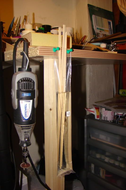

I think I've got the most sophisticated and technically advanced, very specialized device to soak the planks. Here it is:
As you can see it is plastic bag, in which the planks arrived, very precisely cut 2cm shorter then planks, and pinned with high precision to my work table. Then you have fill it with water exactly on room temperature, and that is. This device hold about 8-10 planks at once.

This is a great solution but I tried it originally with hot water and the ends severely warped. Perhaps the water was way too hot.
Now on the Mk. 2 trough with cold water ok.
LOL I did the sameLOL
