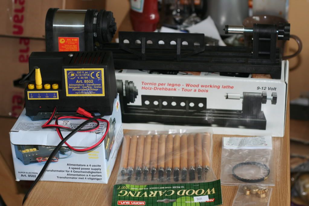

ordered this yesterday,arrived today from www.cornwallmodelboats.co.uk
the whole lot £137.00
#2 Posted : 29 September 2010 14:25:12
I would be interested if anyone has this model? and opinions would be welcome.

So you've got yourself a lathe now you'll find it great for making small turnings only 200mm between centre but you can use longer dowels in by fitting through the centre of the chuck upto 10mm so you should be OK!. As you can do your spares in two stages.
Keep your tools sharp use a Diamond File Set or an Oilstone, practice makes perfect so have fun Karl. LOL
ThumpUp Darron
#4 Posted : 29 September 2010 16:00:45
thanks darren,had a little go,this can take dowel up to 12mm.the chuck jaws can be reversed and then takes up to 74mm.wood pieces.the chisels are crap,gonna get some decent ones.have got diamond sharpener so thinks I only need chisel's

Got this lathe a while back,bit noisy & I had to spray the chuck adjuster with wd40 as it gets very tight when reversing jaws...had huge blisters where it rubbed my fingers!!All in all not a bad little tool.I bought these chisels http://cgi.ebay.co.uk/ws...m&item=180526718628 ..cheap but really sharp..as I found out to my cost when I put one down & then went & leaned on it......ouch!!

It having a 12-volt motor makes it limited on torque power, don't lean on it too hard as it may jam thus damaging your work.

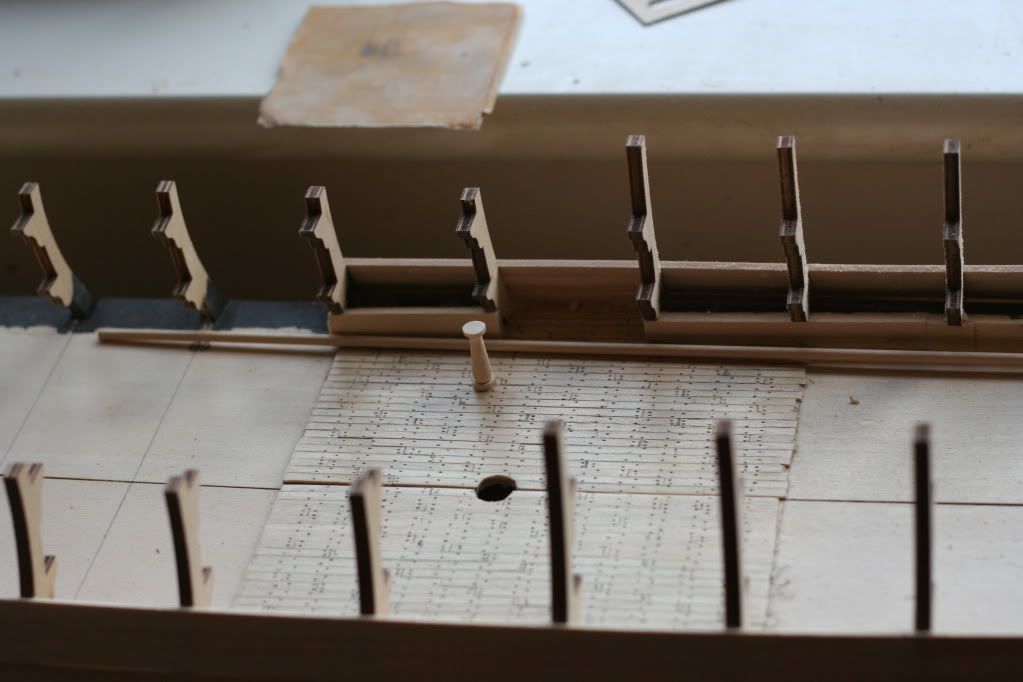

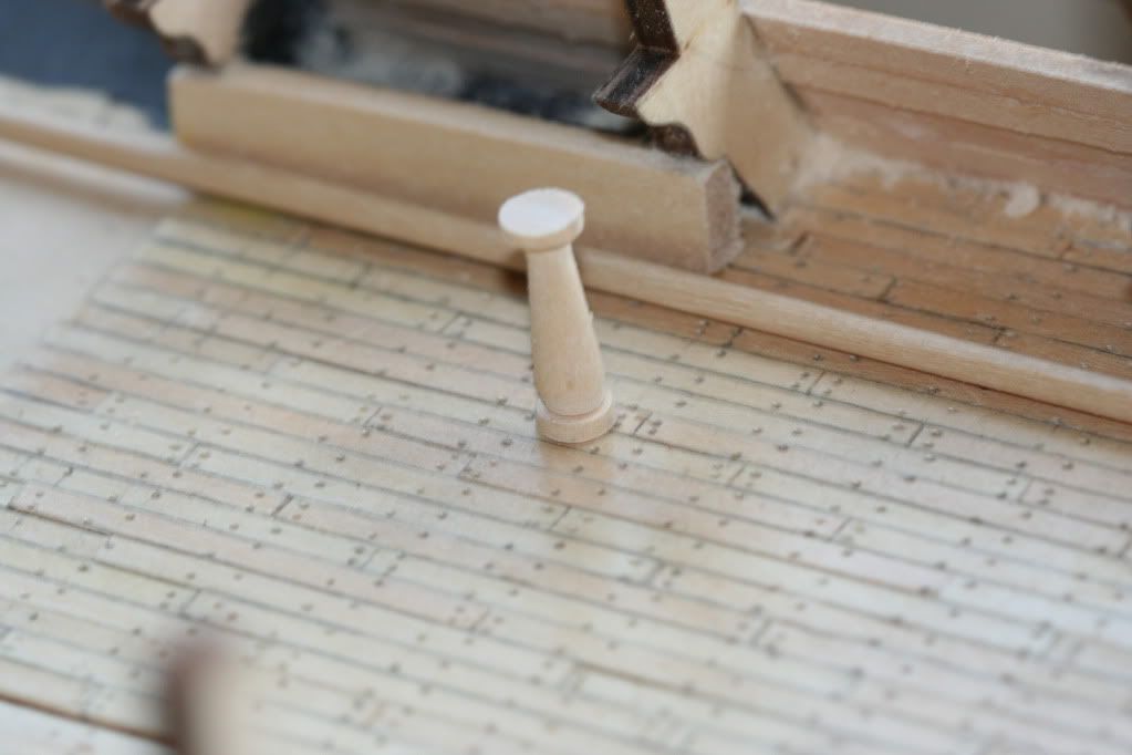

this is the pattern i'm going to use on victory,the pillars will be seen by the cutoutsection.
#14 Posted : 30 September 2010 17:50:55
I made it out of 6mm. dowel. stands 20mm high.

hi wilffy,I bought a cheap set and yes I had to rehone them,but also have ordered a good set.funnily enough they are proxxon. have had a setback with my lathe,the motor drive shaft is spinning up,so the gearwheel that drives the chuck,is motionless,so sending it back.
