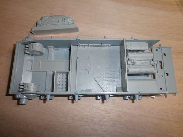

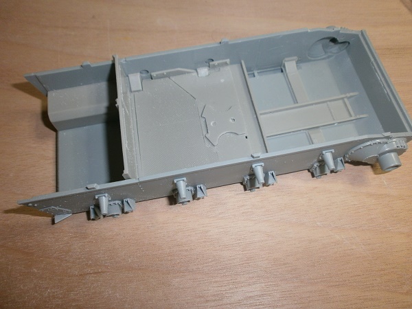

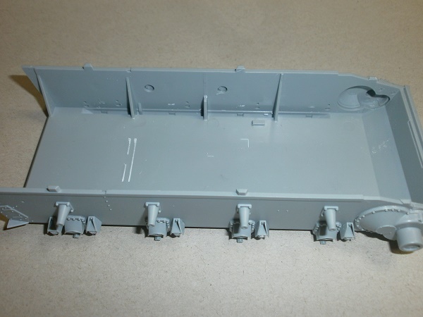

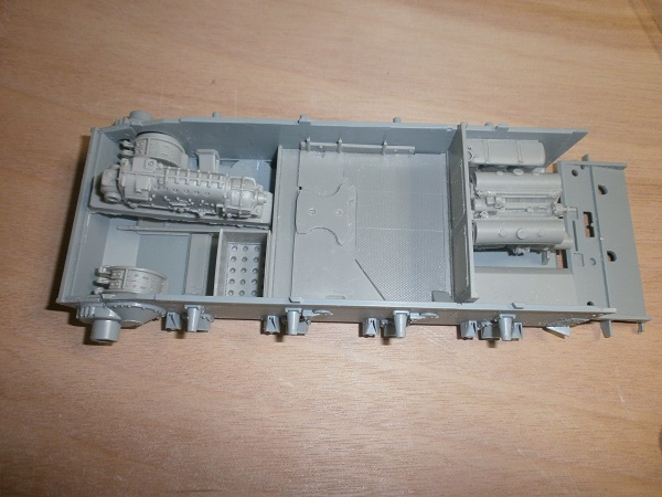

Before the build starts their will be a lot of preparation for the fitting of all the three resin interiors. Firstly the outer hull components with tabs or parts that stick into the inner hull were assembled onto the hull, next any moulded fillets on the inside of the hull were removed along with any moulded guide lines, studs including any protusion's from fitted parts, see pics.
Next it was to prepare all the base resin parts for each section and fit them starting with the drivers compartment then the fighting compartment and finally the engine bay. As you can see it all fits perfectly as i expected as there all from the same company. Non of the components have been attached as yet as this is a dry fitting to see where filler needs to go ,if you look closely you can see the black pen lines. The last pics show more parts dry fitted to give an idea on how busy the interior will be. More soon.

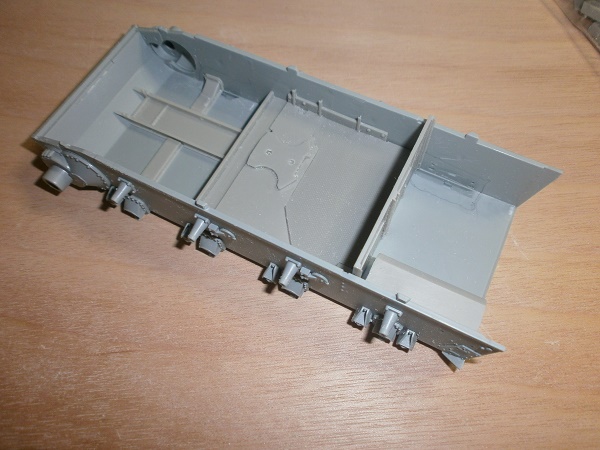

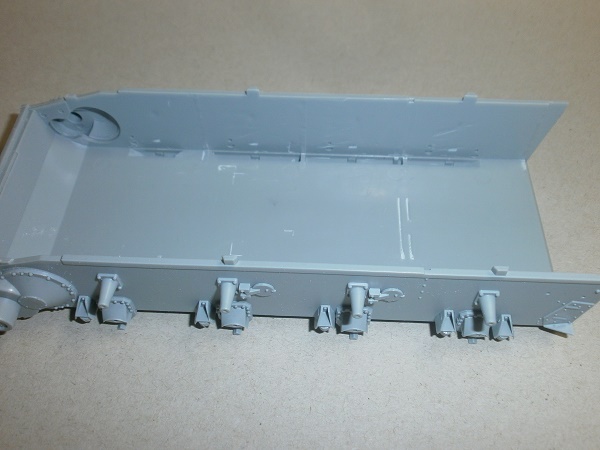

Thanks for looking in and your comments everyone, the appropriate filler has now been applied to where its needed and is being left to dry. The CMK resin products I have always found to be of excellent quality and have high detail another resin manufacturer I think are very good are Legend.
