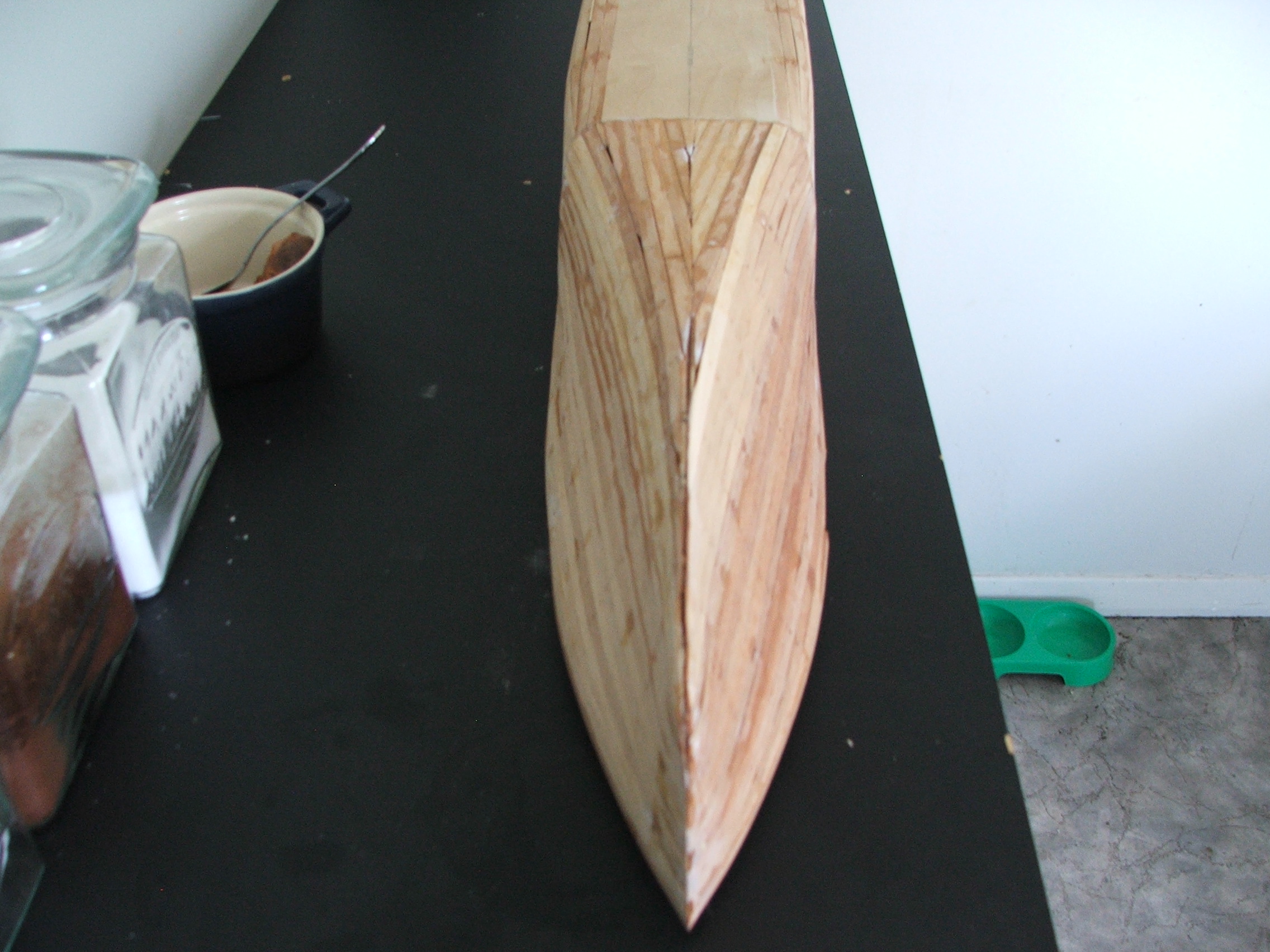

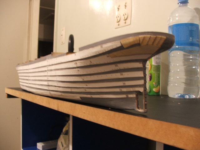

Hi all. Here is the first updates of my rebuild. The hull planking first layer has been completed. Next will be filling and sanding to give her a nice smooth finish before the second layer of planking goes on. More updates soon.

I have now done the first layer of filler on the hull. It looks Horrendous at the moment but once it is sanded down and has its first coat of primer, any holes will be redone and it will get there.

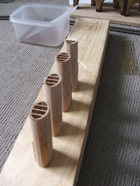

While the Hull filler is drying off, the funnels are underway. Just need final filling, sanding, & painting.

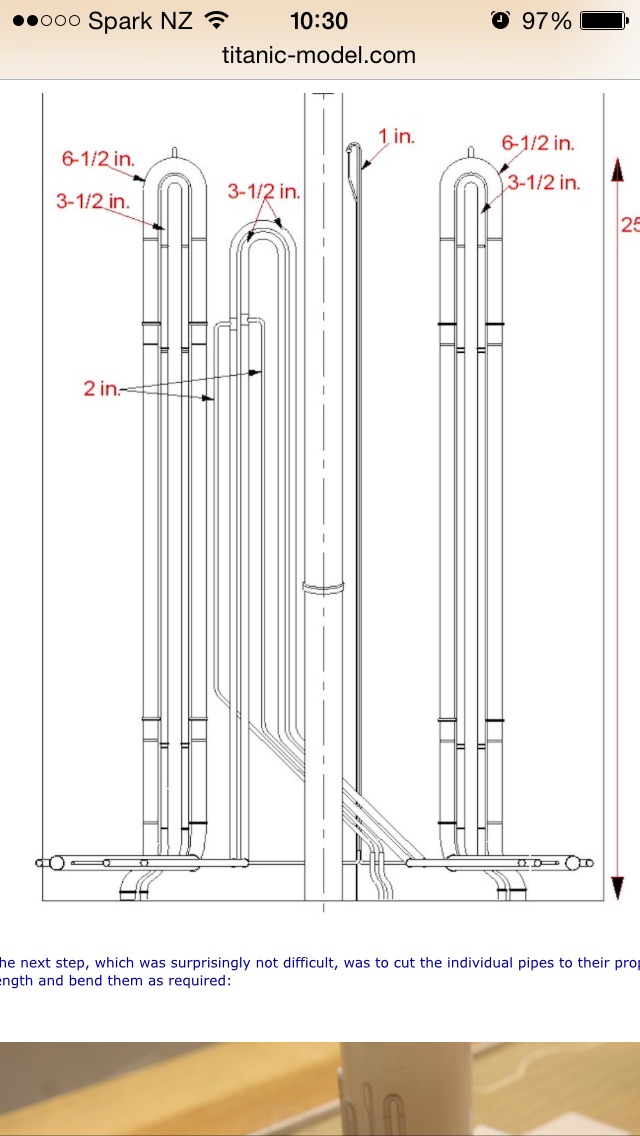

So I will be doing a few modifications to the funnel piping on Funnel 3. I've added a photo that shows the correct piping layout so I will be adding this to my funnel shortly. Picture belongs to Art Braunschweiger I believe.

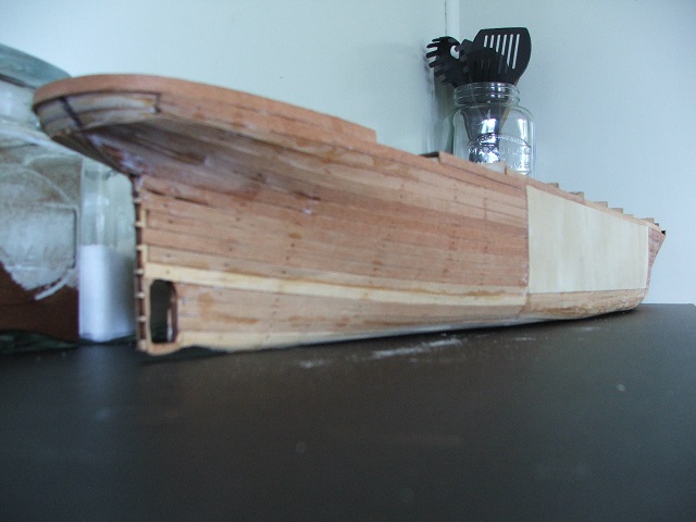

Here is the latest update. The port side of the hull has now had its second layer of plating applied and i just need to drill the portholes on this side. Starboard side will begin shortly.

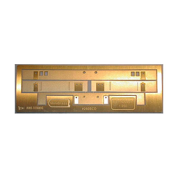

So i have ordered my first etched parts for the Titanic. The forward C deck parts, aft C deck parts, and the Bow & Stern profile pieces.
