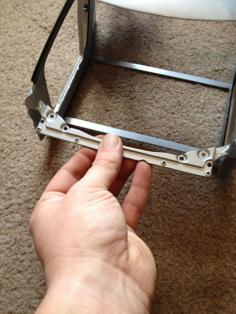

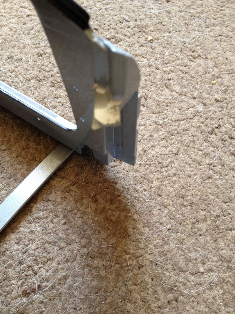

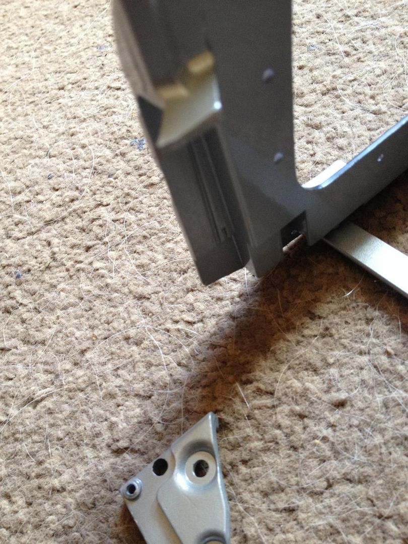

Ok got Nissan gtr body shell on eBay. bloke has now gone it's damage I need some ideas on how to fix the bar at front is broken off not happy at all. Ok here are pics
Facebook-model maker
#2 Posted : 06 March 2015 15:29:51
Perhaps something like liquid metal weld to fix, would need to be fairly strong as that is the main joining point between the front and back body parts. Although if you are careful while assembling the rest of the parts onto the rear body then the strength would come once the body parts are secured to the chasis.
Can you not open an eBay dispute?

Thank u will give it a go hope it holds.
