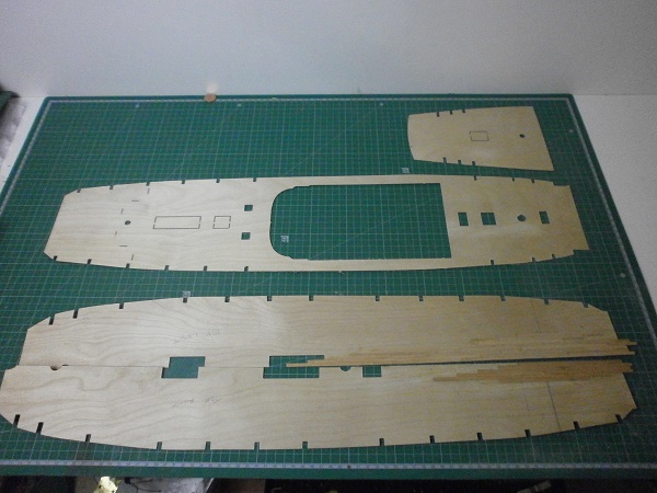

This will be the build diary of this ship that received 11 battle honours in her 30 year service with the Navy and of all the ships Nelson sailed on she was always his favorite and to quote Nelson as the Agamemnon hove into view captained by nelsons friend Sir Edward Berry at the battle of Trafalgar ' Here comes that dam fool Berry! Now we shall have a battle'.
This is a Kit I have had my eye on for a while now and hopefully will do it the justice it deserves.

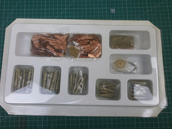

I did not receive the kit from new but one that had been started and then stored for a few years, the Hull had been made up with all the formers and the lower deck added and had been stored in its dry dock and after a good check over had suffered no warping or twisting and is as good as the day she was put together, a couple of the ribs have been broken but are all present and will be refitted when the decks are added as the mode of build is to plank the decks and fit them to the hull before the first lime wood planking is done. The rest of the kit in a very sturdy cardboard box is all present including the instruction book ,9 large plan sheets copper plates for the hull,brass guns lots of cast metal, etch and the usual fittings, rigging cable,Laser cut sheet parts and lastly loads of various hard wood strip the only casualty over time had been the elastic bands holding the different strips together but this was soon sorted.
I have Kieth Juliers book where he describes the building of this ship and should go well with the instructions. This will not be a fast build but one that will reflect the quality of this kit. Right now I am cutting the planks to size for the decks to start this part. I have included a few pic's including the figure head and the three decks. Enjoy because I certainly am Drool Drool Drool . More soon

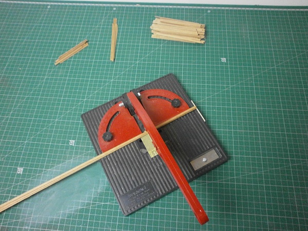

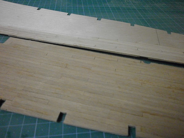

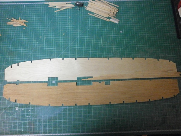

Made a start with the planking of the lower deck, one side is now done and trimmed back, I have then put a coat of Sepia wash watered down 50% on it to high light the plank edges this wash after the trenails are added and the decks are Danish oiled should bring them out nicely.
If you look at the close up pics of the finished half and the one with a few planks at the rear the wash also gives a nice golden colour to the planks which again should look even better after the Danish Oil is used on the decks. More soon.
