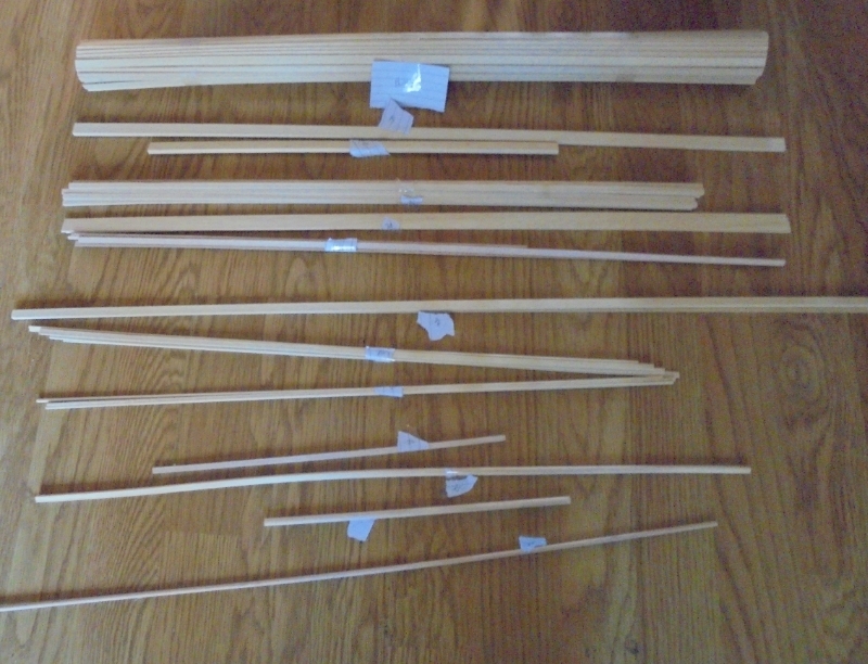

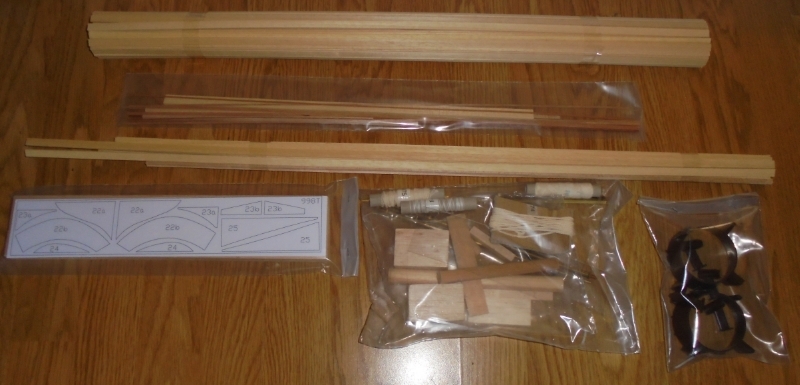

Contents:
I rechecked the contents of the box to familiarise myself with the parts and then sorted the mixed wood lengths and labelled them.
michael.rolph attached the following image(s):

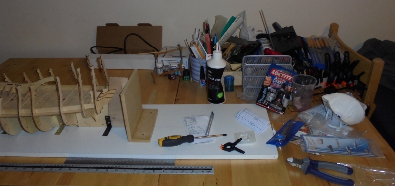

Getting started:
Before I started the build I reviewed my work area and decided it needed some organisation
Picture 1
After a quick trip to IKEA I was able to remove most the clutter from my workspace.
Picture 2-4

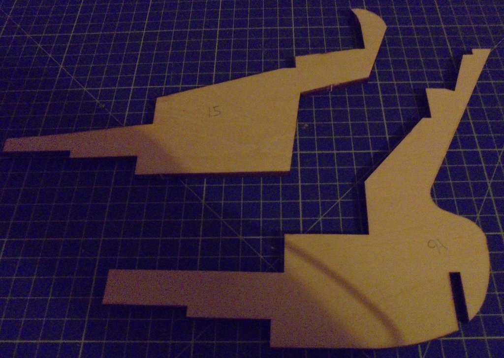

I removed my Sovereign from its jig and stripped out the brackets and removed the end stop. Next I drew the outlines of the bow and stern on a
piece of plyboard and cut them out with a Dremel.
Picture 5-6

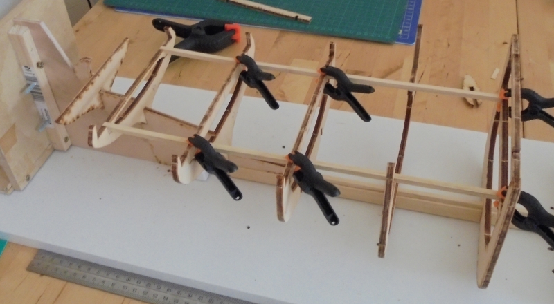

Keel:
The bow and stern were connected using two lengths of wood and kept under pressure to avoid warping, once dry two extra pieces were added to the
sides and held in place with clamps. Once dry the keel was fitted into the jig and fixing blocks used to keep it in line.
Picture 1
Some of the bulkheads are lower than the guide jig so I had to use a offcut of MDF to lower the jig.
Picture 2

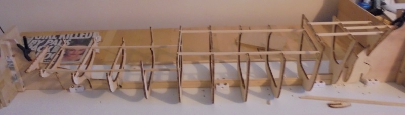

I started adding the remaining frame to keel, the middle block of frames are separated by 77 mm spacers
Picture 1
The deck support beams were added once the frames were dry
Picture 2
The front most frame required trimming so it sat correctly on the keel
Picture 3

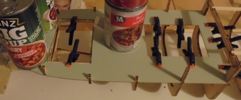

Rear deck:
The rear deck was painted using Humbrol no. 23 (duck egg blue) and attached it to the frame using soup tins to apply pressure
Picture 1
Picture 2
After a few minutes I realised that I had missed a piece out from the rear of the ship, I removed the deck added the missing piece and reattached the deck.
Picture 3

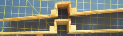

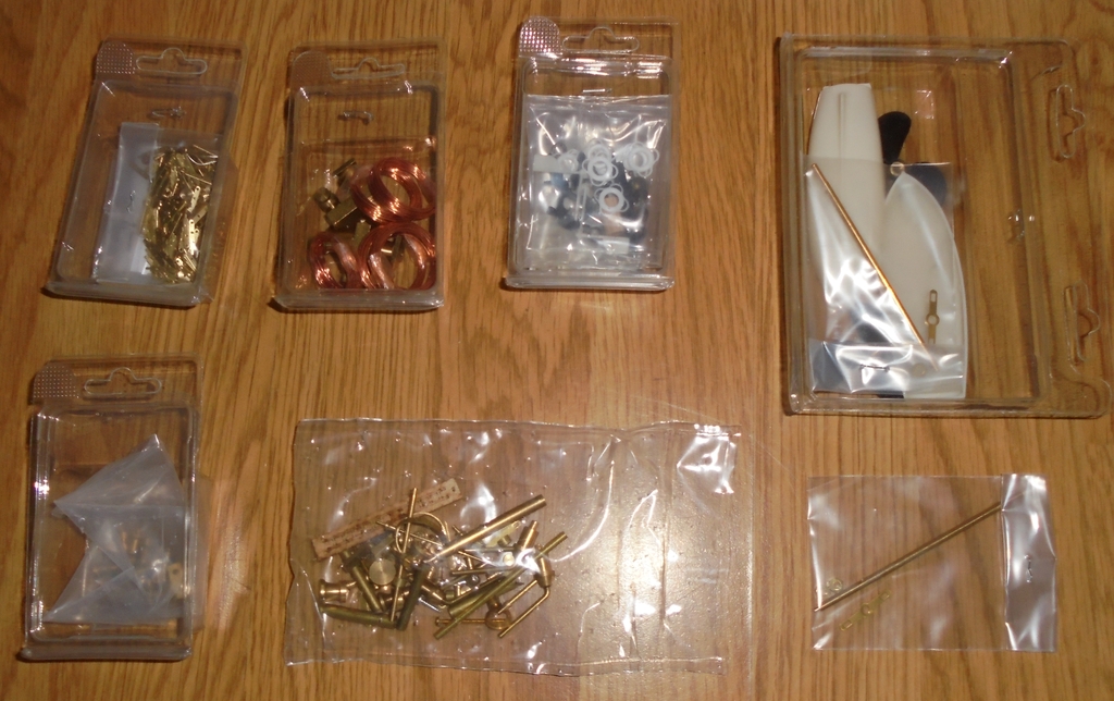

Rear cabin entrance:

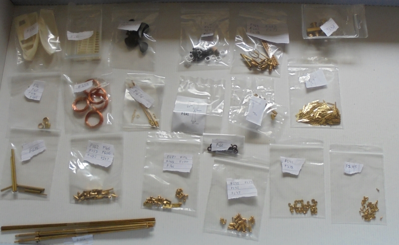

The first step was to sort the bags of fitting in order to find two portholes require for the doors. The fittings were separated into ziploc bags and labelled so I can find the correct components easily
Picture 1
I removed the require sections and cleaned up the charing from the edges
Picture 2
Once assembled it was painted with Humbrol no. 24 (Tan) and attached to the frame
Picture 3-4

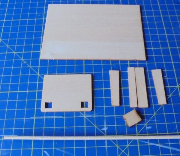

A small bit of progress made today.

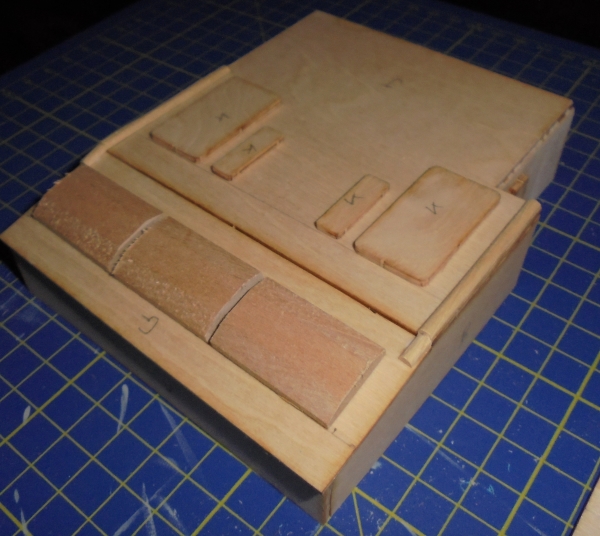

Deck structures:
The deck components required some of the stock to be rounded, the stock was clamped to a mdf board to and rounded with a emery board.
Picture 1
The pieces were identified, removed and cleaned up.
Picture 2
The hatch and storage bins needs a bit of cleanup work with some wood filler before painting
Picture 3-4

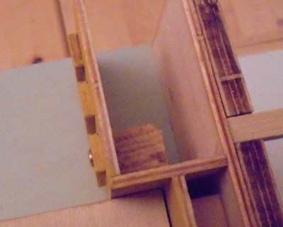

Just a small update.
Second Deck
After test fitting the next deck I discovered a problem with the alignment of the cabin doors. The edge of the cabin overlapped the stair hole of the above deck. This was caused by the incorrect assembly of the cabin components, the front components should have been attached to the wall at the back rather than the side.
Picture 1-2
The misalignment meant that the ladder would not fit in the gap, rather than try and remove the cabin components I decided that I would trim the ladder to fit.
Picture 3-4
