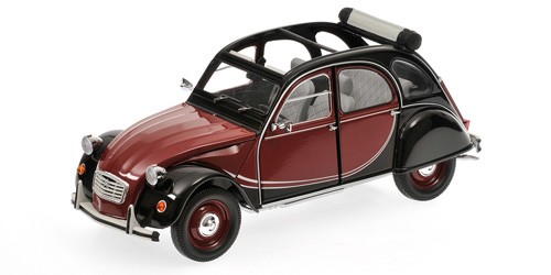

Looks a nice model of an interesting and strangely iconic car. Love that colour scheme too, very nice, though I think I'd prefer a darker interior maybe as the pale blue/grey looks a bit odd against the maroon/black bodywork?
I'll be watching this build with interest. Cool ThumpUp

Oh, that's the prototype model up above. The seats in the actual model will look very different. In fact the seats are a special object of pride in this model. I don't want to give away too much yet, especially as I don't have the parts yet myself, but building the seats will get very interesting indeed.
