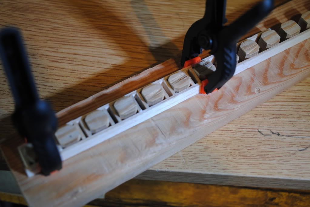

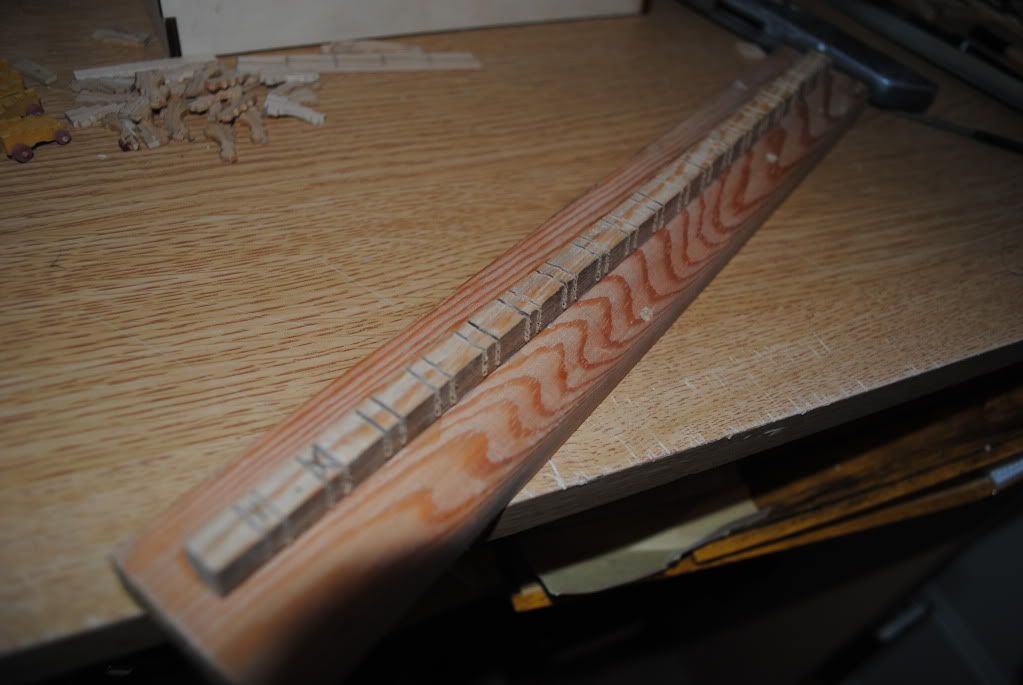

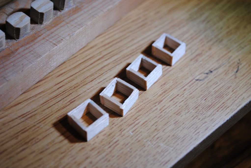

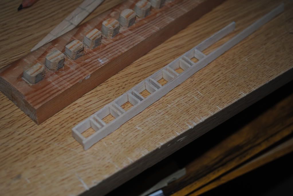

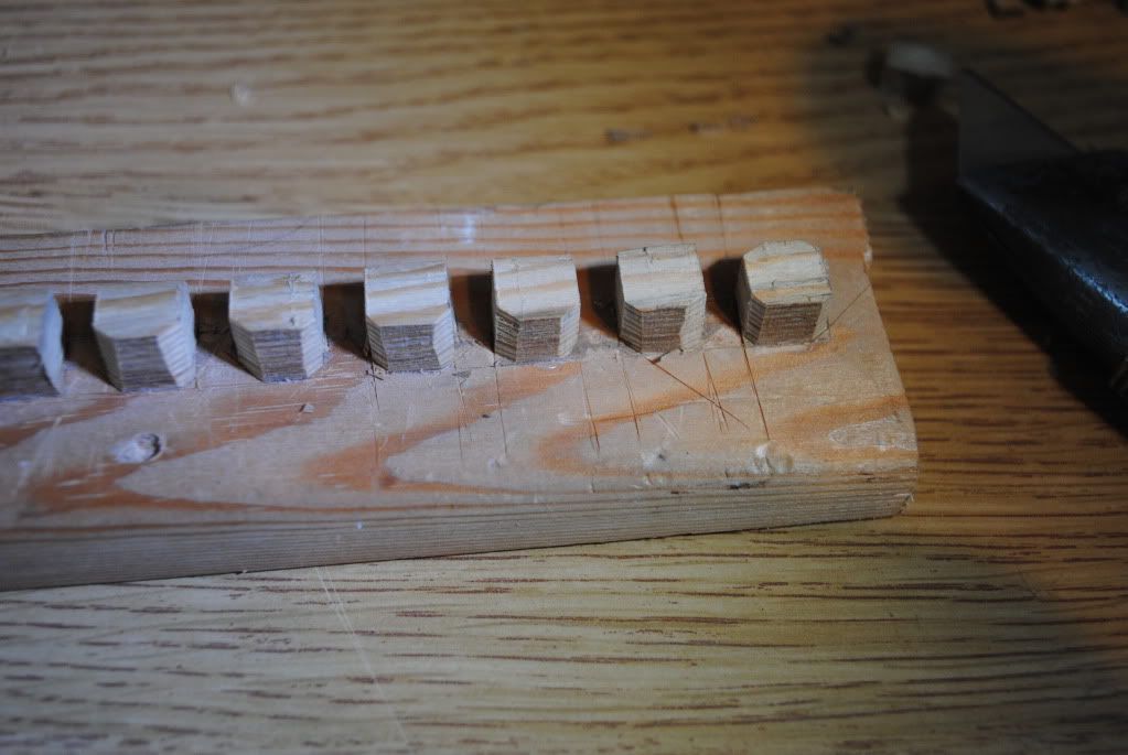

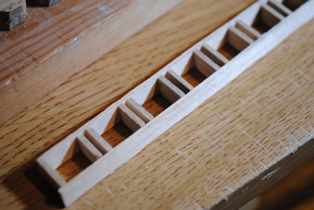

Could save a bit of boring monotonous work by mass producing the 'gun ports', I don't have the correct size wood for the ports so used what I have for a practice! I had some 10mm square section, glued it to a a piece of wood and cut gaps leaving 10x10mm squares, I found that they were too high but rather than try and cut them down I'll just use some packing so that the frames are not at the base of the squares, it will also make it easier to get the frames off the jig.
Anyway, just an idea you may want to try!
It wont be long before we start these.
Jeff
