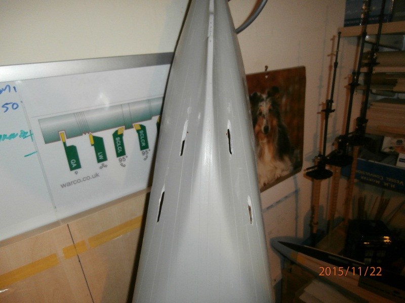

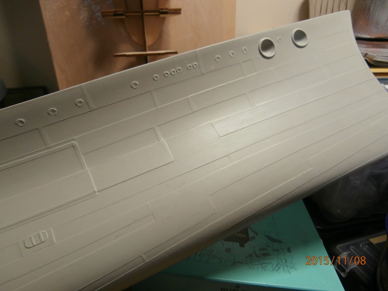

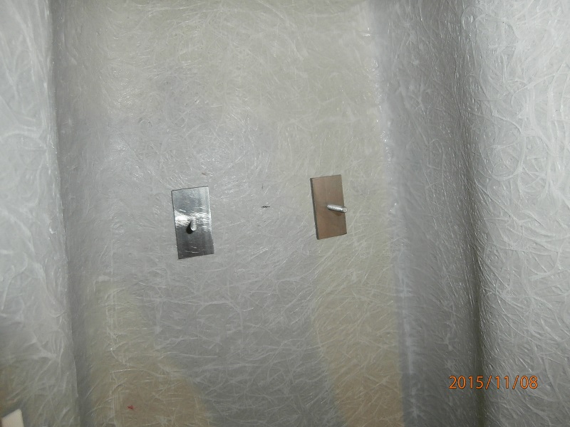

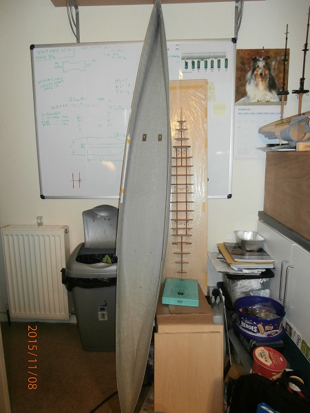

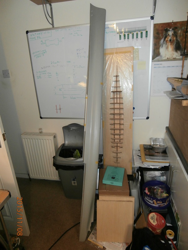

The hull is approx 2040mm long and 220mm beam and has all the plating detail moulded into it, pics 1,2 & 3. Some of the surface detail, such as portholes, will be removed and replaced.

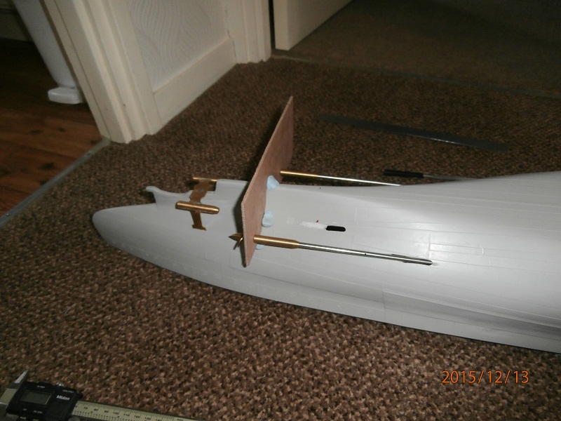

I have marked and drilled 4 4mm holes in the base of the hull and glued steel plates (which have drilled and tapped to to take M4 screws) to the inside to which brass pedestals will be attached for display purposes, pic 4.

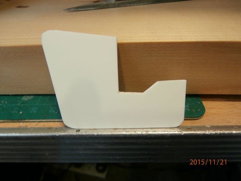

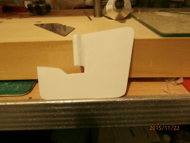

I have started to make the rudder. I first cut 2 pieces of 1mm thick plastic sheet to the correct shape and glued them together, pic 1. I then glued on a piece of 4.8mm plastic tube to act as the rudder post and then glued a piece of 0.25mm plastic sheet to each side of the rudder to bring it to the correct thickness and overlapping the rudder post to reinforce it, pic 2. The rudder will be sanded to shape once fully dry. I will fix it to the hull by drilling a hole through the hull and lower fixing point and then passing a plastic rod through the hull and rudder.

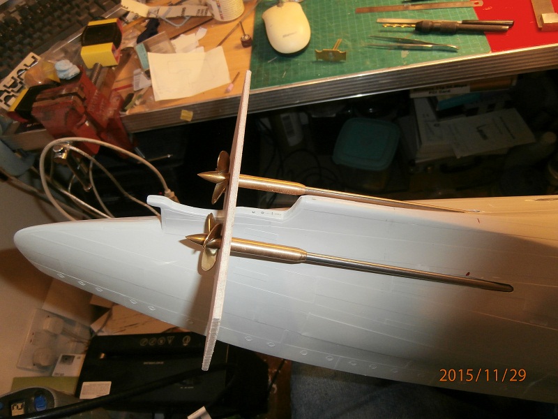

I have also started cutting the ahull access for the prop shafts, pic 3. It looks a bit messy at the moment but once the bulges around the hull entry bearings are made and fitted it will be fine.
I did make the the prop shafts a while ago from 5mm stainless steel rod but i have since found that 2 of these are too short so will have to redo them but I can use the other 2 to position and make the 'A' frame support bearings.
Getting away from the hull I have also started to make the 4" gun ready lockers, of which there are many. I made 2 lockers from plastic sheet, strip and brass wire (each having about 30 component parts)Pic 4.

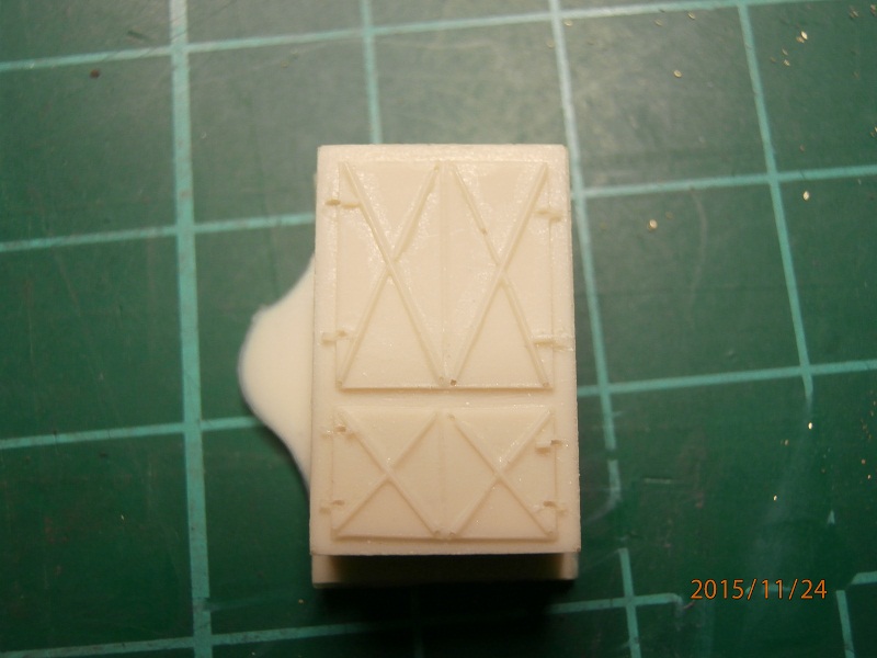

I then made a silicone mould of these (my first attempt at this) and then cast more lockers in resin. Pic 5 shows one of the first lockers cast, not too bad for a first attempt, only a few small pinholes. The resin I was using only had a 90 second pot life so it didn't allow much time to get into all the fine detail. I have since ordered different resin with a 3 minute pot life which should make life easier.

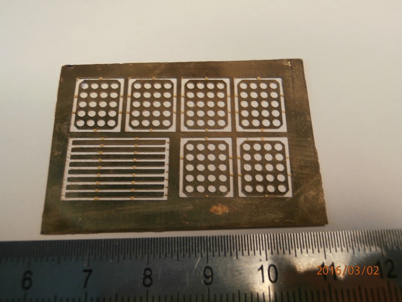

I have also had a go at making my own photoetch parts for the UP launchers framework, the barrels will be brass tube from Albion alloys and the mounts will be made from sheet plastic. I did the artwork for the fret on Google sketchup and followed instructions found on the internet for producing the etch brass. It took a couple of attempts to get the UV resist to sit on the brass with no air bubbles between the brass and resist and Pic 7 & 8 show the result of my first go at etching.
