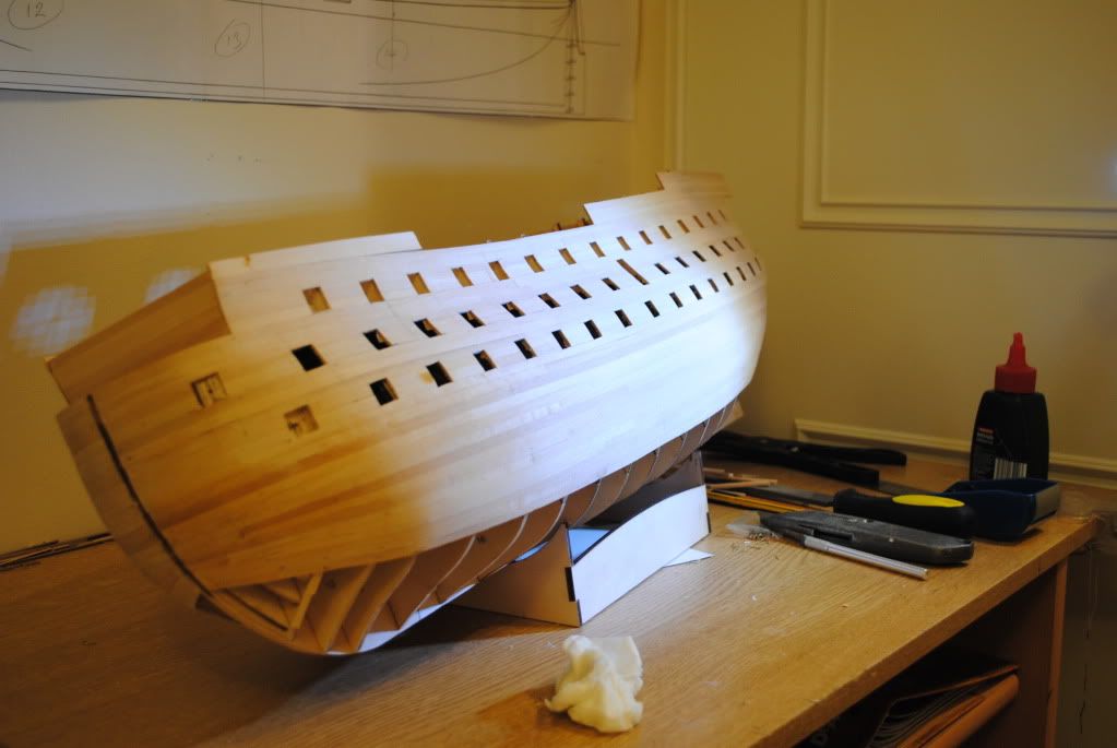

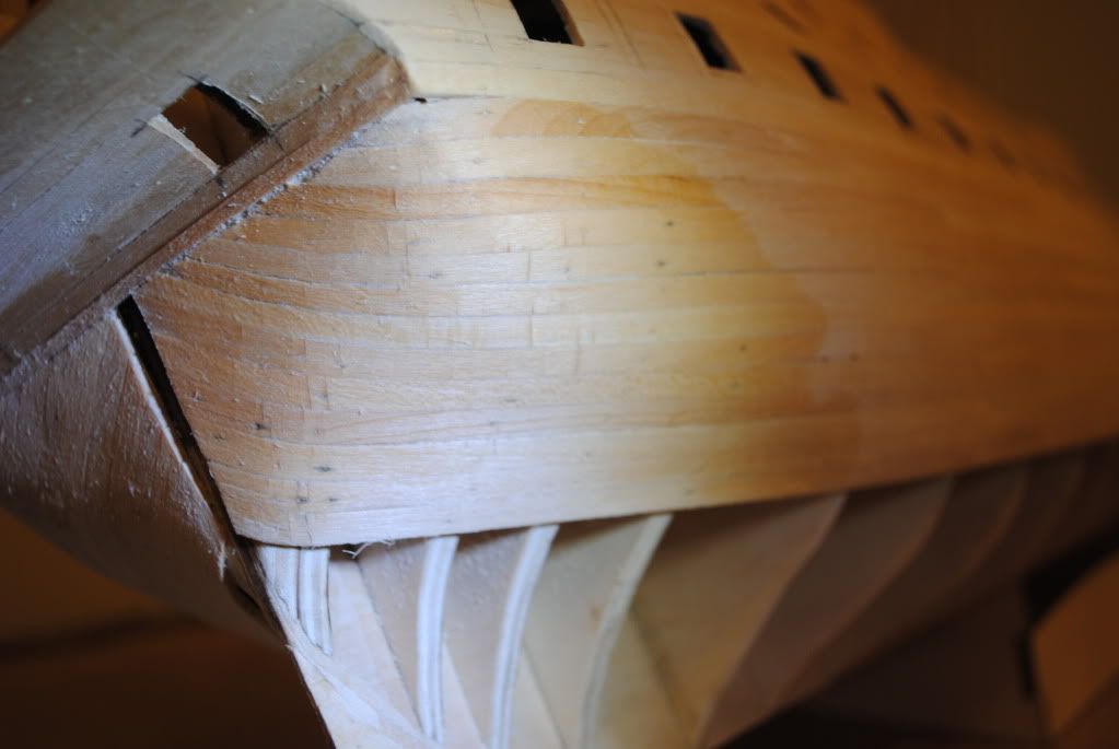

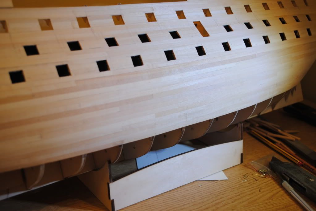

I'm a bit further ahead than Tomick with the planking due to the extra delivery of planking, I've used all the extra planking and sanded it down, from a distance it looks fine, but looking closer there are lots of 'cracks' which appear to have been caused by the 'plank bender' (suplied with the kit), all my planks were shaped and soaked before bending, I may have over done the sanding but the sections where I did not use the p/bender are fine.
I'm not too bothered because I'm second planking and it won't be visible, I just thought that anyone varnishing this planking may be diapointed with the finish and could need an alternative way of bending, thinking back I could probably have managed without the bender!
Here's some pic's so you can see what I mean, but one question before I go on second planking, what's the best glue to use? (vineer is 1/2 x 4mm).

jeff averre ,hi,did you reverse the blade in the bender?using the blunt end?I used the sharp end and I kept snipping the plank into pieces,when I used the blunt side all was ok.
#7 Posted : 20 November 2010 11:43:00
Correct its the blunt edge for bending.

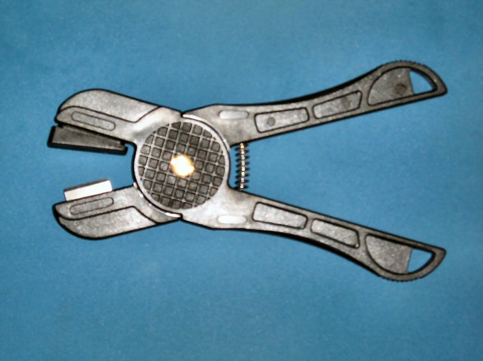

#9 Posted : 20 November 2010 11:49:19
Use which ever method suits you best.
Son of Bulwark
#10 Posted : 20 November 2010 11:49:46
z8000783 wrote:
What does "plank bender supplied with the kit" mean? I haven't received one, I don't think.
John
This John!

It's is possible that the wood was allowed to dry out too quickly? just a thought.

The sharp or blade side is designed to cut planks, the blunt side of the blade designed to nip planks for bending.

Thats it then! I was using the sharp side of the blade (the way it came), I never picked up on it being turned round, I've never used one of these plank benders before and as far as this kit is concerned I probably won't need it again as the remaining bends are not too tight.
I don't know why there is a sharp side, I would'nt dream of cutting a plank with it!
