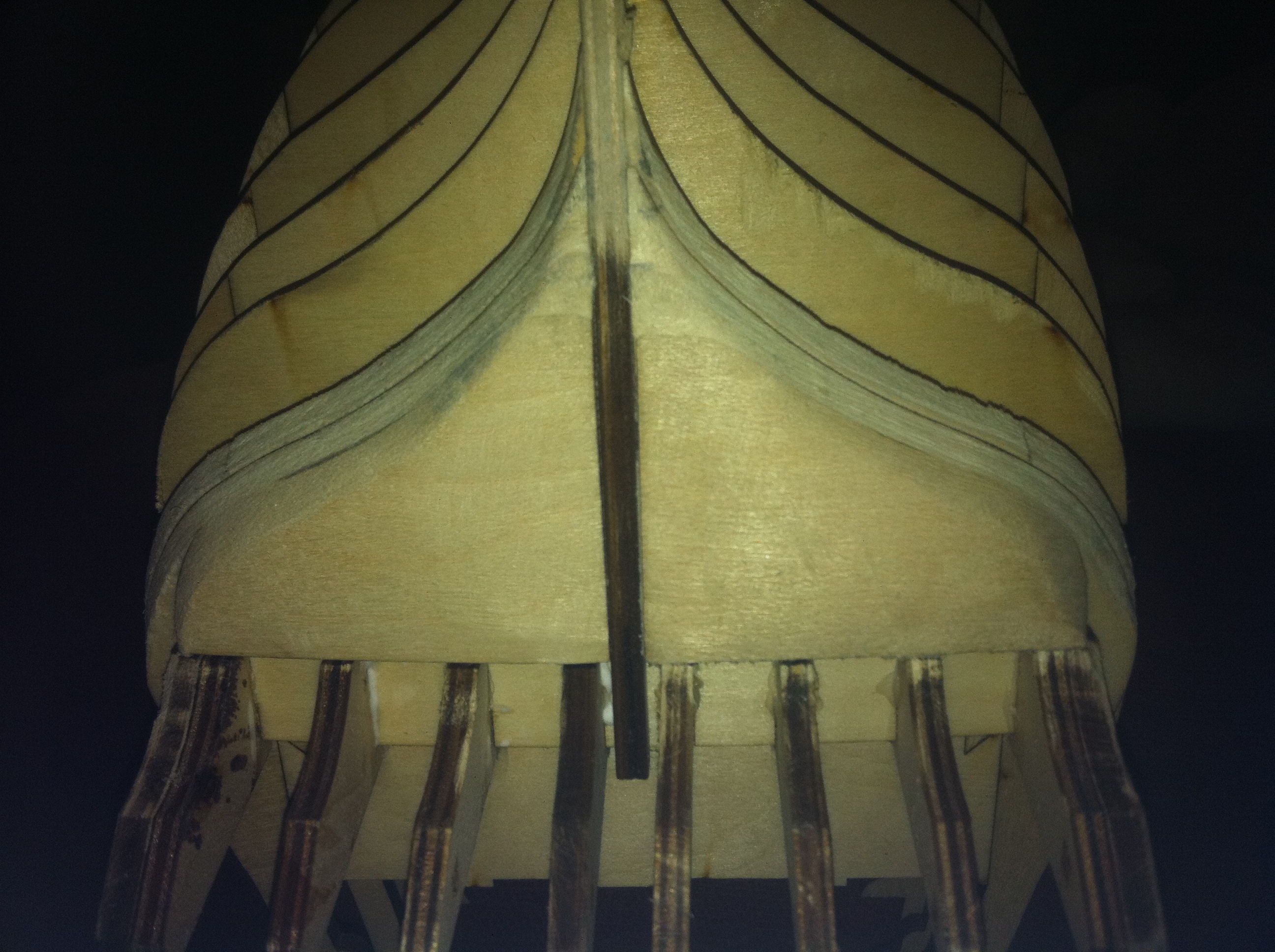

came u guys tell me if this is ok please

I think you may need more on that last frame, the planks have to bend around it, if you dont fair it enough it will make a sharp bend.
And looking further back you need quite a lot more on the other frames.
Try and lay a plank across the frames to check, do a search here for 'fairing the Hull'

Just to add to colins advice it is hard to see at that angle but make sure that the transom is flush with the false keel, the bottoms of parts 34 are almost removed completely when it is flush to the keel and should be flush all the way up the transom. When you start to scratch the keel between the transom you have it right, you need to shape the ribs more as well.
If your uncertain post some picture and we will help you, it is important to get the fairing right.

have to agree with both colin and darron.needs to be flat up against the false keel,
but looking tidy and neat build,well done.

What's the reason for attaching those two parts 34 in the first place if they have to be sanded away to nothing when fairing the hull? Sorry, that's something that has been on my mind for a while now.

You'll notice that the keel stern post slopes at an angle, the tops of the 34 frame halves sliglty protrude the stern post at the top, whilst at the bottom of the 34 frame halves they sit quite proud hence why they're sanded flush with the stern post, the idea is that by adding the frame 34 halves they pack out the angle of the stern post as it slopes downward.
#7 Posted : 05 December 2010 15:10:58
Hi there daffy09, I am sure that it helps to give that extra bulk in forming the shape od the stern below the transom, and that when it comes to planking, there will not be too much of a sharp curve for the planks...I believe that I have got this right and explained this correctly. perhaps our fellow shipmates will explain it more clearly than I??? Hope you are enjoying your build mate...
