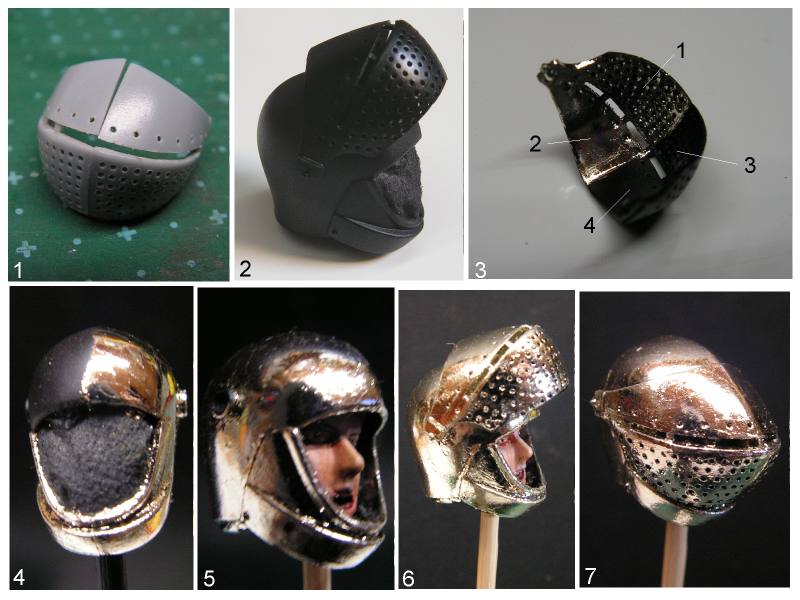

Photo 1 shows the two halves of Frederick’s helm with the inside painted with Humbrol’s Metal Cote ‘Polished Steel’. As you can see here, the polished steel is not exactly ‘Knight in Shining Armour’! I had tried a couple of experiments on the finished model knight with mixing the Polished Steel with my decades old original tin of Polished Aluminium. In actual fact that did work quite well and lightened the overall colour quite considerably. In the end though I decided to try a completely new technique spurred on by the excellent results obtained by KPNuts and his gold leafing and Kev (Modelmania) and his kitchen foiled Mustang! What I did was to send off to China via Ebay for a set of Silver Leaf sheets (get it from China and you can get it for less than half the price of UK suppliers, you just have to allow for about a month for it to arrive!) Fortunately, I’ve been planning on starting this model for a while and I sent off for the leaf just before Christmas knowing it wouldn’t arrive until after the start of 2016! This is a fantastically economic material, it comes in sheets of about (oh, hang on I’ll measure it properly) - three and a quarter inches square, and cost less than £4 for fifty sheets, less than eight pence a sheet!
The one I’ve got is called ‘Antique Silver’ and gives a slightly duller effect than plain ‘silver silver’ if you get what I mean! I did wonder if the antique effect would be enough to simulate steel without any further additions but unfortunately the answer was no – it was still too shiny for steel on its own.
Photo 2 illustrates the previously painted and polished Metal Cote after the application of the ‘Size’ the thin liquid ‘varnish’ used to glue the leaf in place. This is an acrylic size so the brushes simply wash out in water, this I did buy from a UK Ebay source – I waited for the leaf to arrive before I sent for the Size, even then, at less than a fiver for a 25ml bottle it was still far cheaper than trying the local craft suppliers down here. Larger amounts are available but this model is a trial of the whole gilding technique so I started off small!BigGrin The object is to apply a thin coat whilst avoiding any brush strokes as it dries. The silver leaf is only a few microns thick (millionths of a mm!) and it can even pick up the ripples from brush strokes if you’re not careful. The size has to be left for a minimum of fifteen minutes after which it is ready to take the leaf (becomes sticky), according to the instruction sheet the size remains useable for up to twenty four hours but I can’t swear to this as I’ve never waited that long!Blink
In Photo 3 the Antique Silver leaf has been applied to the insides of the helm. This taught me the first useful lesson – always try to cover the area in one piece – the right hand side was (virtually) a single piece of leaf whilst the left hand side was made up from the bits, which came away from the single cut down section. As I was to discover, not a good idea – which of course is why I’m experimenting on the inside of the helm first! (I had by now already tried the technique on the other knight figure with good results, but more of that at a later date.) What appears to be a hole in the back of the left hand helm is an optical illusion – it’s actually a reflection of the green cutting mat through the open front coming off the mirror surface!
In Photo 4 you may or may not see a slight difference in the ‘sheen’ of the silver leaf. This is after a single coat of the secret addition – a thinned down solution of the Humbrol spirit based Blue-Grey Enamel Wash. This is the wash I bought to do the panel lines on the undersides of the Spitfires and Hurricane in the Scramble diorama. By experimenting on the other knight figure I discovered that two to three coats of this wash applied as a varnish over the bare silver leaf tones down the overly bright silver and leaves a lovely ‘blue steel’ effect. As I mentioned, this first look at it doesn’t do the effect justice but you’ll see the full effect at a later stage I hope! This is where I learnt the disadvantage of applying the leaf in small bits, compare the left and right inner faces of the helm and you’ll notice the right hand one has lots of darker ‘squiggles’ almost like cracks in the steel. This is where the little bits of silver leaf come together – unnoticeable in the basic finish but the enamel wash follows the lines just as though it was a panel line (which is of course exactly what the wash was designed to do!)Blink This was a useful lesson though, when I get on to the full armour I’ll need to try and gild each separate piece as a single application, this is what I did on the other guinea pig knight and it worked really well.
Photo 6 illustrates Frederick finally into his helm, which has been glued together, left overnight and then sanded smooth along the joints. See what I mean about all that hard work hidden away! The next task will be to give the helm a coat of spray primer (preferably without turning Frederick grey in the process!) so the next actual job was to mask his face up with a couple small pieces of folded loo paper! A small square was folded over and inserted up into the small gap under the chin. Using thin pointed tweezers, this tissue paper was then gently pulled up through the front of the helm until there was enough to carefully prod it into place around his face with the cocktail stick. Once in position a double check was made to ensure no tissue was overlying the rim of the helm which would prevent the primer coming next. The inside of the hollow head is still accessible however to allow the bamboo skewer to hold the assembly for spraying.
The next upgrade is applied to the other part of the helm – the visor as shown under way in Photo 7. This involves the drilling out of seventy three (I think) holes in each half of the visor, a hundred and forty six in all, and also sawing out the vision slit with an Exacto Razor Saw, sanding the resulting gap smooth and then replacing the dividing bars with extremely tiny slivers of styrene strip. (Those bars were probably one of the most irritatingly fiddy tasks so far!) The drilling of the holes was far easier, each one is already moulded in the plastic as a sunken dimple which made starting the pin vice drill easy enough. Once each line of holes was drilled through, the inside was countersunk with a larger drill bit to remove the rough scurf around the hole. You can see the huge difference this makes to the kit parts in Photos 8 and 9 (note the countersinks on the inside of the visor in Photo 9.)
Now comes the horticultural bit – the creation of the garland of hazel leaves which Frederick and his allies used as their medieval IFF device. Photo 10 illustrates the first part of the garland underway, using the same .2mm wire that I employed to create the barbed wire on the Messines diorama. Once again, the core of the design is a double strand of wire, one end secured in the chuck of a pin vice and the other clamped in the mini vice, the pin vice is then rotated around with thumb and forefinger to create a twisted double strand. Onto this core, a series of small ‘branches’ are wound using exactly the same procedure, take a short length of wire, fold it double and clamp the loose ends in the pin vice. Thread the open loop over the core and slide it down to the rough position and then ‘twirl’ the pin vice, tightening up the short length until it is attached to the core. Finally, secure it in place by soldering, applying the solder at the joint and also running it along the core and branch. Eventually, after snipping off the excess protrusions you have a long enough length complete with ‘twigs’ to be able to form it around a circular object roughly the same diameter as Frederick’s helm as shown in Photo 11 and soldering the ends together.
The next part is something I was very pleased with – after scouring Plymouth looking for ready made ‘crafty’ type leaves and coming up empty handed, I had to think up a way to make them myself – the result was not only just what I wanted – it was completely free as well!Cool
Photo 12 shows yet another piece of my Mum’s expired eye ointment tubing, cut open, flattened out and washed off before paint-stripping the tube printing away. This is the same material as used to make the corrugated iron sheets in both Messines and Scramble. I am really getting worried about my stocks of this metal, back in August of last year there must have been a contamination outbreak in the factory which produces this ointment – all the existing stocks were re-called and the date for re-stocking the chemists has been pushed back and back, first it was December, then February and now the latest is April or even June! Poor Mum has had no eye ointment on her prescription for four months (the only alternative has also been withdrawn) and what am I supposed to do for building materials!! (Only kidding Mum!) (Since found out the entire factory had to be stripped down and examined as tiny pieces of black plastic was found around the tube nozzle due to the machine which tightens up the tip doing it too hard!)Blink
Anyhow, as you can see, I’ve cut off a thin strip of the metal the same width as the hazel leaves and this strip has been scored down the middle to form the spine of the leaf, (see close up in the corner). One half of the leaf shape is then scissor cut away and using the reverse side of a modelling knife (the aluminium handled variety), the veins have been scored into the leaf as shown in Photo 13. The hazel leaf has a sawtooth edge to it and the scoring replicates this nicely. This is then repeated on the other side, this part being the most fiddly as there is now almost nothing to hold the leaf down with to score the mirror image of the veins. The final task is to create a little concave ‘dip’ at the fat end of the leaf with a couple of knife cuts, the final appearance is shown in Photo 14, the gold ones are scored side up, the silver ones embossed side up. The finished leaves were then stuck to a piece of masking tape on a coffee spill for grey priming on both sides. I half expected the first grey side to pull away on the masking tape but it went surprisingly well and both sides were soon primed for gluing and painting.
Photo 16 shows the garland after the leaves have been fixed to the twig circle. The garland was first given a couple good coats of Admiralty Wood Brown and once dry, the leaves had a tiny strip of primer scratched off as did the wooden garland before each leaf was attached with a small drop of super glue gel. Photo 16 shows the leaves upper surface painted with Vallejo Medium Olive Green whilst Photo 17 shows the bottom surface still in grey primer after each joint was further re-enforced with a drop of liquid super glue for good measure.
The last two Photos 18 and 19, show the finished garland, in isolation and just balanced on top of the helm, (minus the visor as I was still working on the other half at this stage!) Note the little pale green splodges on the twigs, these are the tiny buds found at every leaf base on the hazel branch, ready to sprout out if the leaf is lost. Apologies for the yellow tinge on these two pics, I didn’t realise until too late I’d switched on the old workroom low wattage light by mistake – all the ‘proper’ photos are taken under a pure white light from a double strip of LEDs stuck across the ceiling!

#19 Posted : 29 February 2016 21:02:22
Posts: 2,090
Points: 6,265
Carrying on with the visor, once all those ventilation holes had been drilled out it was time to glue the two halves of the thing together. Because a certain amount of the plastic had been removed with the opening up of the vision slit, I couldn’t be certain that the two halves would fit exactly back together. The easiest solution was to glue the bottom part together as shown in Photo 1, give it twenty four hours to dry completely and then glue the top section, keeping the top together by finger pressure until the liquid poly had set sufficiently to keep the joint in place. This worked well although as you’ll see later, I had to repeat the whole process a few days later!Crying
Once the visor was set and the joint sanded smooth, both it and the previously grey primered helm were given a second aerosol coat of matt black – again the Poundland car spray range. Although it’s called Matt Black, this one does have quite a sheen to it as you can probably see in Photo 2. Still, it does cover nicely and gives a good definition to the moulded details as you can see here.
Now came the delicate part with the covering of the Antique Silver Leaf. The inside of the visor was tackled first, being done in four sections as shown by the 1-4 in Photo 3. In this pic, sections 1 and 2 show up well against the remaining black finish with sections 3 and 4 applied straight after the photo was taken. Photo 4 illustrates the main helm’s gilding underway. This was done in three stages; the chin section came first, performed with a single piece of silver leaf followed by the left hand side of the helm shown here (the size was applied following the centre line) and when that side was on and smoothed down, the right hand side was sized and then gilded, each half being a single piece of leaf again.
Photo 5 shows the entire helm covered with the leaf and the tissue paper masking removed to reveal Frederick’s un-sullied face back again and Photos 6 and 7 show the completed helm with the finished visor clipped in place. The outer part of the visor was gilded in two parts; the lower area with the ventilation holes followed by the upper section with the vision slit, each part being a single piece of leaf again. Almost all of those tiny little holes have been duplicated perfectly in the leaf, out of almost a hundred and eighty holes, only about half a dozen needed to be re-done with a sewing needle to push through the leaf (in every case it was the liquid size which blocked the hole, not the actual silver leaf).
Now came the experimental part of the process – reducing the bright silver of the leaf to produce a more life like ‘steel’ effect. In this instance, the effect was achieved with a single application of the Humbrol Blue-Grey Enamel Wash. I applied it a little more thickly than before using my bestist softest haired brush (I must get some more of them before long!) and then almost ‘lacquered’ the wash over the leaf, allowing it to collect in the crevices to produce its own shadowing. Hopefully, if you compare the finish in Photos 6 and 7 with the washed/lacquered/varnished helm shown in Photo 8 you can see how the bright silver has taken on a more subtle ‘blue steel’ appearance. This method has one main drawback – once the enamel wash is applied over the silver leaf it takes literally weeks to dry completely (well, about ten days at least)Blink . This led to a near disaster in the case of the finished helm. To try and speed up the drying I left Frederick stuck on the end of a cocktail stick held in the helping hands gizmo over the edge of the radiator on the top landing – unfortunately not telling my Mum why it was there! I came home after it had been there for about four days to find the entire window and radiator shelf bare. After I stopped screaming I enquired as to the location of the thing I had been working on for the last three weeks to be told “Oh I’ve cleaned up the top window, everything that was there I’ve put in that box”. So there, in the bottom of the box with all the other items (some quite heavy) on top was Frederick! The varnish was almost dry so there wasn’t too much damage in that department but when I tried to get the visor off to fit the hazel garland the darned thing snapped in half down the joint! It went back together again but the top section needed to be re-sanded down which required a whole new layer of leaf and wash (and then drying time of course!)Crying The moral is obviously let your Mum know what you’re doing (and then tell her not to touch!!)BigGrin
In the next instalment, beginning the first alterations to the torso halves.
Until then, Happy (uninterrupted) Modelling to you All!Blink
Robin.
