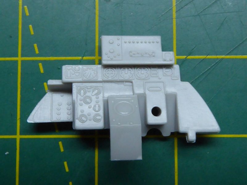

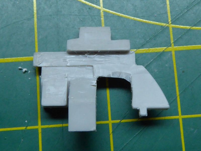

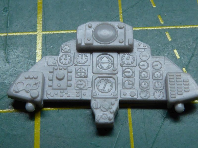

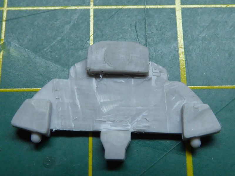

#16 Posted : 21 April 2016 20:45:47
I thought it was about time I got this started.
I have now moved the model from out of the garage into the spare room although the spray booth is still in the garage until I get the time to sort the model room properly.
I've started with the cockpit tub, although it doesn't look like a lot of progress, a lot of time has been spent removing molded on details ready for the Eduard photo etch, this will be added once I paint the tub.
davetwin attached the following image(s):
