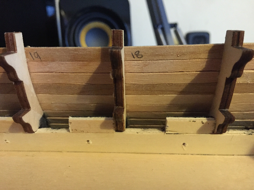

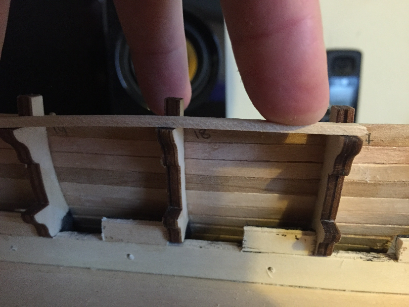

Hi Everyone!
Thank you for the rapid replies. I didn't expect to wake up to all of that advice.
I must admit I don't like the thought of unsticking the frame. Surely it would be easier to trim a bit off the top of the brackets?
I can confirm it is the same at both sides. Also it is seated properly at the bottom. The lowest deck sits fine too.
I have attached some images of the top with me holding a plank so you can hopefully see how raised up the brackets on frame 18 are. Also a picture near the false keel so you can see that it is seated properly.
I look forward to your replies :-)
Many thanks,
Neil

There's the problem right here
Somehow the side arms of the frame sit higher than the surrounding ones.

#13 Posted : 01 February 2016 10:32:12
Joined: 28/08/2015
Posts: 45
Points: 138
I've just double checked it and your right. It does sit higher. But it confuses me why the bottom of the frame sits flush with the bottom of the keel.
Any way at least we've established it is a problem and now I need to work out the best way to correct it.
Is it best to cut the tops of the frames below the lower bracket and shorten them? Or just trim the tops of the brackets down?
Thank you for your support :-)
Neil
