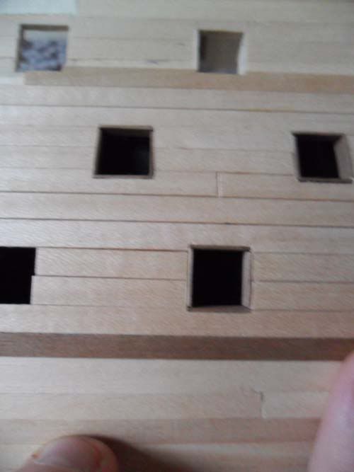

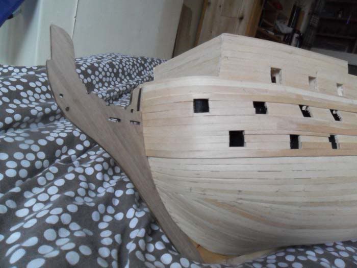

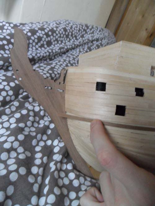

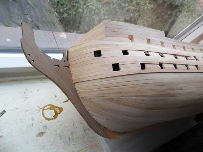

Anyway, I have committed (a little too much) time to my model over the festive period and thought I should share some pictures of it with you all. I do not have a build diary so I thought some one-off photos now and then are fine in the 'general discussion' section!
Firstly, here is my completed launch:

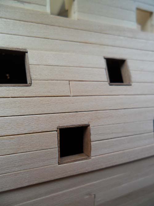

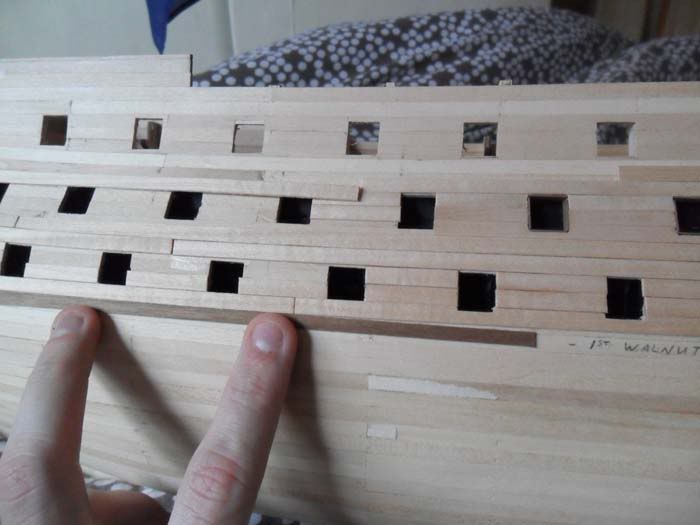

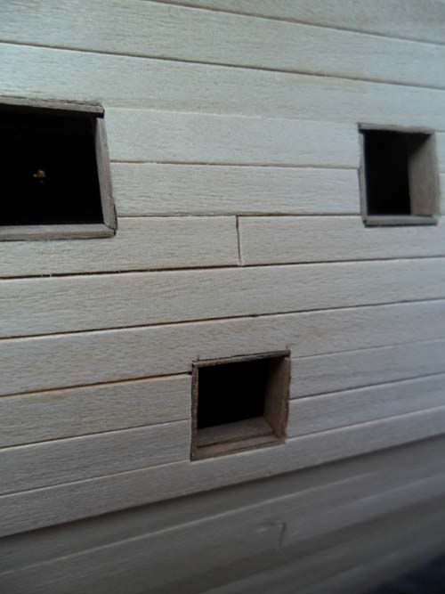

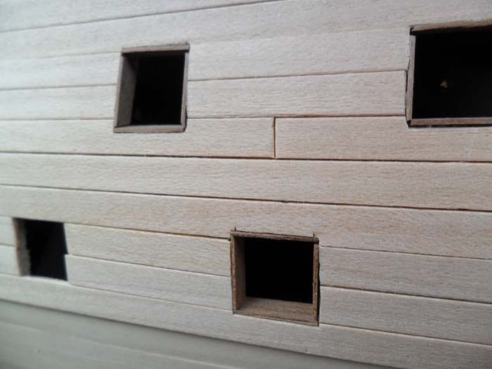

As some of you may remember, I had from the outset decided to double-plank my model, with lime for the upper half and walnut for the lower deck. A number of reasons influenced my decision; I had seen my old mans bounty model which was built in this way, and was very happy with it, I was a little apprehensive at getting the first layer perfect as this is my first wooden build, and also I was set on a walnut finish for the bottom hull (which would compliment my intention of walnut-lined gunports. With the main planking complete I added some of the veneer to see how it looked, and lined some of the gunports. I am intending to add a second layer that will be set back slightly in order to achieve a step for where the lid would sit. This can be seen in the lower gunport of one of the pictures:
This is the intended look when I begin the walnut veneer for the lower hull (my plans for completion over Christmas were scuppered when I heard of CMB 'out-of-action' until 10th January!).
The hull looks very rough-and-ready at the moment with rows of veneer half-finished etc. The port frames need a tidy up which will be achieved with the second framing later on.

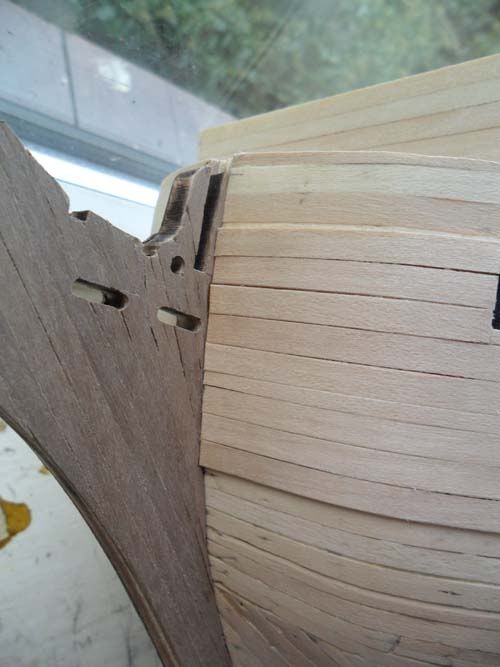

Finally, my attention was turned to the keel; the supplied one not really suitable in my opinion for a natural finish (and not entirely matching the walnut on the hull), so I endeavored to veneer that also, which when sanded and later oiled, looks like a solid piece - if you veneer it carefully it is very hard to see the joints!
Thats about it for the Christmas break I think! Overall I am very pleased with it, and looking forward to tackling the inside of the gallery (I was inspired by the Surprise build link which someone posted on here over the summer).

Wow!! Your build is looking damn exceptional Tom...keep the pictures coming mate...ThumpUp

Paul - the lime veneer is 1 x 5, think I just ordered about 30 strips or so. I think there will be enough but if not I'll just get a few extra. I have ordered 65 1x4 walnut for the lower hull to finish sometime in the future.
The gunports are 0.5 x 4 walnut, with the same for the second layer of lining when I get round to it!
Cheers,
Tom

I used loctite superglue. However, the original hull was varnished and then lightly sanded with wet&dry which makes it nice and hard, and also provides a smooth surface for the glue to adhere to - I think it would have difficulty attaching to bare wood.
All the best!
Tom
