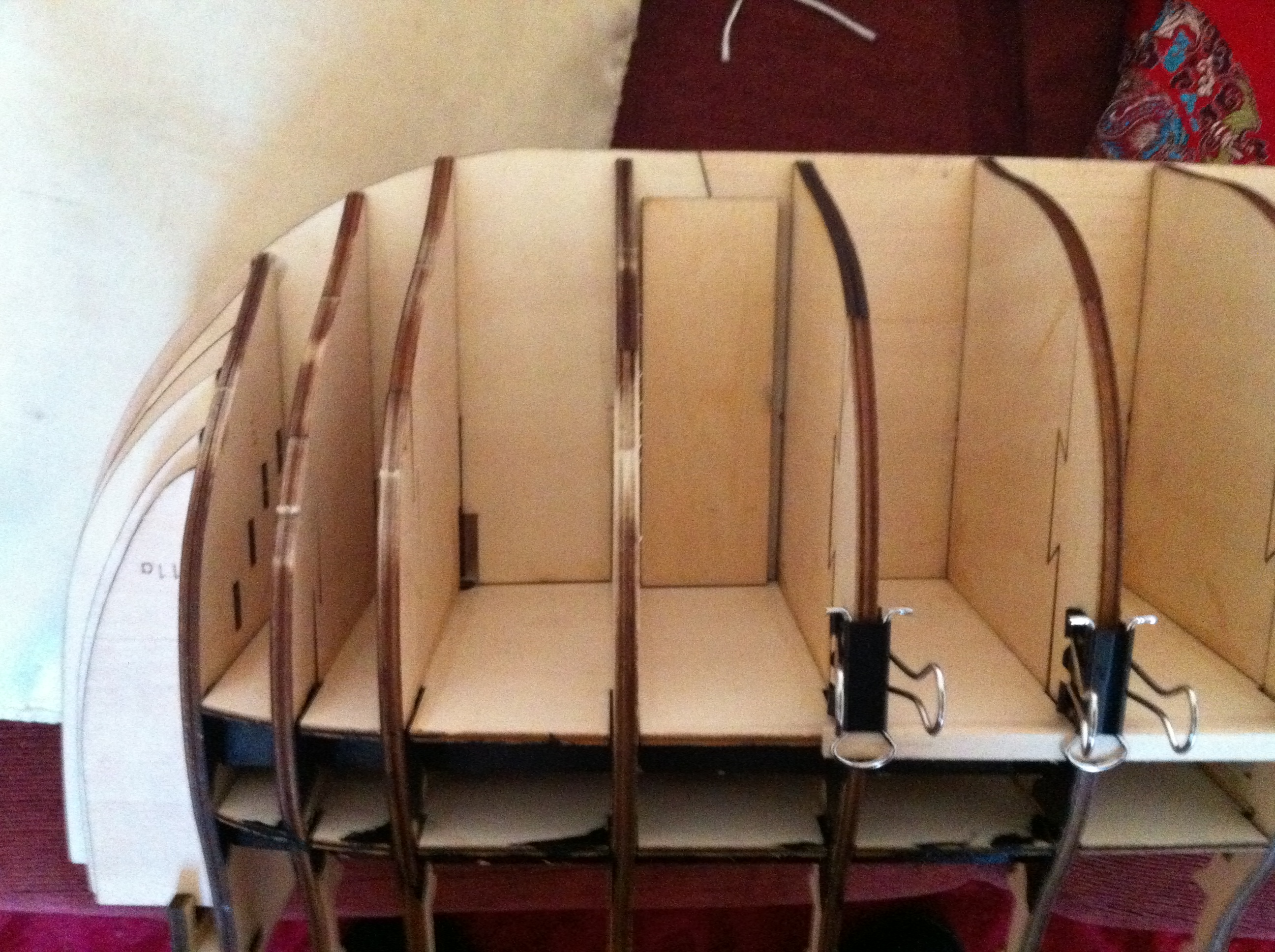

ive searched to find out what is wrong with rib 15 mine is wider was told to search furum cant find a direct answer to what ive got to do with it how can i fix it if i dont no what it supossed to look like in the first place please help

ive just looked at my ship rib 15 to short rib 16 bit short aswell do build it up to the false keel the same shape as it is now if you get what i mean seriuosly thinking using this for nov 5th driving me nuts all i want to do is get planking but as u can see above im newbie not happy paying 720 quid for a kit i have to mod my self not happy chap
#8 Posted : 04 January 2011 12:19:01
I've not seen any problems with frame 16, can you post a photo of your build as its out of the ordinary to consider building up the false keel.

up to the actual keel i mean tomick one sec ill do pic

Points: 47
here is the pic ignore the bull clips was checking if they was big enuff

hi..i had that on the same rib as you plus another 3..i just packed them out upto the keel and sanded to the shape of the rib ..paul

what did u use to pack um so basiclly i pack um up with some strips of wood leave over night to dry and then do the fairing. rib 15 i now i got to shape but i brought a mouse sander for xams orsom kit

#13 Posted : 04 January 2011 13:17:33
Yes, pack the frame edge so that when a plank is laid across it runs smoothly without dip or bump from frame to frame, and in turn any frames that are slightly high should be faired.
if u havnt got to far in your build could you show me a pic please
hi sorry mate no pics..but if the rib is low run a spare plank up the edge of the rib glue it and when dry sand it to the shape and height u need it to be..but run a plank over your ribs and mark where it needs packing or fairing..i used different thickness planks depending on the gap u need to fill...good luck paul
