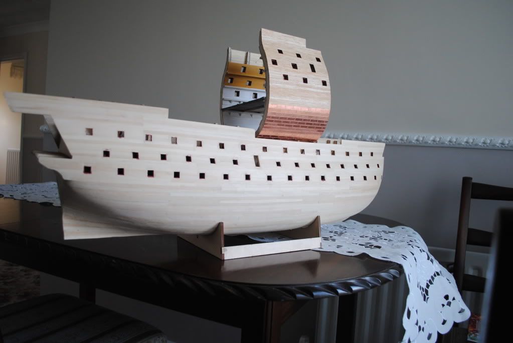

As promised here's some snaps of work so far on the 'cross section' I'm building allongside the main model. I've coppied the dimentions from our kit so it's like the front and back have been saw'n off. the length of the cross section is greater than bought versions, this is mainly so I can get the mast rigging more like the actual model (ratlines etc), it means more internal work but I think it will be worth it, there's only one deck made so far, my next job will be re-creating the other decks, these will be removeable (sliding in & out) until the detail is done then fixed from bottom to top.
As you can see the planks (vineer) are barely disernable, so that needs sorting before doing main model, the copper plates are from 'Cornwall MB'(about £2 per 100) and it took well over two packs, that works out about 15 packs for the actual model (although I did use some 'artistic lisence' by tiling from lower than the waterline) it will probably take 20 packs for pure accuracy.
The glues used are as mentioned above and recomended by Karl.
I'd like to think we'll get some discount off DeAg for their copper plates but I wont hold my breath!!
TTFN
Jeff
