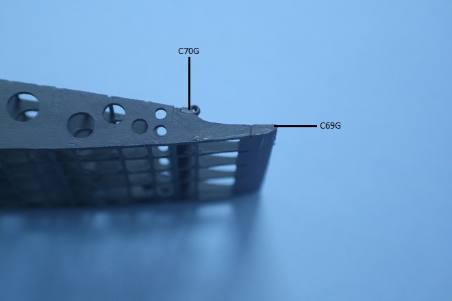

Take pieces C69G and C70G. Use sandpaper to remove any irregularities and burrs that may have been caused by the stamping process, then apply primer.
Prepare cladding piece A7L as in step 12, following the same procedure used for cladding the rest of the aircraft. Do not glue the piece in place yet.
Paint green the pieces prepared in step 11 and the part of the underside of piece A7L indicated in the picture by the red line, preferably with an airbrush.
Insert and glue piece C69G and C70G as shown in the photograph.
Here is the side view of pieces C69G and C70G fitted in their correct positions.
