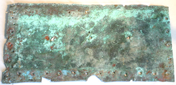

I shall be painting mine, but a question for you shipmates...I will be painting the lower hull, not coppering it...could anybody give me any idea as to what colour weathered copper would actually look like????
Blink
#13 Posted : 08 February 2011 17:53:19
An actual tile from Victory shown below, verdigris effect paint can be purchased via a number of sources which is applied in stages, the same can also be done to copper tiling using verdigris effect fluid, which is a cold patination solution.

Just to add to what Tomick has provided. I guess the copper sheet from Victory was in an advanced state of corrosian and had been taken off to be replaced.
These two photos are from my collection of HMS Trincomalee photos
The first shows the coppering just after the restoration of the ship about 11 years ago. The second shows how the verdegris has affected the ship when she is floating in the 'dry dock' and was taken last summer.
