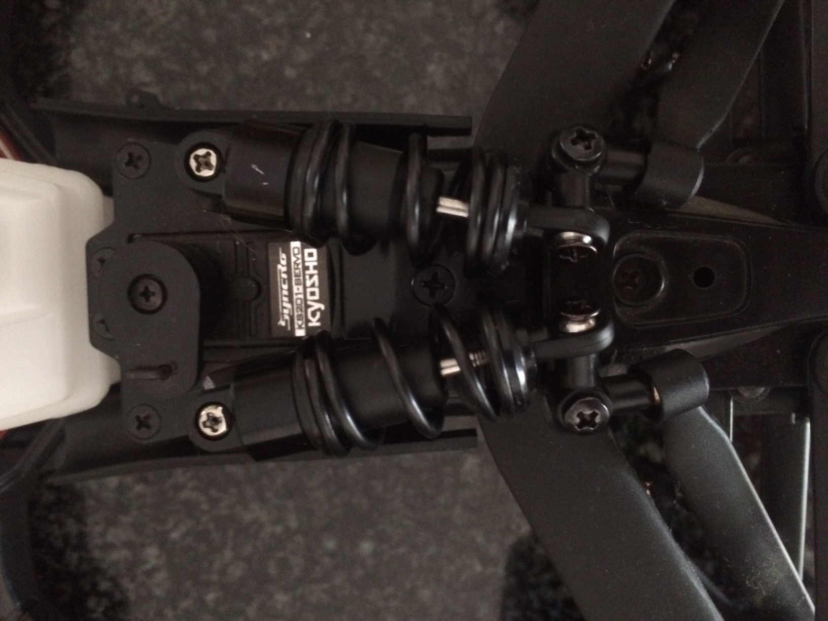

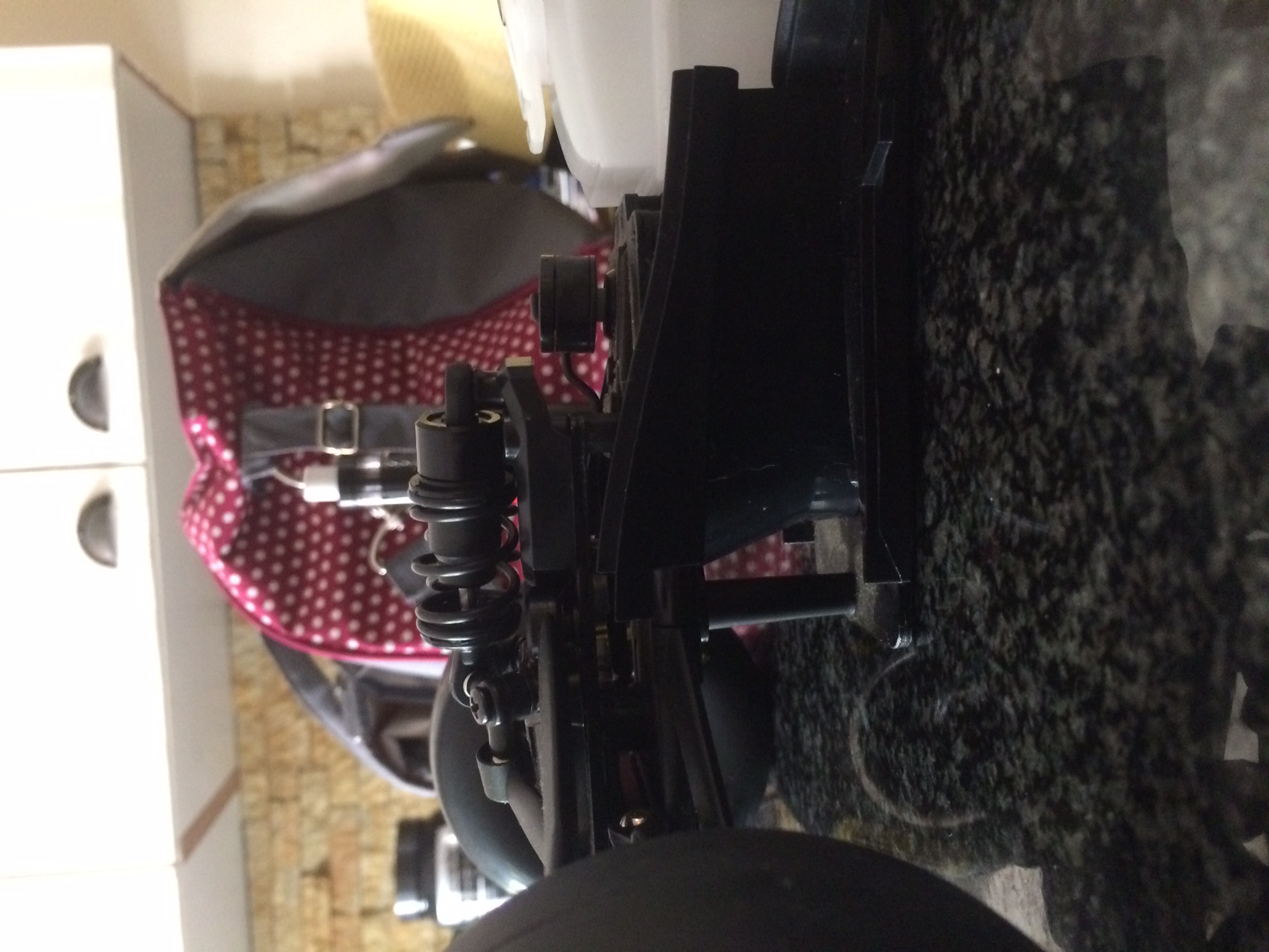

Can anybody assist
The rear ride height is 10mm but the front is less than 1mm
Ive taking the front apart and rebuilt it but its still the same.
Please see pics

I read on here that somebodys L brackets ( not sure of the correct term) where too tight and not allowing free moment of the suspension.
Also there looks like an lot of extra threads still showing on your shock assembly, is the distance set to 8mm?
Yes it is, I'm tightened the L brackets and that seems to be working, so opposite of what has been said works
