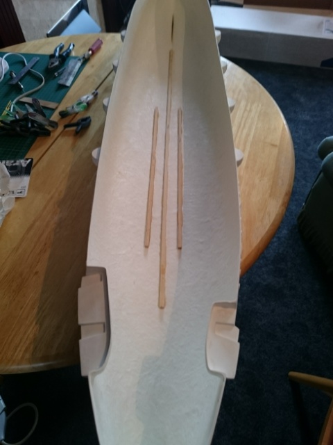

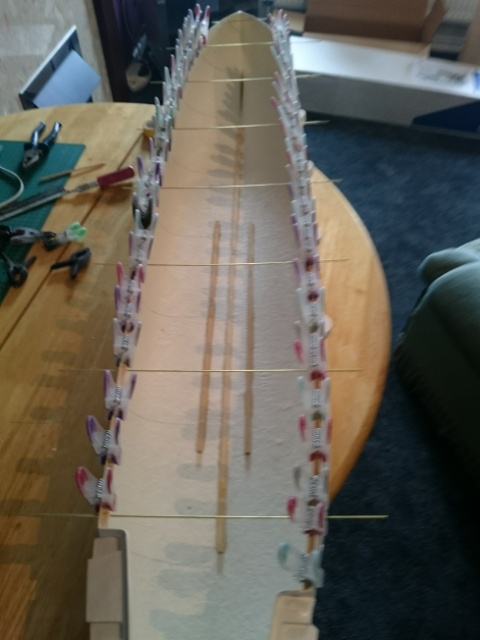

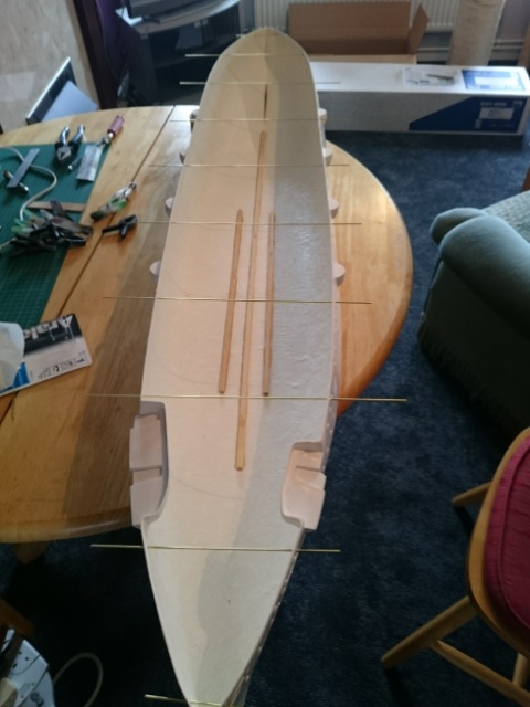

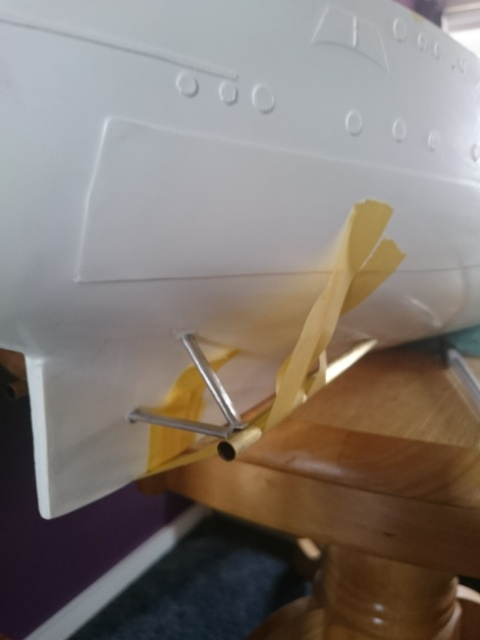

Hi all get me build diary up an running on this one.first steps are to sand the top of the hull down to its correct level, then sand seam off bottom.then it's add 3 stiffeners to Hull bottom.drill out holes in Hull to take temporary brass rods, which are there to aid putting the deck support strips around inside edge of Hull. First 2 glued in.that's it for now.cheers mick.

I`ve got some of those pegs for clamps, they are real good as they have soft pads where they clamp the parts together, but it looks like you may cause a national shortage. LOL

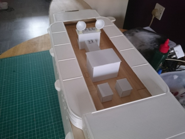

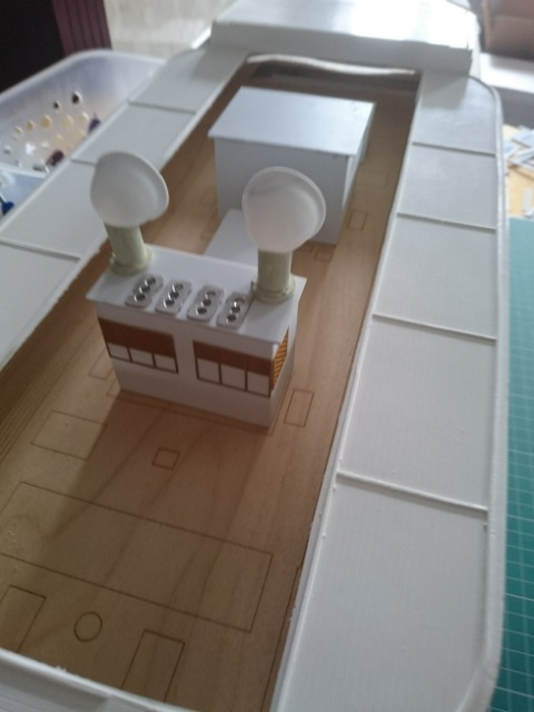

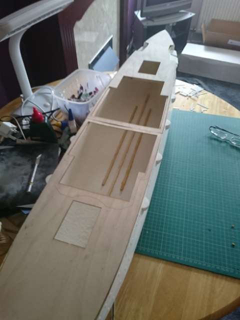

Hi thanks to all that left comments, much appreciated. Anyhow between decorating flat.and sorting new model space out.I managed to get bit more done.glued the A frames in to support prop shafts.finished off deck supports.cut deck out.it fits where it touches.p38 will sort that out.cut the rectangular hole out in main superstructure. And made start on the bits in well area.the one with few fittings on is generator room.which I drilled holes through skylights.as intend to light up the ship.others are funnel housing.and to small ventilation intakes. The fittings do require a lot of cleanup.don't know how gonna model the big grey lump amidships on the drawing yet (big grin.ain't kitty cats help full eh.
