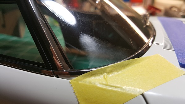

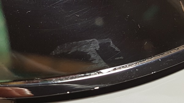

So as I was trying to put the driver side windshield wiper on my Toyota when I fumbled it and got a smear of CA glue on the clear plastic marring the finish. I was lucky and the plastic didn't craze too much. So how do you remedy this unsightly problem? Most of you pros already know how to do this but for those that don't here are the steps to fix this unsightly mistake.
First off, I put some tape near where I was going to sand to protect the chrome trim from getting damaged. I then wet sanded the DRIED CA glue with varying grades of sand paper. Wet sanding is best in this instance because it lubricates the plastic and sandpaper so it isn't so harsh. I started with 1800 grit and ended with 4000 grit. Make sure you get all of the glue off. If you still have some glue present just redo the procedure until all the glue is removed. I then took a dab of Arm and Hammer toothpaste and polished the area. This toothpaste has baking soda in it and helps with the polishing phase. This is how it looked after the sanding and polishing was complete. You will notice that the finish is still hazy... no worries we will address this issue next...

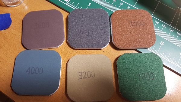

These are the sanding pads I used. They are manufactured by Revell/Monogram and have the different grades printed on them. This was a 6 pack I purchased from my local hobby store. If you want an even better finish they make higher grades up to 12000 grit but these higher ones must be purchased separately.
