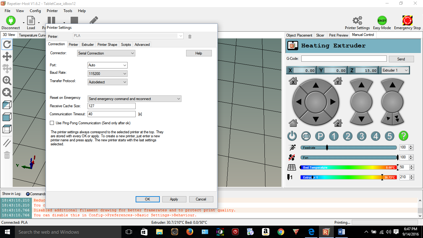

Just finished building the Idbox and have gone through setup and calibration, manual testing etc. Works fine manually, triple checked all settings yet after slicing with Cura the printer never receives a start signal to heat up the extruder and start printing. Tried the tip(s) on the U.K. folder and still have same problem.
I am running Windows 10 instead of the 7 or 8 mentioned in the magazine instructions. Any ideas?

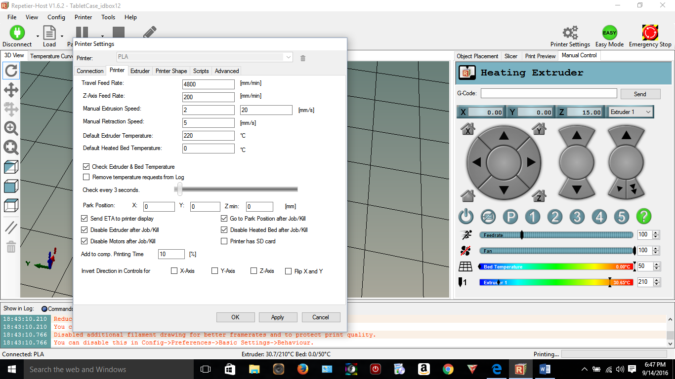

#2 Posted : 14 September 2016 21:04:02
Have you set the heated bed settings to zero in the Repetitor program as the program will wait until that gets to temp before the head heats up.
The settings can be found on the top right 'printer settings' then click on the printer tab to adjust.
Many of the newer print downloads automatically set a heated bed figure by default so always check that it is set at zero.

Confused Thank you for the quick response, however still doing the same thing. Extruder calling for heat but will not heat up to start the process. Also once you click the "print" button and the manual screen pops up the bed temperature graph still has fifty degrees listed. I have to manually change it to zero. Now the bed icon has a red line through it but still will not run..

Sounds like you may have switched off the heater by mistake, in printer settings at the top are 6 bars with figures, The default extruder temp should be set at the correct temp for the filament you are using the bottom box of the top six called the default heated bed temp should be set at 0

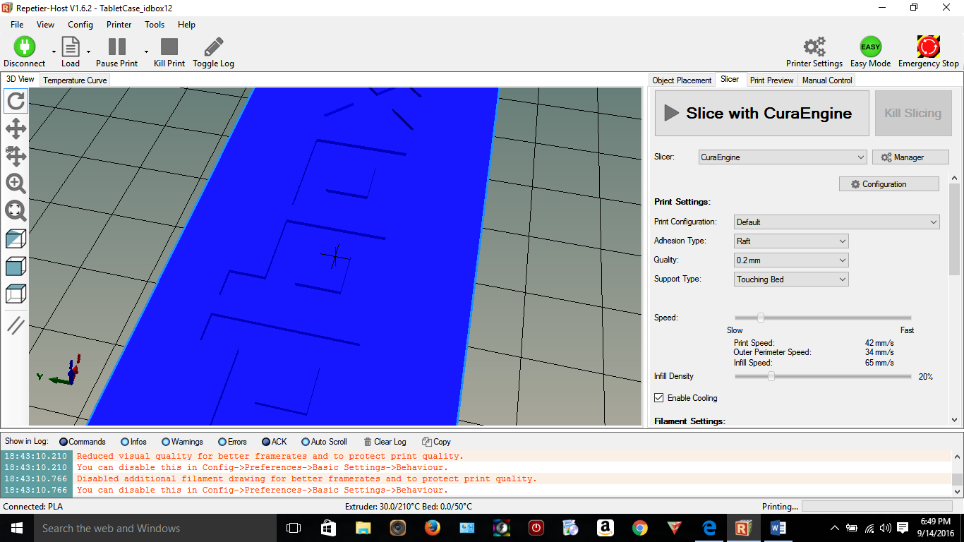

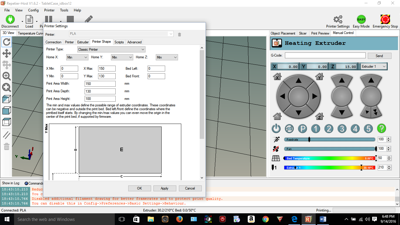

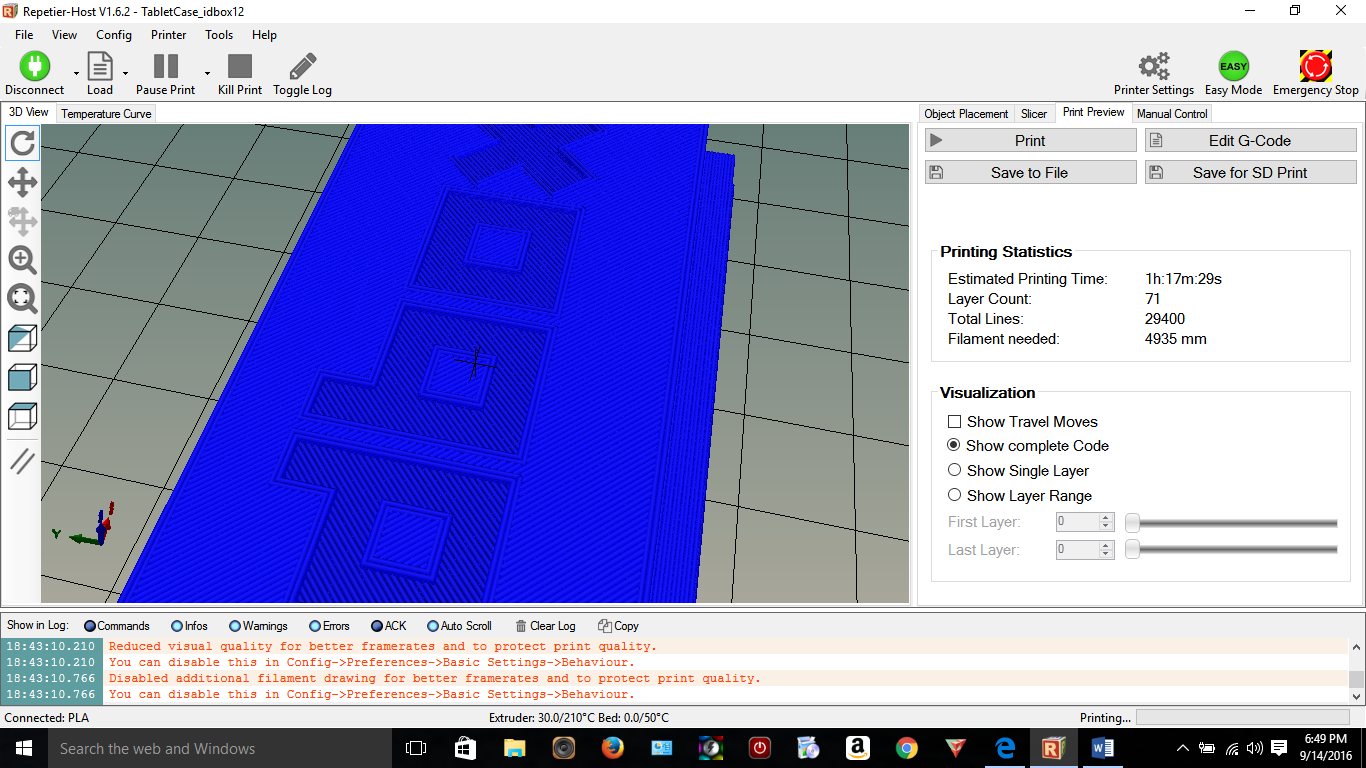

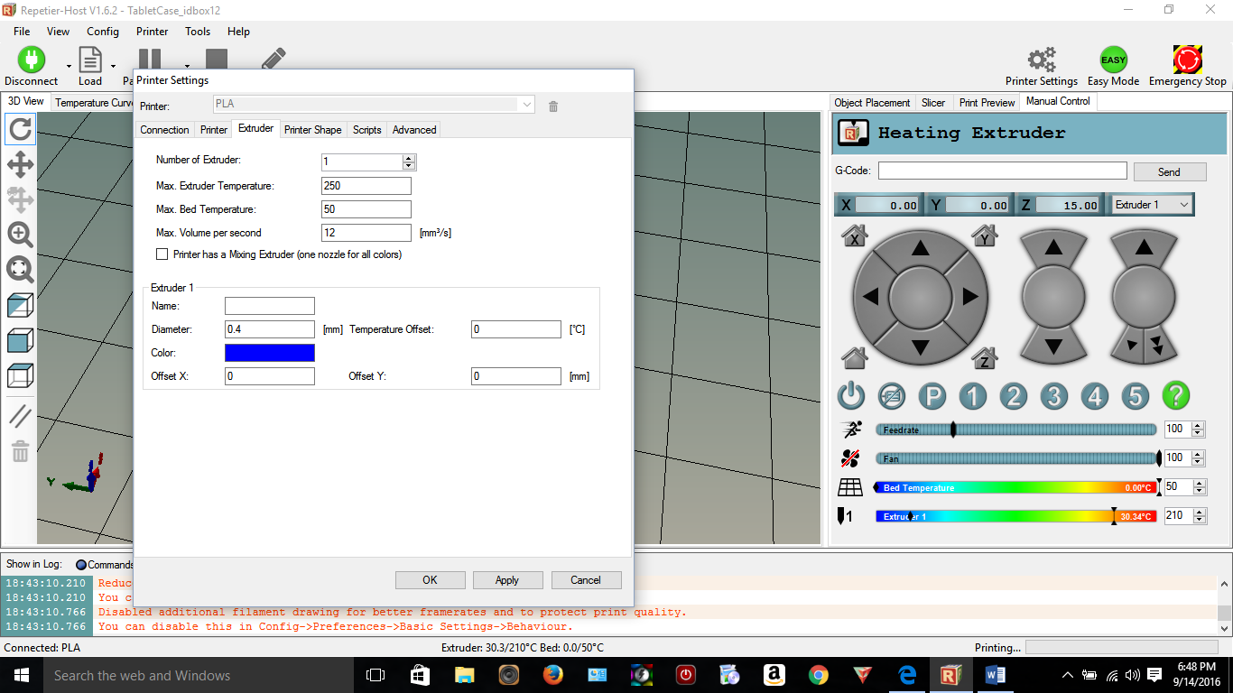

I checked thermistor, it's good and it heats up manually. checked other suggestions and believe I have them right. One thing I don't understand is why it sets "Z" at 15 all of the time unless that's the start until the extruder comes up to temp and then it increases until near touching when printing starts.
My tired eyes might be missing an obvious mistake! I have attempted to included screen shots of settings..
Thank you for everyones assistance
