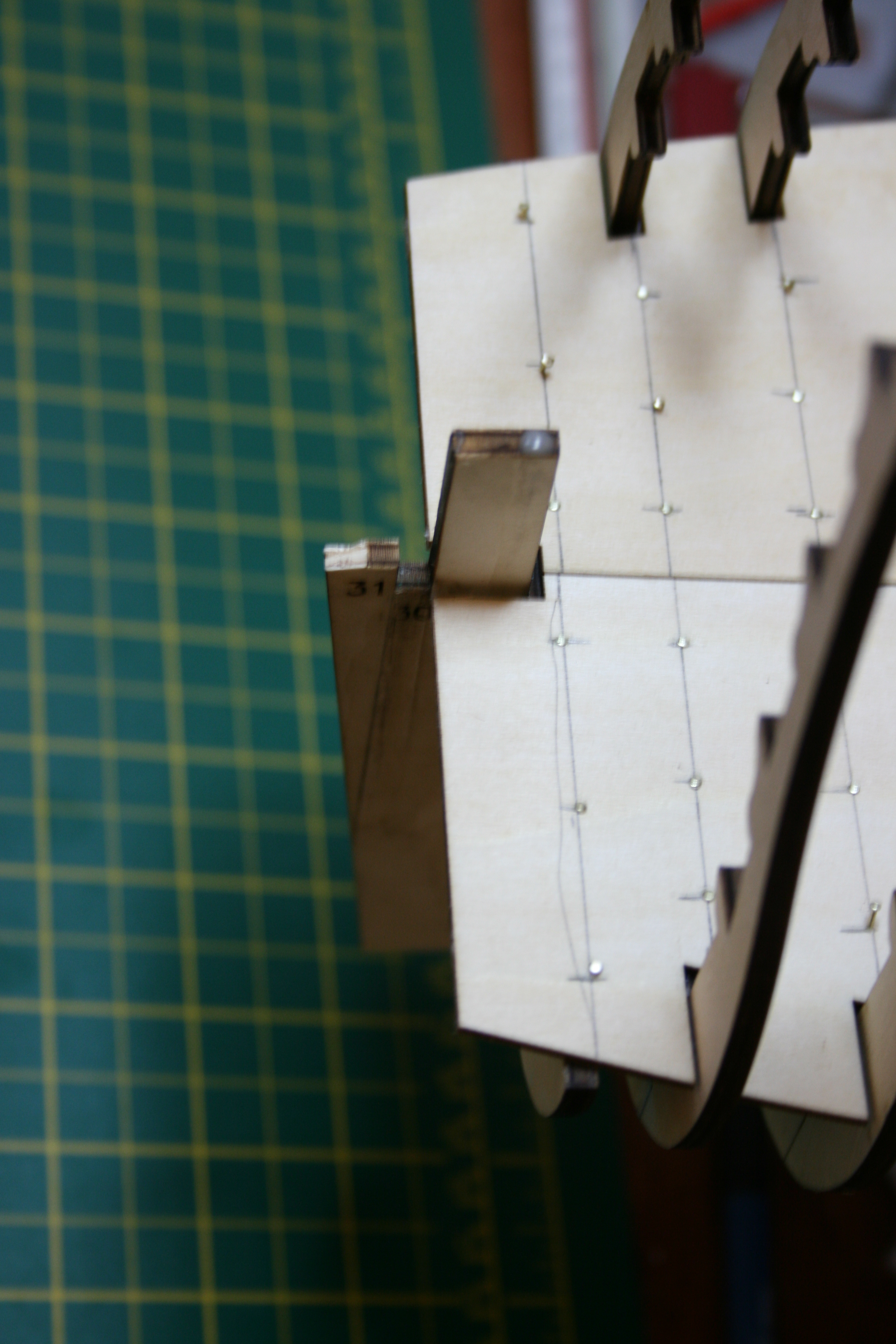

I've just finished the first 6 rows of planking..starting at the correct position. The planks are all of equal width BUT according to all the illustrations, they should now be level with the TOP of the Galley Supports.
BUT... they are about TWO planks lower??
When i put the supports in I made sure they were completely pushed down.
Do I just extend the next TWO layers or what???
Help!? Confused

The bad news is part 31 has court the top of the keel instead of going down it's slot so you will need to remove the planks then remove rib 31 and refit it at the correct place. If you have used PVA glue you can soak the stern in water to soften the glue, the points of rib 30 & 31 are almost line when 31 is in the correct place if you have issue 18 go to page 12 step 10 shows how the stern ribs look or go to Tomick Official Build link is below:-
http://forum.model-space...s&m=11580#post11580
benny

i agree with son of bulwark also 34 needs to be sanded flush with the keel see the same link as darron put on his post and scroll down..you seem to have a bulge which needs to be flattened

Just to ditto both of the above Crying

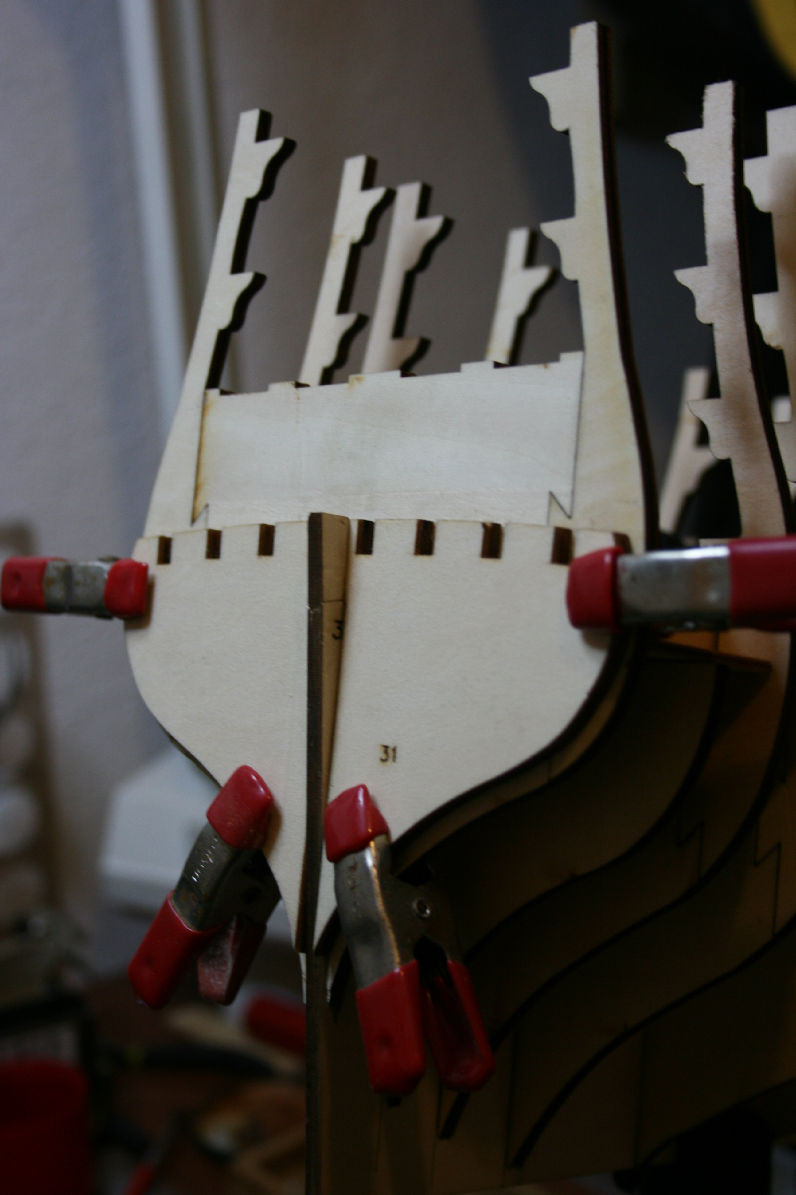

Thanks to all who have come to my rescue,especially Son of Bulwark, with his simple explanation. I hope i can soak this off without doing too much damage elsewhere.
Crying
I think i know how this happened... somehow here in south Africa, the issue that should have carried part 31 ( the galley frame to which all the supports attach) was not included and a duplicate of part 30 was inside in its stead. I see from previous threads, others in South Africa also had this problem.
In my haste to continue the build, instead of waiting for DeAgostini's local agents to sort it out, which they eventually did, i decided to carry on with the fairing and planking, thinking icould add this later.. with these dreadfull consequences, which i now hope i can rectify later in the week if i can make some time.

I do have it sorted now.
Last night i ran a basin of water, as suggested by Bulwark, and did turn her Ladyship upside down, without sinking her or any lives being lost.
I put her in up to frame 30/31 and left her overnight.
In the morning these slid out easily.
I then put all out in the sun (which we have plenty of down here generally) to dry out.
This evening i tried to re-fit frame 31, but she still would not slide down!!!
I looked carefully and then noticed that the gap on the cut-out for her to slide into was "too narrow". Out with ye old knife and i pared the wood off this and presto! She slid into place.
I have now begun re-fairing the back of the hull to accomodate this new position.
Confused
Just ONE other question:
I notice that the keel is flush at the top, but about 5mm 'in' at the bottom.
Does this matter??? Does it need to be flush all the way down??
Thanks again.

Son of Bulwark
#10 Posted : 05 April 2011 00:54:18
Hi benni!Cool
The transom needs to be flush with the false keel, yours is flush at the top so you need to sand the rest so it is flush all the way down the keel. There should be no gap, the ribs shouldn't go past the keel so match the angle of the keel, you will find that you have removed most of the thickness of transom ribs at the bottom.

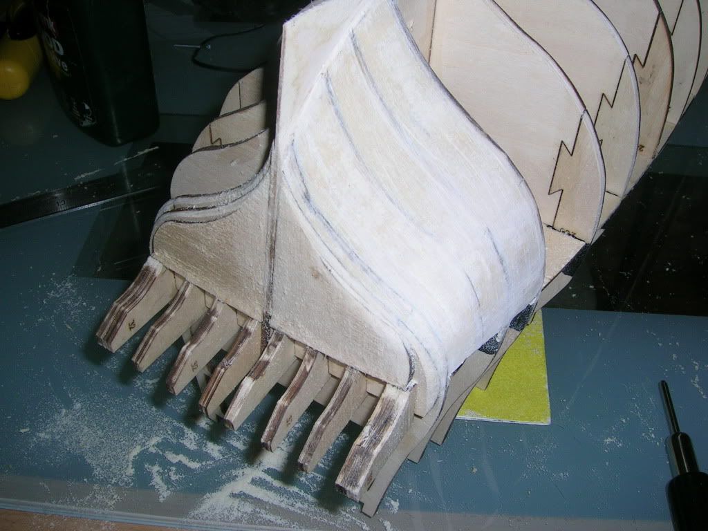

benny
#11 Posted : 05 April 2011 07:33:04
Joined: 25/04/2010
Posts: 748
Points: 2,285
Location: bognor regis
hi..like this
cheers benny

Blushing Looks like there's still some work ahead...some heavy sanding. Actually to speed it up i am using a file. I WILL get it flush!!!

hi it will be quicker with a rasp
cheers benny
